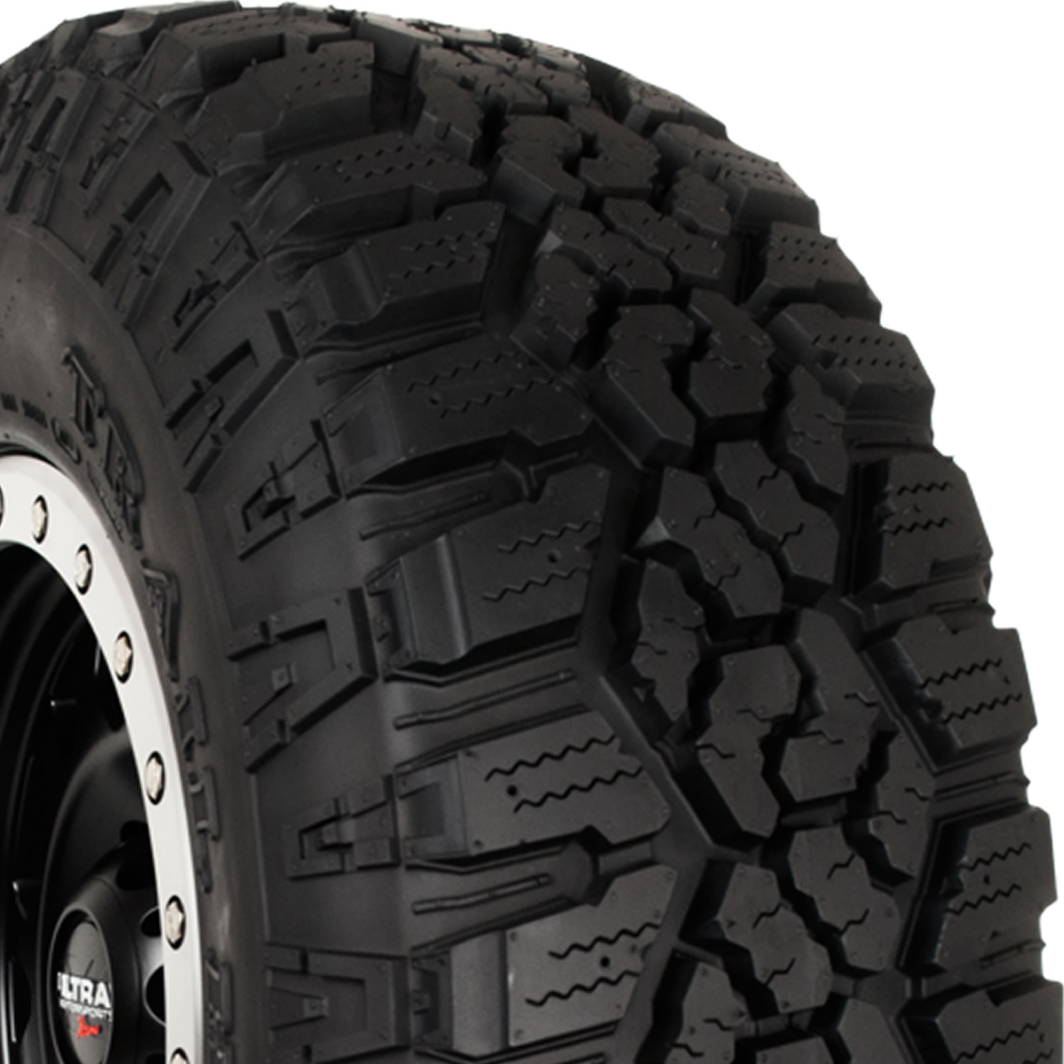

Looking to lift my 2011 Suburban using the 3.5 RC with new uppers along with
Kanati Trail Hog LT275/60R20. I'm thinking of using the stock wheels which I believe is a pos 31 or 32 offset can't remember. Will running the stock wheels create a problem, or should I get a wheel with a pos 18 offset.
Really don't want wheels and tires to hang out much from the fender and would like to no have to cut anything if possible.
