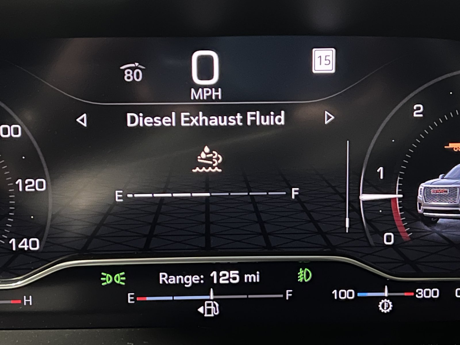

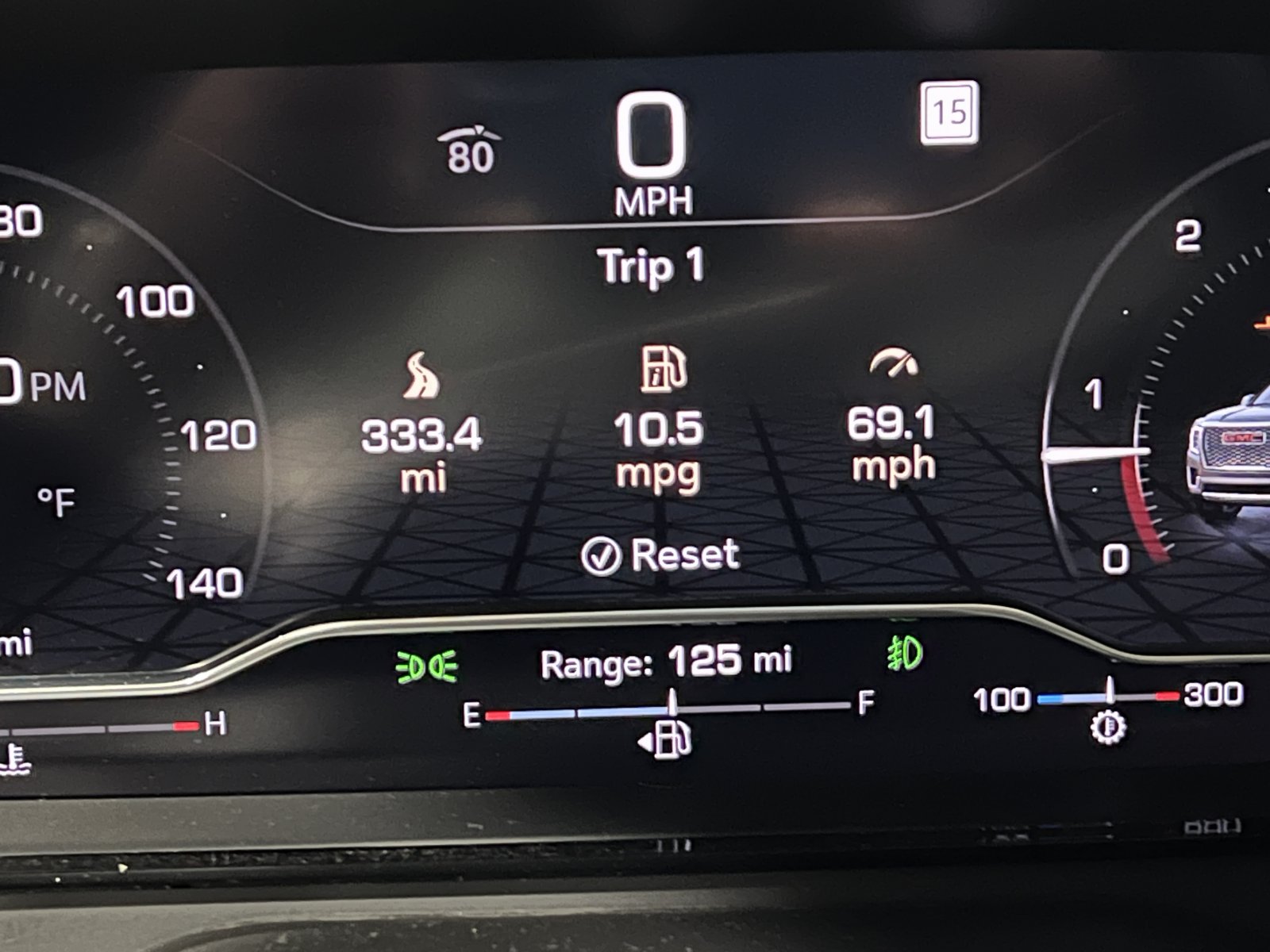

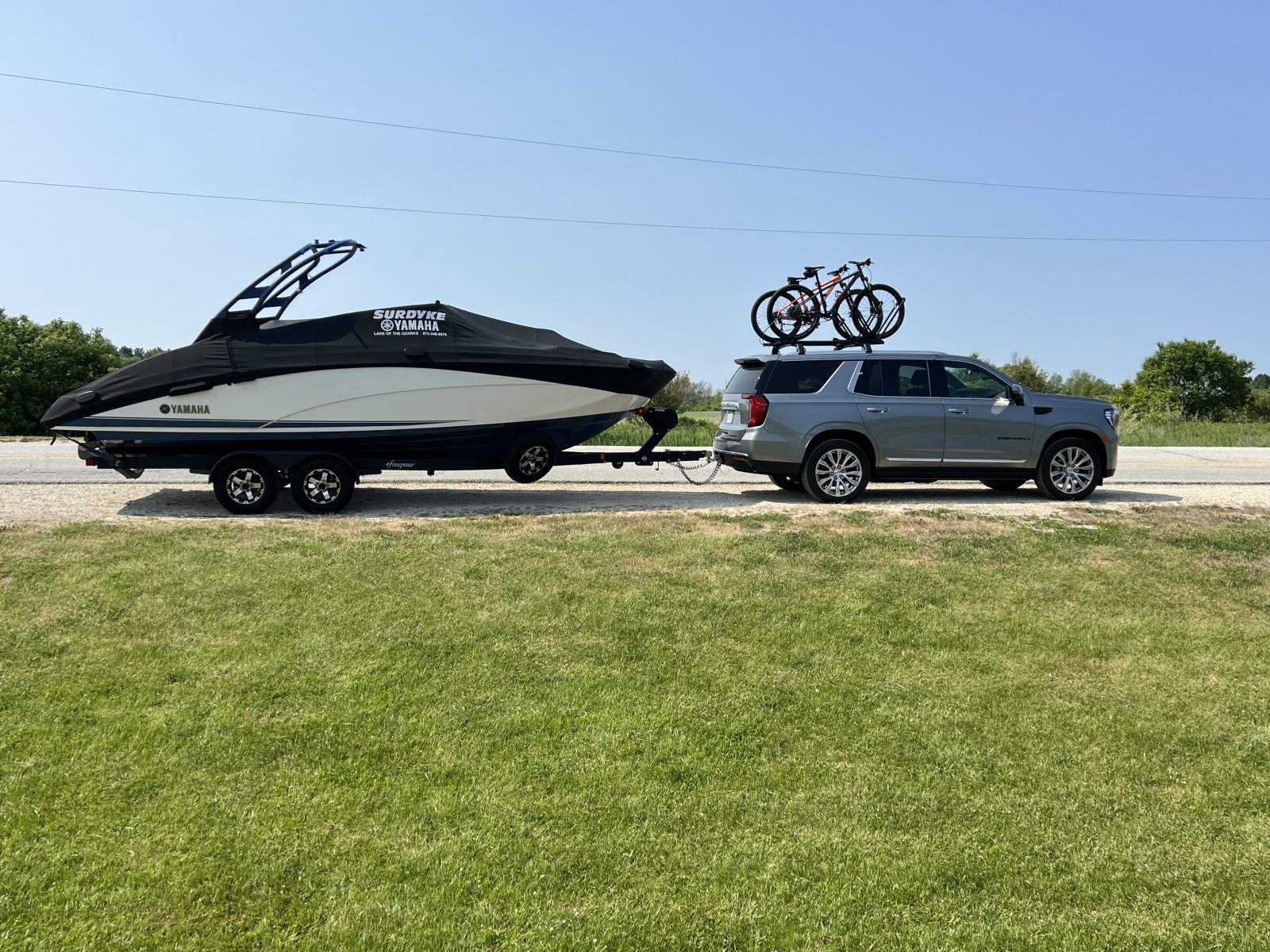

Just did 580 miles from St. Louis to north of Green Bay Wisconsin. 2023 Denali with max tow and air suspension. Pulling my 5200 lbs boat. Had cruise set at 80 mph the entire way, one hand on the wheel. Not a single issue of any sort, not a sway, nothing, even blowing by 18 wheelers. This thing tows like a dream. Like the boat wasn’t back there. Pic is from last night when we stopped; I think we averaged about 10.5 mpg at 80. Today we did 82 for about 3 hours as well.
We did go through a half a tank of DEF though at 333 miles. That was surprising. I had topped it off before we left. I had the same experience today at 82 mph for 3 hours (not a full half tank, but a lot!)
Nice! Yeah we blow through the DEF when we tow. Learned the hard way when the system suddenly told me I was critically low in the middle of no where LOL luckily we found a gas station that carried it fairly quickly.

I checked the oil; no loss at all over 1200 miles of towing.
DEF was crazy: gauge showed 50% and then 10 minutes later we got the “132 miles left” warning. I took it down too .4 gallons in the DEF tank. Plan on getting fuel at truck stops if possible while towing, as they have DEF “on draft” as my GF says.
This was exactly our experience. On longer trips we now bring a few boxes of DEF just in case!
