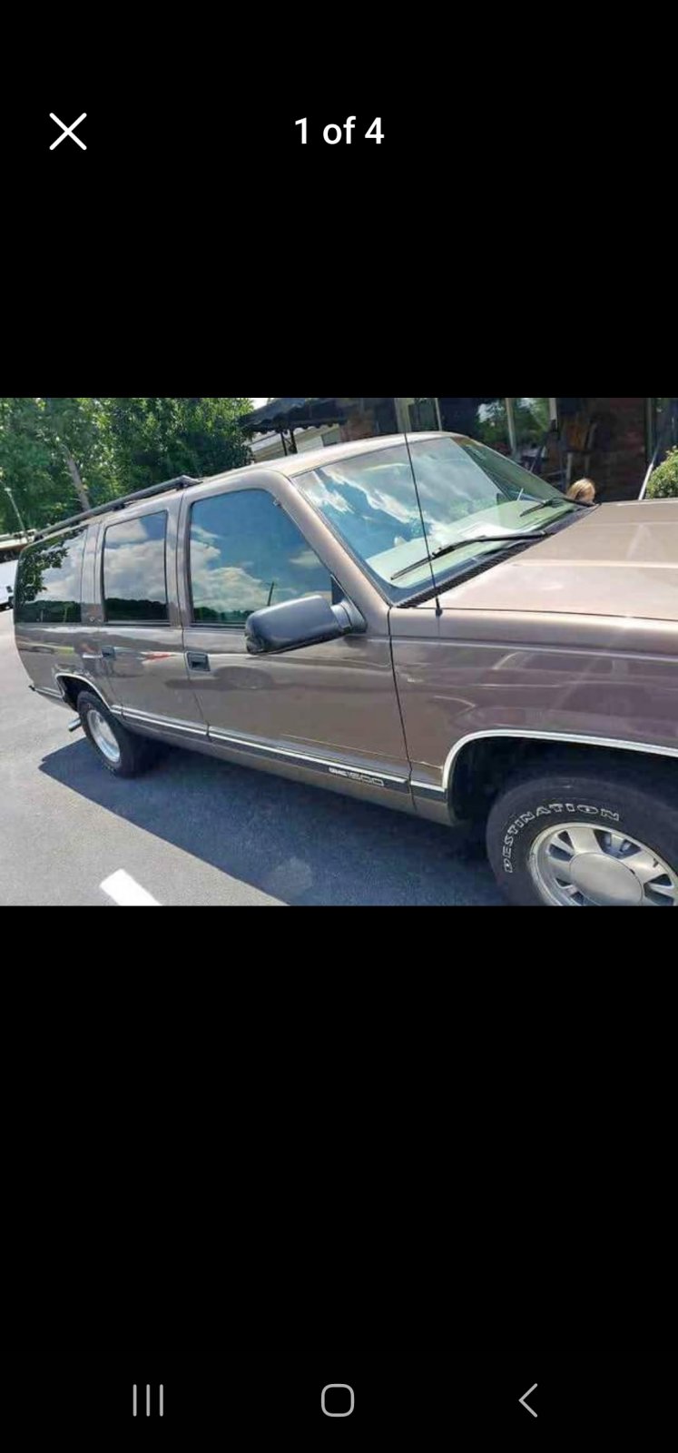

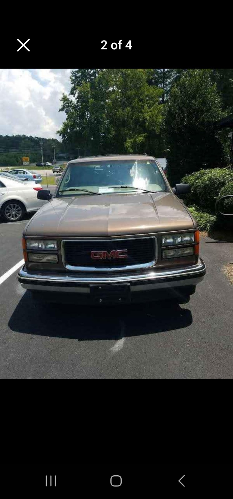

I've just found an ultra clean 96 Sub 2wd. I'm buying it, but in order to use it here in the winter, it has to have 4wd. My question is, would it be a bolt on conversion, or would there be mounting tabs and such missing from the frame. I'm aware of all the hardware requirements, I believe. IE gear ratios, transfer case, half shafta, spindles, driveshafts, cross members, tcase shift mechanism. It's a 5.7 LT GMC. The wrenching isn't an issue as I'll be doing it myself. I already have a good manual transfer case and shifter, front diff, axles, and spindles. If the push button shifter is electric rather than electronic, I'd prefer that.
Thanks in advance for any information
Jim
