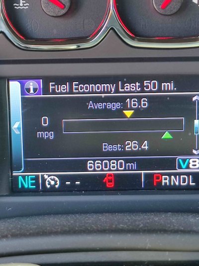

This is 2WD. Over 50 miles I've been able to achieve 26.4mph as a best. People are usually astounded to hear that I average 22-23mpg highway mileage driving such a large vehicle with a v8.
I've been able to match it 2x's with headers, a CAI, and BBP tune. My average has dropped quite a bit recently because I just got the truck back..... with a Whipple installed so I am earning smiles per gallon at the moment
