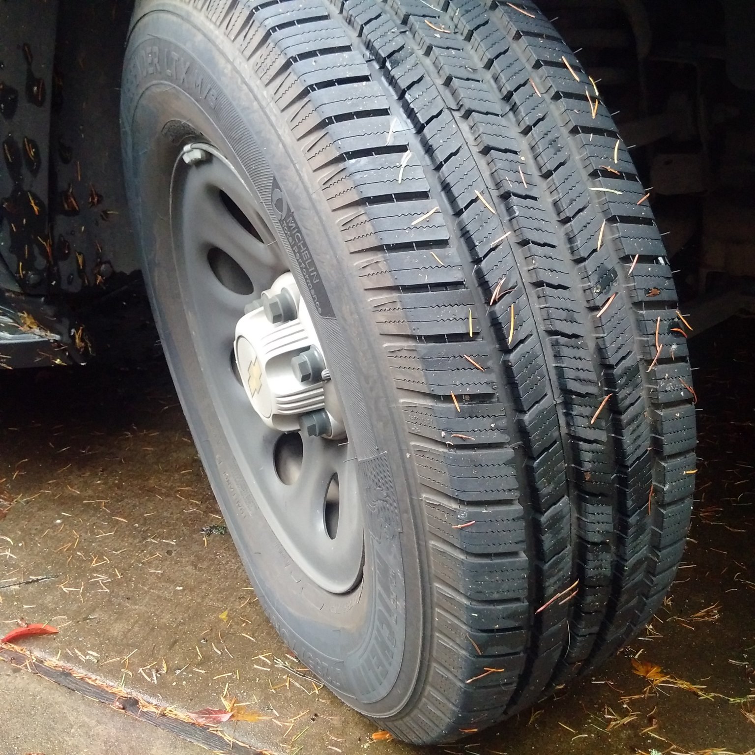

The stock 265's aren't exactly small or incapable tires. Just depends what kind of tire you buy. A standard street/Hwy tread design will be worthless off road or in snow. Going with an AT or load range "E" tire instead will definitely get you places. I decided to go with the Michelin Defender Load range E on mine. I run 60psi in them. They are awesome. No, they won't get through six feet of mud but you've got to know your limitations (sometimes). But that's why God made chains and winches.

As far as your inflation, always go with the OEM recommended inflation from the sticker on the door jamb. If you are running load range E tires, check what the tire manufacturer recommends. I run 60 PSI on my Michelin Defenders load range E's. And yes, the more PSI you put in the tires, the harder they will ride. Tires are the first line of suspension on a vehicle. They affect your ride quality, absolutely. Standard load range tires will also bulge in the center if they are over inflated, resulting in premature wear in the center of the tire and increased hydroplaning potential. Under inflated tires will wear evenly on both outer edges. The danger with under inflated tires is excessive heat build up.
