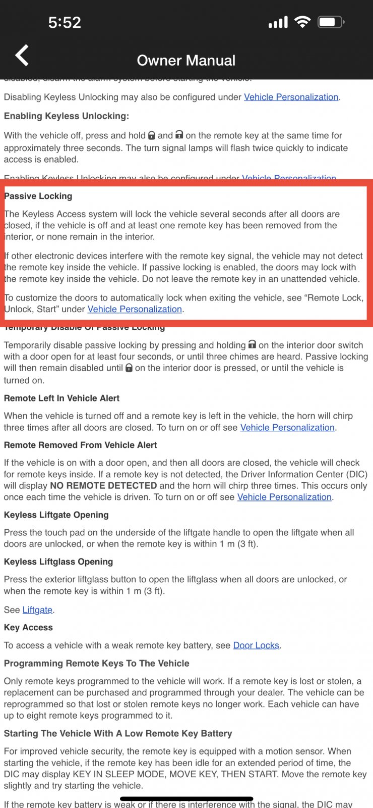

Do you have “Passive Locking” enabled in the Vehicle settings?
Excerpt from the owners manual Door Locks section below:
