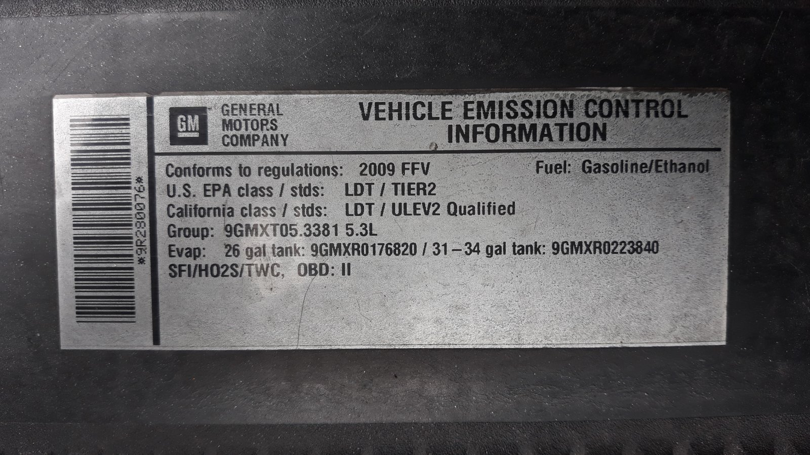

Consider asking for a photo of the underhood emissions sticker. It will say what kind of emissions standard the vehicle was built to and include the VIN.
In the photo below from under the hood of my old truck, the last eight digits of the VIN are on the left and the Group number tells you what the emissions standard is, which in my case are California as my vehicle was delivered to a dealer in Pennsylvania and that state used and may still use California emissions standards.
