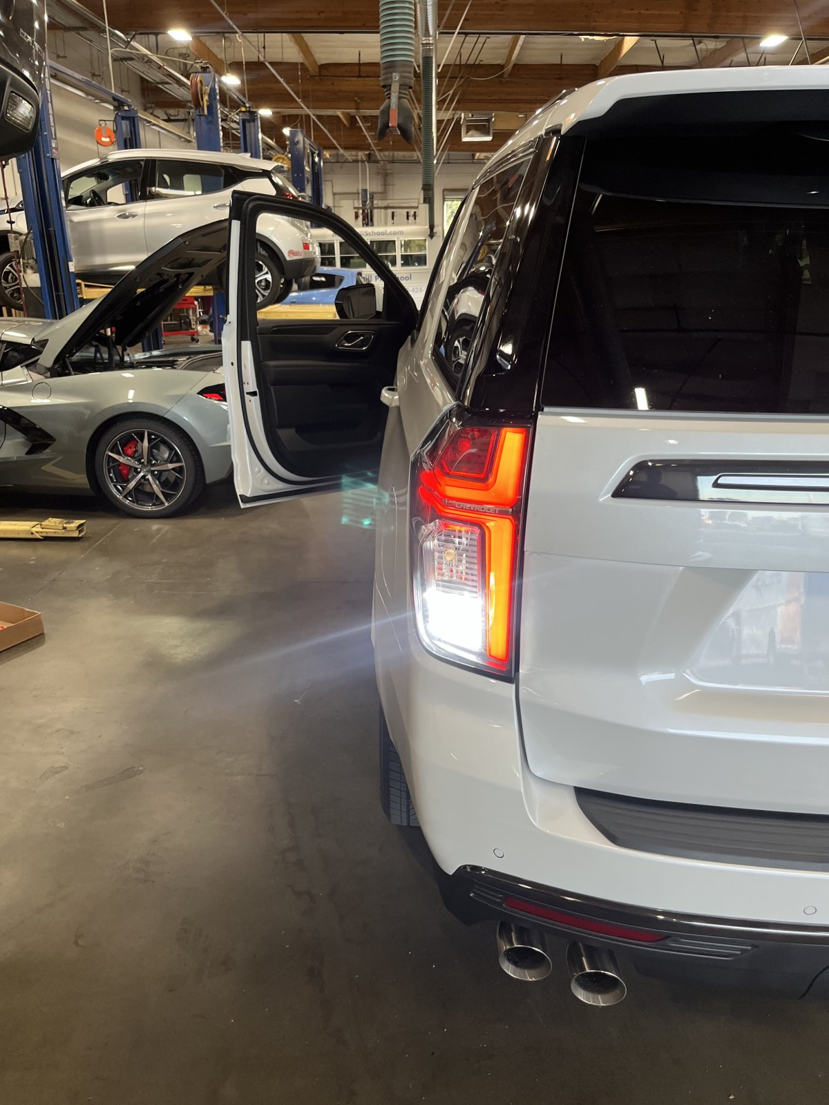

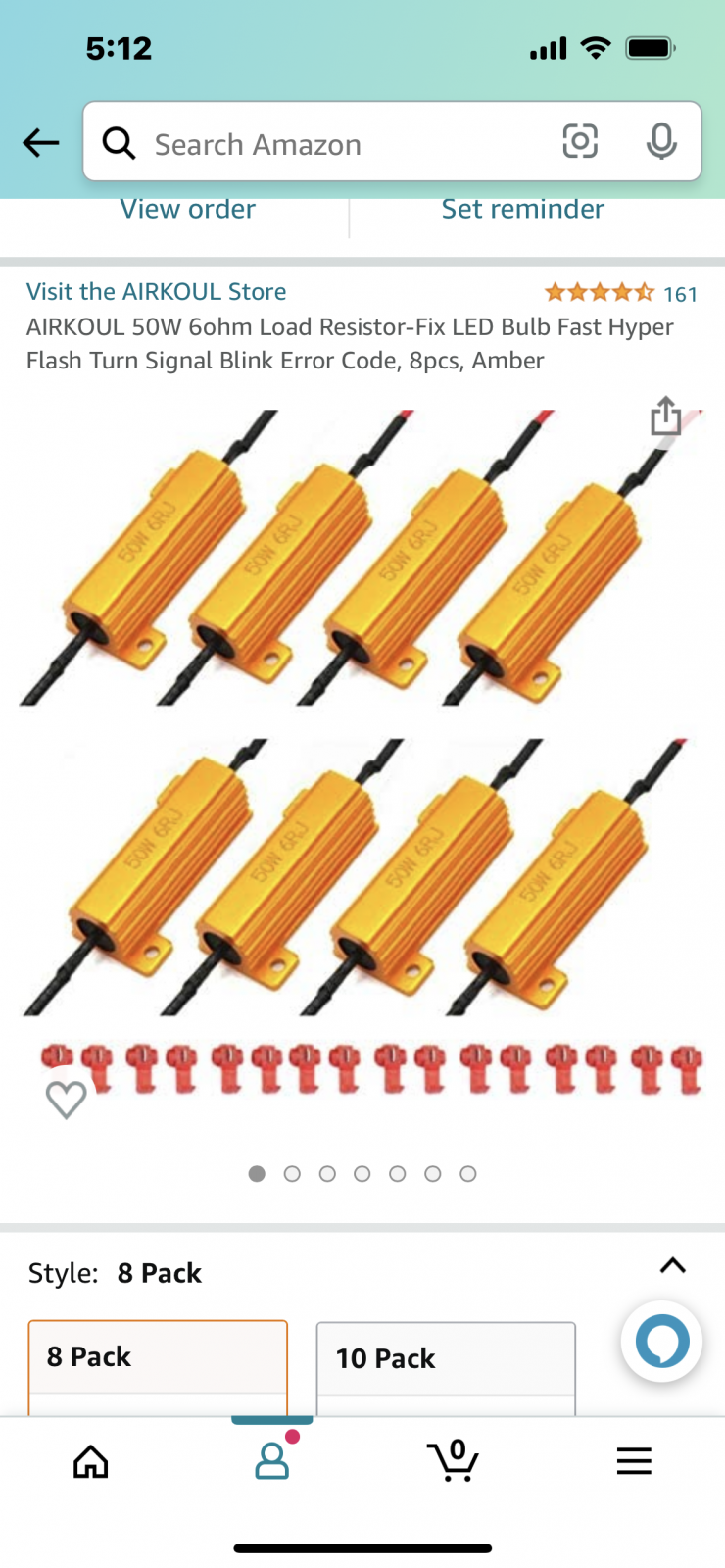

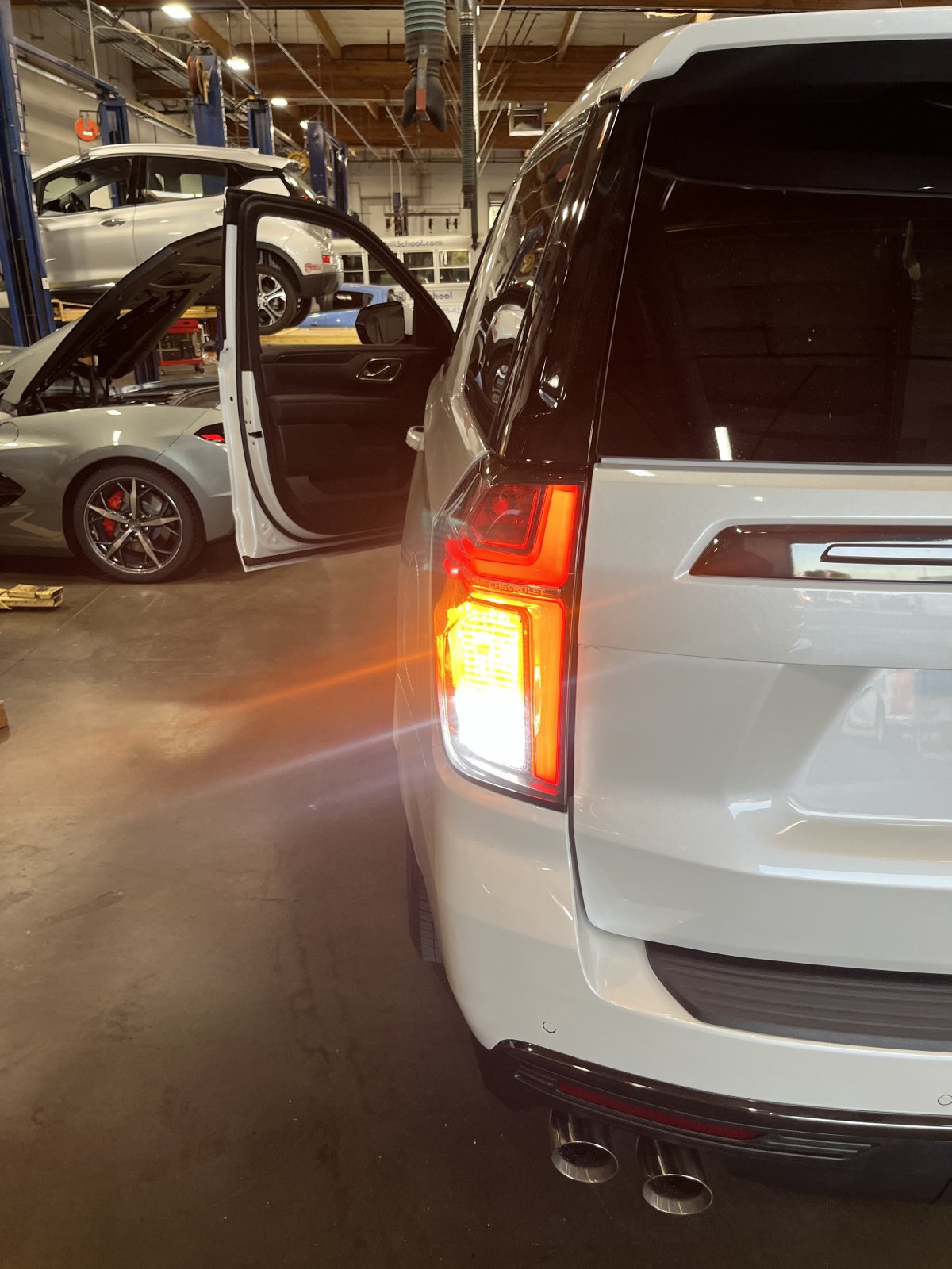

I have done brake, turn and reverse light bulbs. Put a resistor on all 6 and have had no issue or messages on dash. Bright as hell!!

I installed a resistor to both sides. I tried one side first and got error message.

What size resistor did you use? That could be why you needed two. I tested one on each side and it was too much. There is a video on YouTube of a guy placing resistors behind the tail lamps but they looked smaller than the ones I tested.

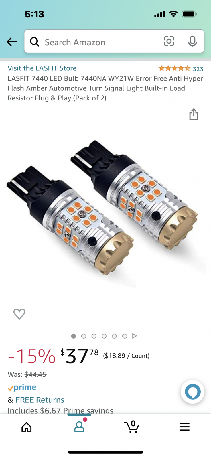

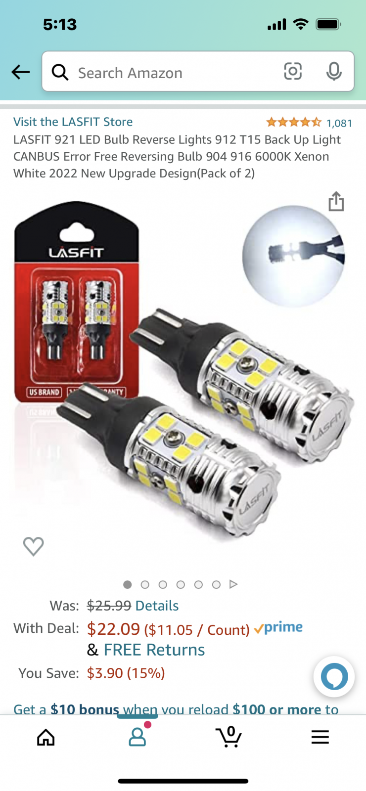

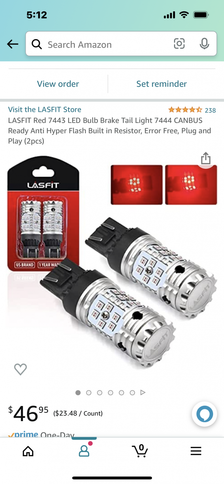

We bought a new 23 Tahoe RST this year. Finding it truly mind blowing that with the price tag and other technology advances in these vehicles, that Chevy shortchanged buyers with incandescent bulbs in the rear reverse and turn signals. Why??? Was there some load issue with the rest of the vehicle? Would be nice if we could get an explanation from an actual Chevy engineer or service person. It’s really a damned shame. I’ve reached out to PUTCO and they don’t have anything designed yet for a 23. I’ve also started correspondence with LASFIT and waiting on a return email. If the 23’s are the same size/fit as the 22’s, then we should be looking at 921 for reverse and 7443 7440 7444 7442 (I think) for the turn signals. Some manufacturers require a separate resistor, some do not as they are built-in.

Pretty sure the LASFIT ones do require a resistor based off what I've seen on the forum and YouTube.
