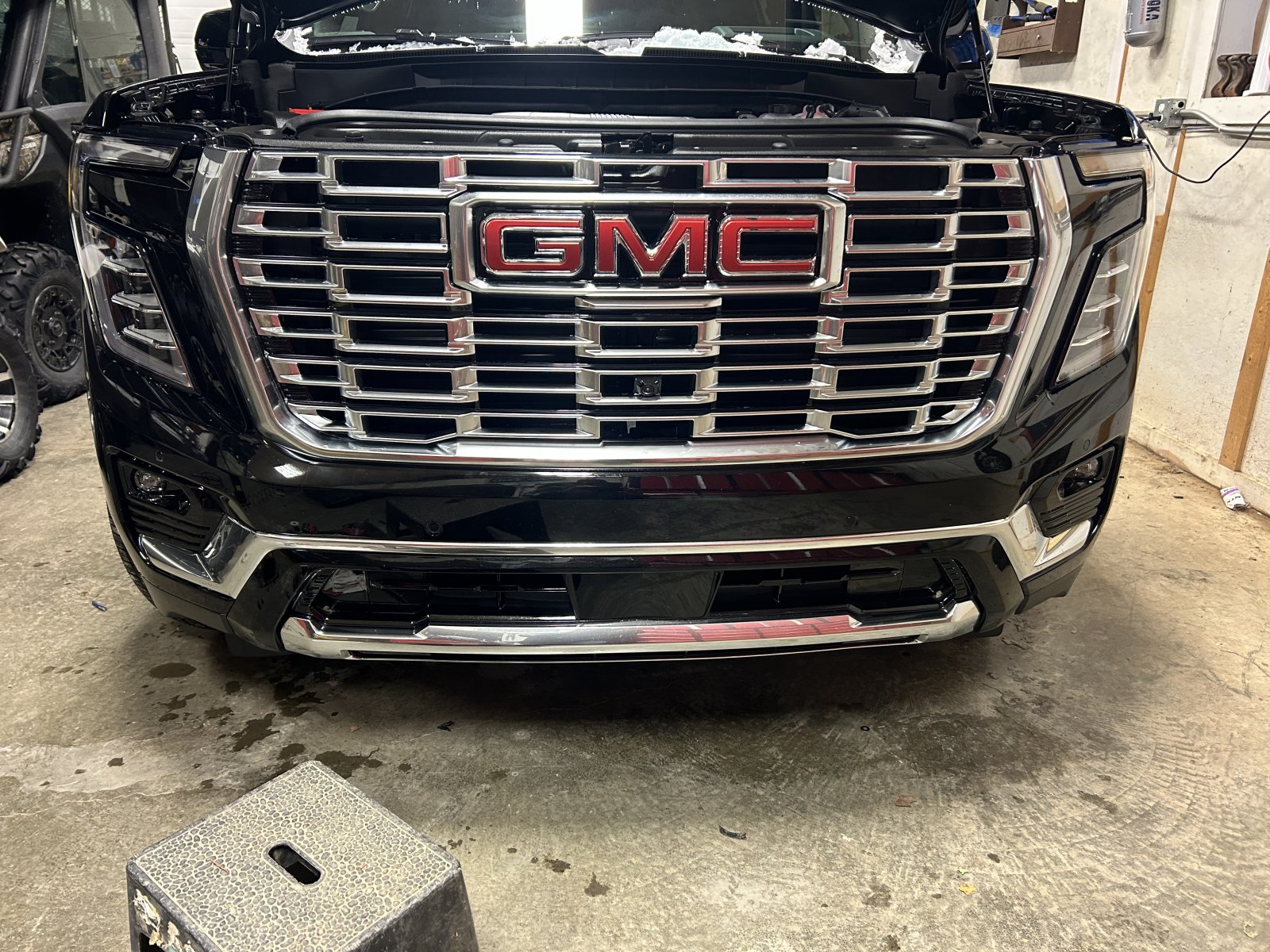

Hey Guys just picked up my new 2025 Yukon Denali. I am looking for the block heater plug in location. Any idea where it would be I found a removable panel next to the DS fog light but nothing there. I have confirmed on the build sheet it has one.

They moved it to the passenger side of the bumper beside the fog light. You have to remove the small piece in the corner to get to it.
