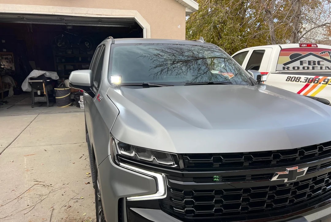

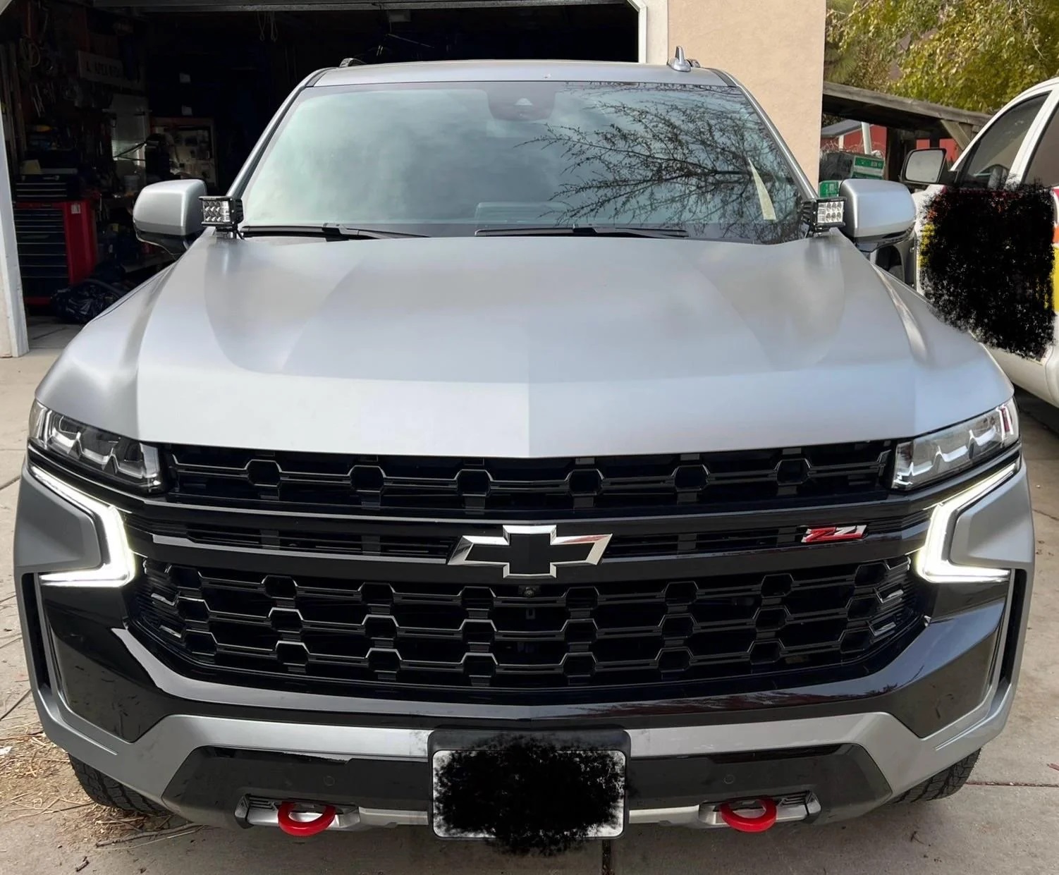

Finally got around to installing the Garmin Power Switch. Couldn't find a commercial offering for a bracket, tried to set it behind the passenger headlight but there was no way in getting my hand in the spaces to get bolts/nuts on.
So, mounted to the fuse lid (I think someone here mentioned they did that) and I think it turned out great. No clearance issues and just kept the cables dressed up neatly. And the ditch lights installed.
The Garmin is amazing. So many settings offered like strobe, dimming and combining individual lights for a single on/off.
