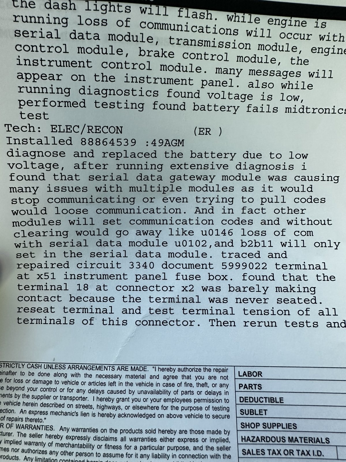

Replaced battery and a circuit? Interesting

Yea I have it back and everything seems to be working fine. It was also seemingly fine after i disconnected the battery and drove it to the dealership. Hopefully we are all good from here on out with the electrical issues.

I had something similar on a corvette. One harness connector wasn’t seated well. I had to self diagnose since the dealer couldn’t get consistent trouble codes to diagnose it. Seating it fixed it. However, later the connected wiring harness started going bad. Seems like at some point during assembly the harness must’ve got yanked out of place, and was rubbing through the wires.
