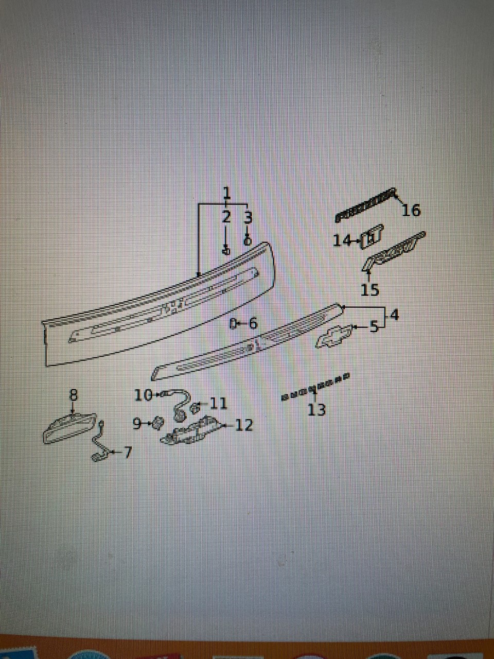

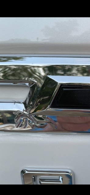

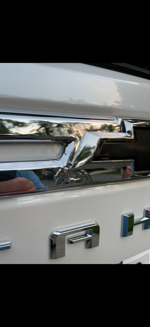

New 2022 Tahoe Premier delivered in June 2022 with a blemish on the rear chrome applique. (I waited nearly 8 months from order to delivery of the Tahoe.) The dealer ordered and subsequently mailed me a new trim piece that arrived this month (October). The dealer is 250 miles round-trip for me.
To avoid wasting a full day, cost of fuel and the dealership possibly scratching the paint during the replacement process, I thought that I would simply remove and replace the defective part. (I am no stranger to most any repair.) I believed the part could simply be lifted on the corner and manipulated off. (The part has 10 or so molded plastic push clips. I am afraid that simply pulling on the trim may damage the painted plastic base that it mounts to.) From my images, item number 4 needs to be replaced.
Short of removing the plastic interior lift-gate shell to access the rear of item number 1 to "push" out the plastic pins of item number 4, does anyone have experience with removing the applique (number 4)? Removing the lift-gate shell looks like an ordeal too, with the possibility of broken plastic.
I hate to spend 8 hours and $50.00 in fuel to swap out this part at the dealership and risk further damage to clips and paint.
Thank you! Doug

HUGE job. You have to take the inside plastic cover off then unscrew the painted piece. Once you have that off, you have to cut the tabs off of the appliqué to remove it. Snap the new appliqué to the painted piece and the new bow-tie to the appliqué and screw the assembly to the hatch and reinstall the inside plastic cover. Make sure to have special plastic tools and use painters tape to cover the painted surfaces when removing the interior plastic cover.
I watched my dealership do the job. He knew what he was doing and it took him three hours to complete. It was VERY tight to remove and reinstall the nuts on the back of the painted piece assembly.
If you are on the Southern Eastern shore of Maryland, I can vouch for a particular dealership and employee that will do the job with great care. Otherwise, Good luck. You WILL need it!
