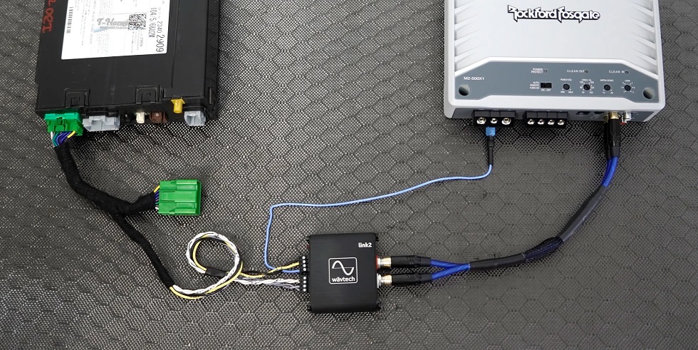

Can you send me a picture or post one? Does it T off before the amp or after? The amp kills bass as volume gets high, doesn't it? I have all the other parts, but I'm considering the L2Ci thing
kerlyb
Apr 5, 2023
60
26

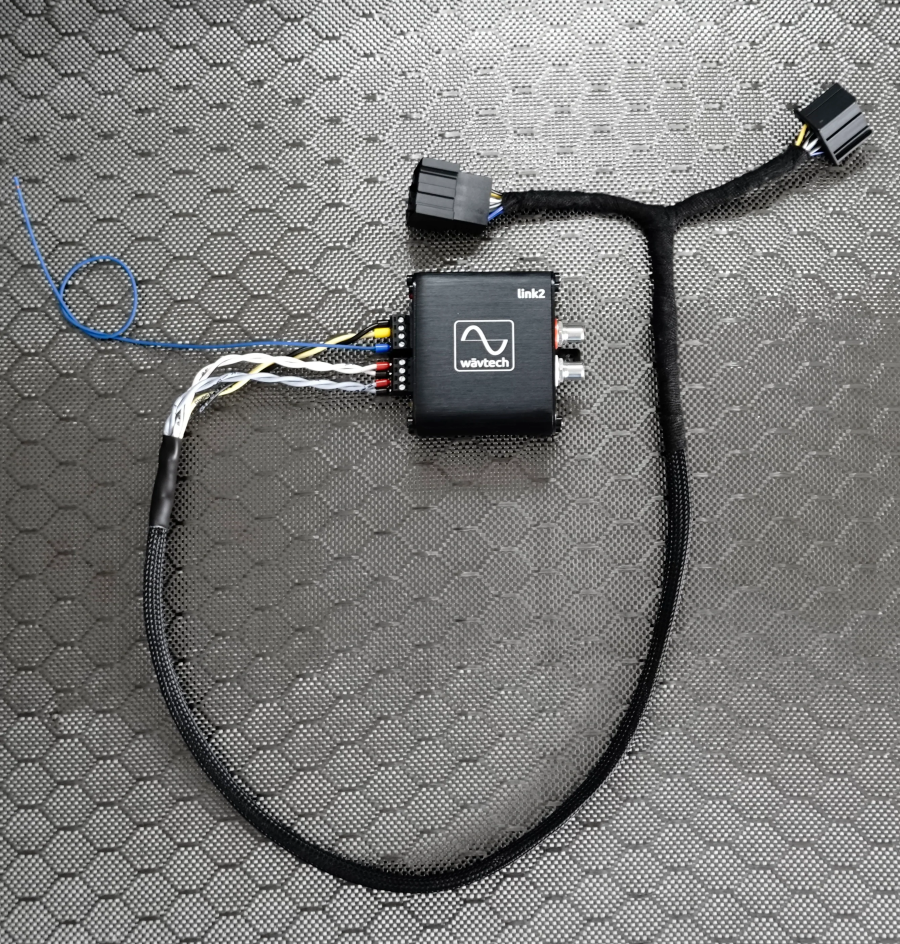

The T harness is a simple plug n play off the Bose amp. Everything is in the harness...audio signal, 12volt, and ground. Just add a LOC and ANC bypass.
I bought mine off T-harness.com...more info on their website if you want to take a look. I have extra T harness for sale if interested....they always seem to be out of stock.
For the LOC, I went with Wavtech DQ...a step above the Wavtech Link2 in the above pic. No bass roll off with higher volume.

Using T harness is as simple as it gets...plug n play. See attached pic of sample setup. T harness gets you full audio signal from front speakers AND 12V source/ground for your LOC. AudioControl or Wavtech LOC will also give you amp remote turn on signal.
I went ahead and just ordered the better LOC/harness combo from t-harness. Thanks for the advice!
