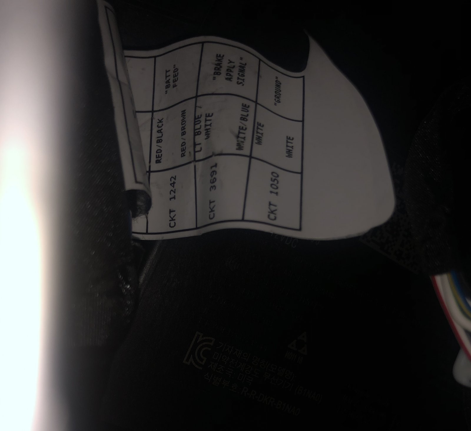

I've got the Denali Duramax Diesel and everything showed that there would be a pigtail to plug right into, but on mine there was just the 4 wires taped up. Never would have found them except I started looking for any white labels... Finally found with the wiring details and was able to pull out the wires. Anyway, I was looking for a plug/pigtail that wasn't there. Ended up wiring it up and it's been working fine, but plug and play would have saved me a few hours.

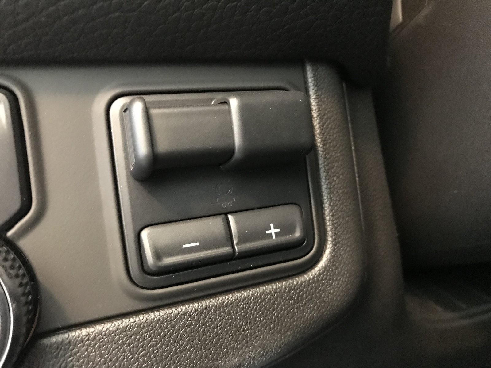

If your vehicle was equipped with the Max Trailering Package, it will have an integrated brake controller on the dash as pictured above ^, 2 speed transfer case (HIGH 4WD and LOW 4WD), Hitch guidance and hitch view in your infotainment system, and in vehicle trailering app. The vehicle will also have an enhanced cooling radiator. If your vehicle lacks the brake controller, or any other options listed, your vehicle was not made with the Max Trailering Package. Check your build sheet and sticker and make sure the dealer didn't rip you off.
