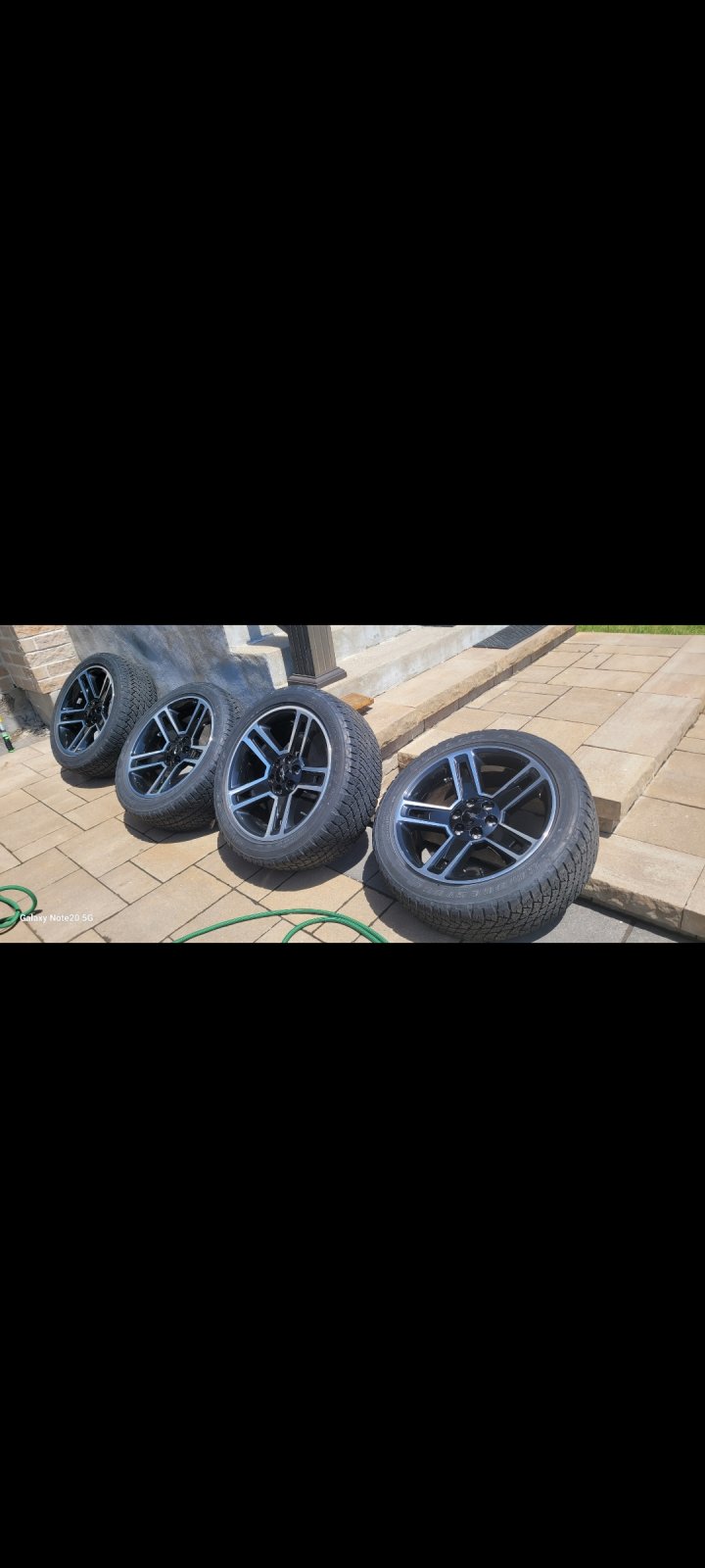

Hello everyone... I just bought a 2021 tahoe LS with stock 18inch wheels
I wanted 22's and found Silverado 22's that have the same bolt pattern slightly different offset.
I got 6mm (as recommended) spacers and the wheels still touch the calipers.
Any ideas...it's driving me a little crazy really.
Appreciate the help
Thanks
Al

What year Silverado were the rims from? Any 19 or newer Silverado/Sierra and 21 and newer Tahoe/Suburban/Yukon rim should fit just fine. Most 18 and older Silverado/Sierra rims will not fit because they will hit the calipers (20 and older for the Tahoe/Yukon/Suburban). I think your only option is to find a spacer that gets the rims away from the calipers or get rims that will work.

Thanks Jay...I think the details in the years of the vehicle is my exact scenario.
Would you have an idea on what size spacers and type I would need. I tried 7mm and that wasn't enough...

The best thing to do is find out what the offsets are for both wheels and then use a spacer that will match the offset, that way you won't have any issues.
