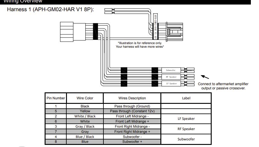

To there are three plugs that connect to the bottom of this amp. These will fit perfectly with the APH-GM02 harness offered by PACs. https://catalog.pac-audio.com/catalog/amplifier-integration-harness/aph-gm02
The wiring pinout listed for this harness is incorrect for this 2021 vehicle.
I tone generated the each of the speaker pairs and re-mapped the pinouts for anyone that would like to make their own harness to interface with this system. When an interface becomes available this would allow you to amplify your speakers without cutting factory wiring or give you a solid subwoofer output signal for an aftermarket sub. Please note you will need to disable ANC mics if you add a sub.
I did not need Harness 3. Please note the rear trim speakers are tied to the rear door speakers in parallel.
Hope this helps
My apologies for being a bit confused, but are the pin outs that you list above for the factory harness or the aftermarket? I'm trying to determine which lines on the factory harness I should tap in to for my hi/lo converter and remote start. I've seen on the interwebs that you can tap into the yellow/yellow-black for the signal (pics below), but that was a '21 Silverado. They tagged in the line in the passenger kick plate area. I'd prefer to keep everything in the back, save the power cable. Shouldn't be more than three connections and a ground, but I need a little guidance. Thanks!!
If you watch the youtube video, the plug all the way to the right on the BOSE amp has the sub signal that you want to tap into. Pin #4 and #8 Blue/Black Blue
