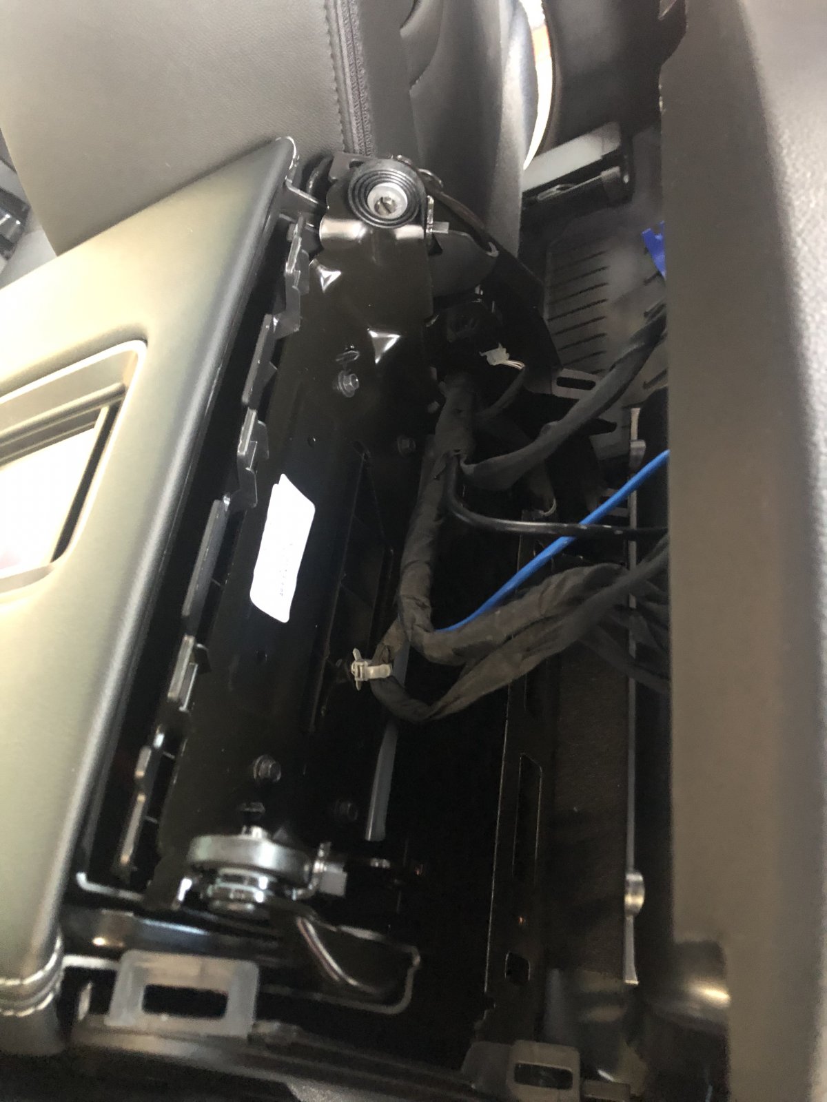

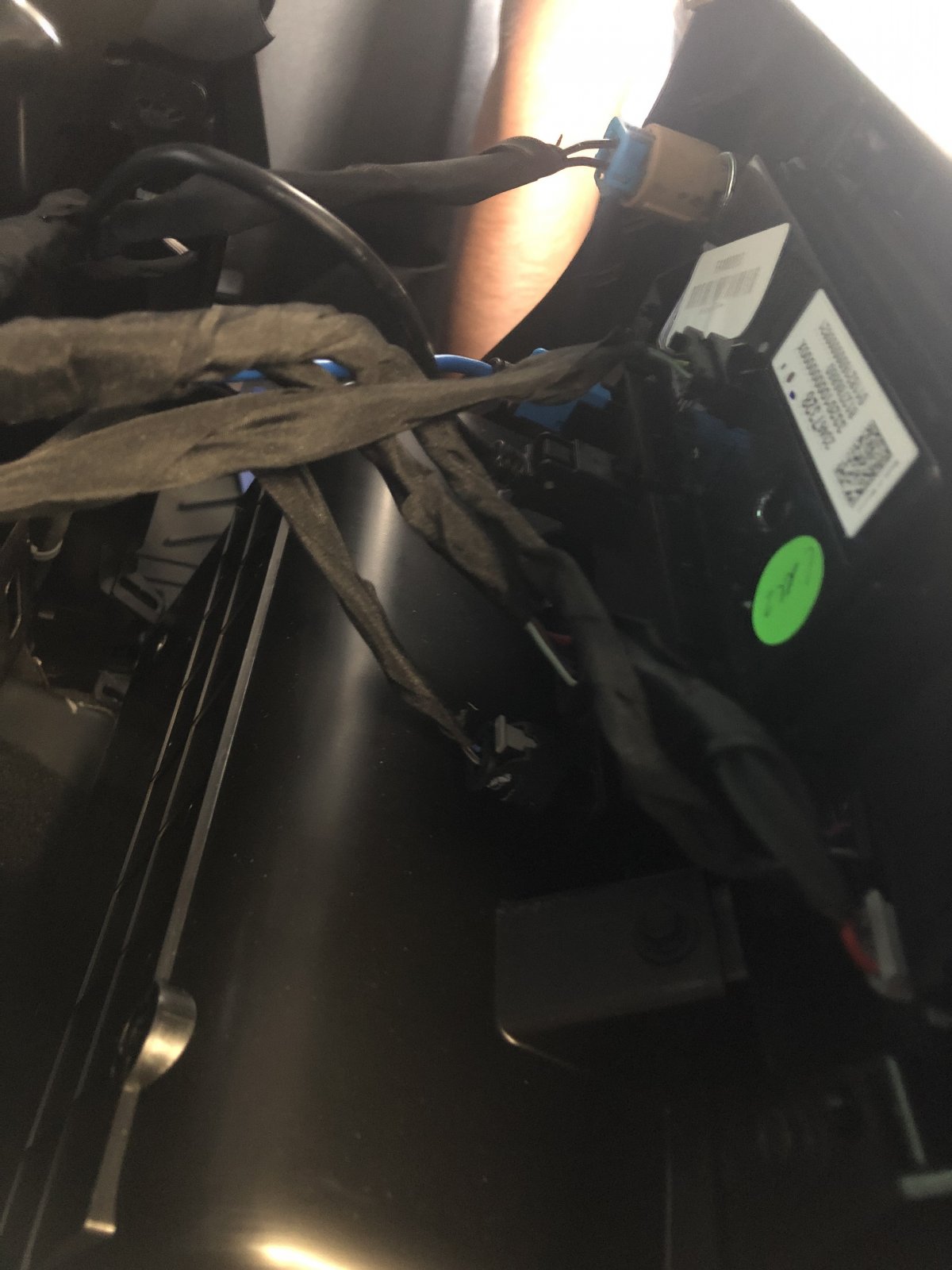

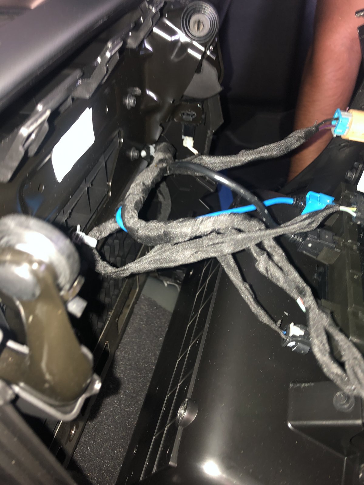

Yes, very sure I don’t have it. I removed the back of the front console to see if the wiring harness may have been included as a complete electrical snake. But as you can see from the photos, it is NOT there. I have found all the parts I need for the armrest and charger itself, but now I need help with the OEM wiring and correct parts / installation for wiring the power and the intellalink integration. Thanks!

Yes, very sure I don’t have it. I removed the back of the front console to see if the wiring harness may have been included as a complete electrical snake. But as you can see from the photos, it is NOT there. I have found all the pets I need for the armrest and charger itself, but now I need help with the OEM wiring and correct parts / installation for wiring the power and the intellalink integration. Thanks!View attachment 230004View attachment 230005View attachment 230006
I had the same setup. I only wires the positive and negative into the 12v outlet( cigarette lighter). I didn’t wire anything else. I can see the phone is charging when I place it down.
Hey Bob2C, thanks. I had seen your earlier thread and realize that wiring as you have done is an option. However my preference, at this time, is to try to stay as OEM as possible and run the correct wiring with Harnesses.
