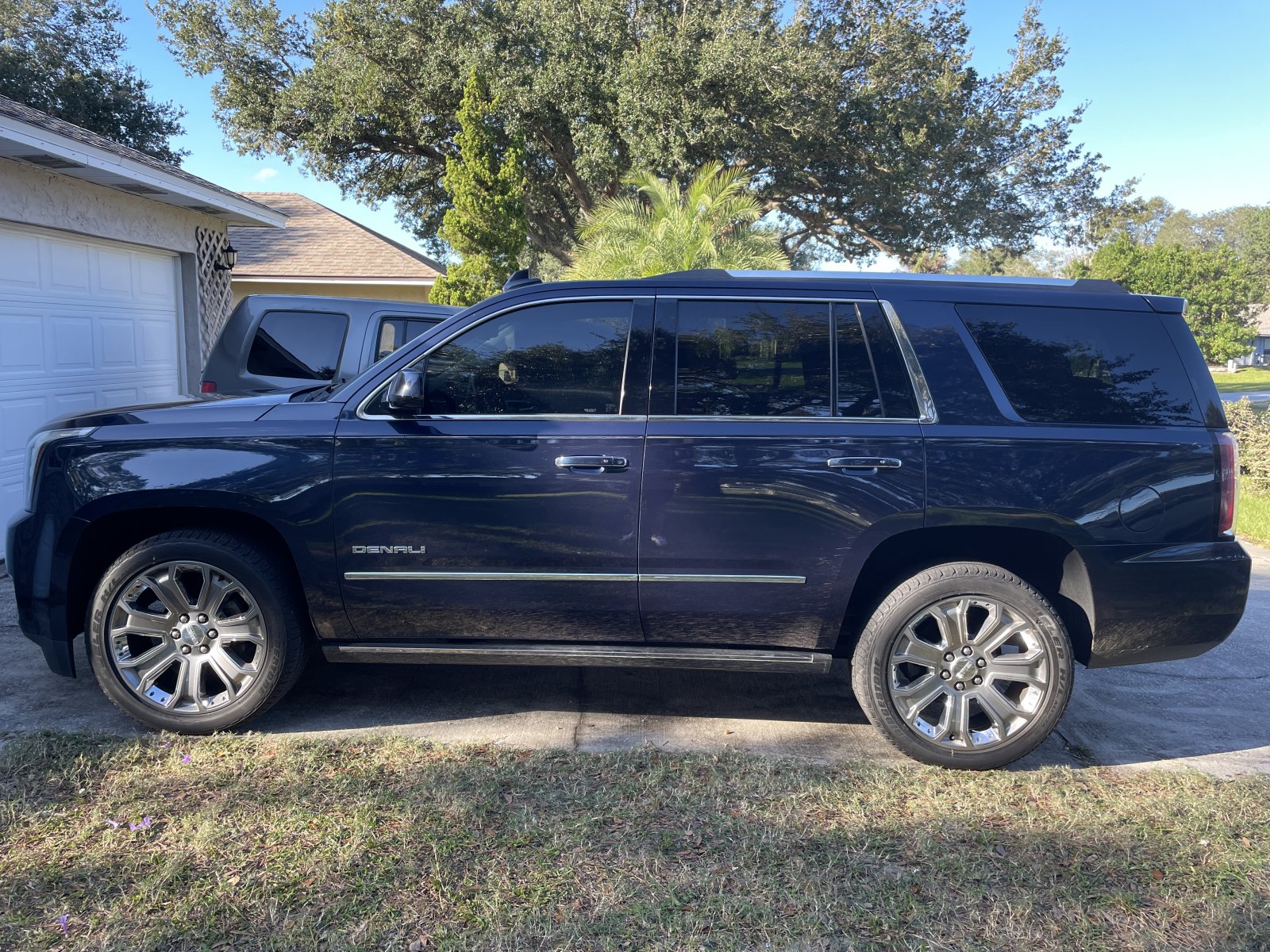

Thank you! I will for sure be active in the forums. Our first GMC vehicle. I'll have to take more pictures from different angles soon.
