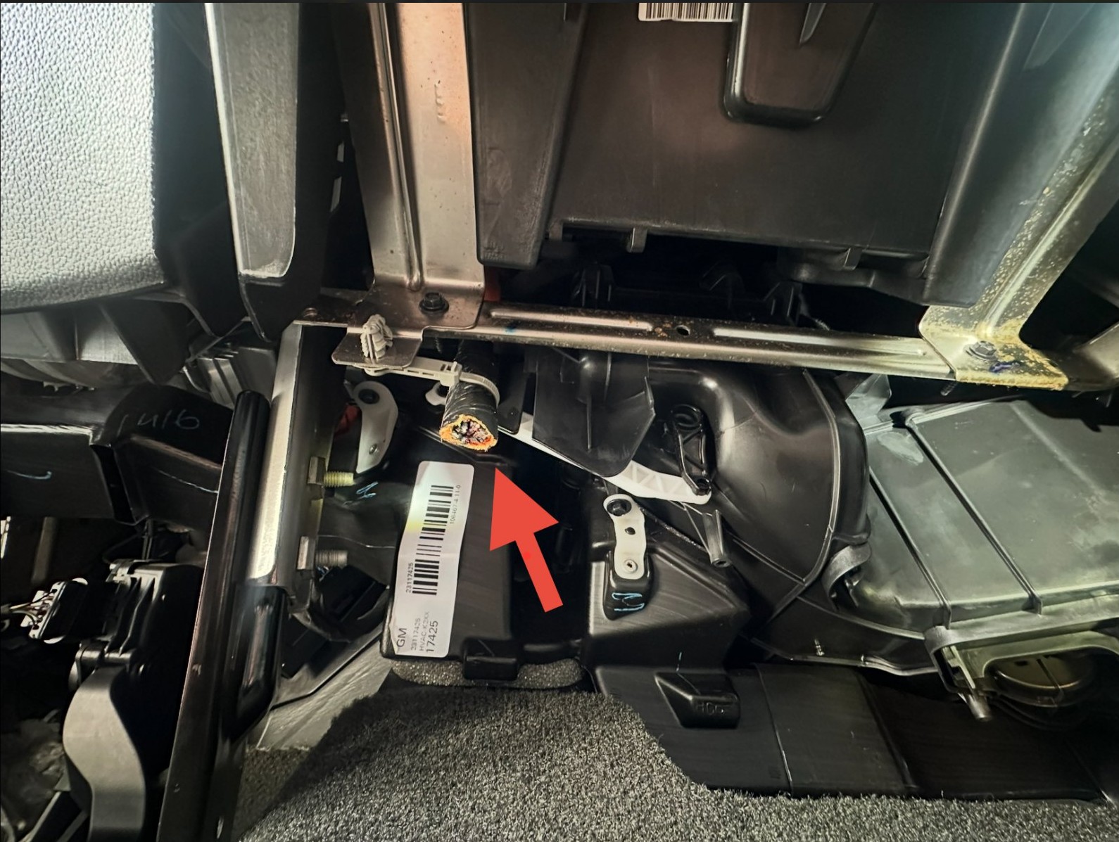

Any updates on this...I'm dealing with similar issue. 2016 Suburban 3500 LS.

Look for the PPV wiring info. The regulsr tahoe will have dufferent wires that dont exist on them. You should be able to find the 12V source for those outlets yourself it's not that hard.
120V inverter or components probably won't be there if it wasn't available on PPV.
