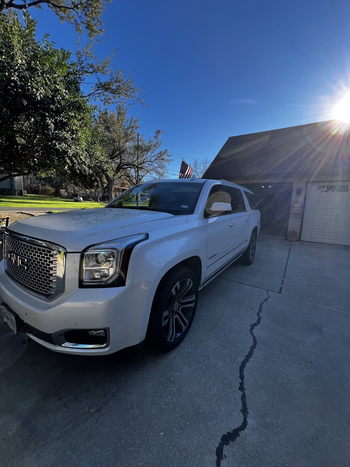

Pics of the truck, please.

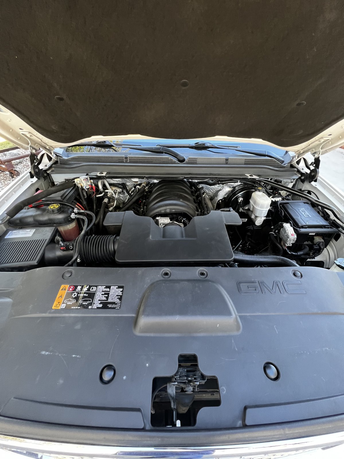

View attachment 446648View attachment 446649
what happens if you do something simple like unplugging the temp sensor? any change?
I am glad that you are listening to our recommendations regarding a quality bi-directional scanner. Add one to your tool box. Autel makes a good one in the neighborhood of $500. Then, you will be able to read ALL trouble codes, along with a brief explanation/pointer to the source of your issue. You will also be able to reset/delete trouble codes, after taking corrective action. You will literally save thousands of dollars in diagnostic and repair costs over the life of your truck, and you will most likely recoup the cost of the scanner within 1 year.
