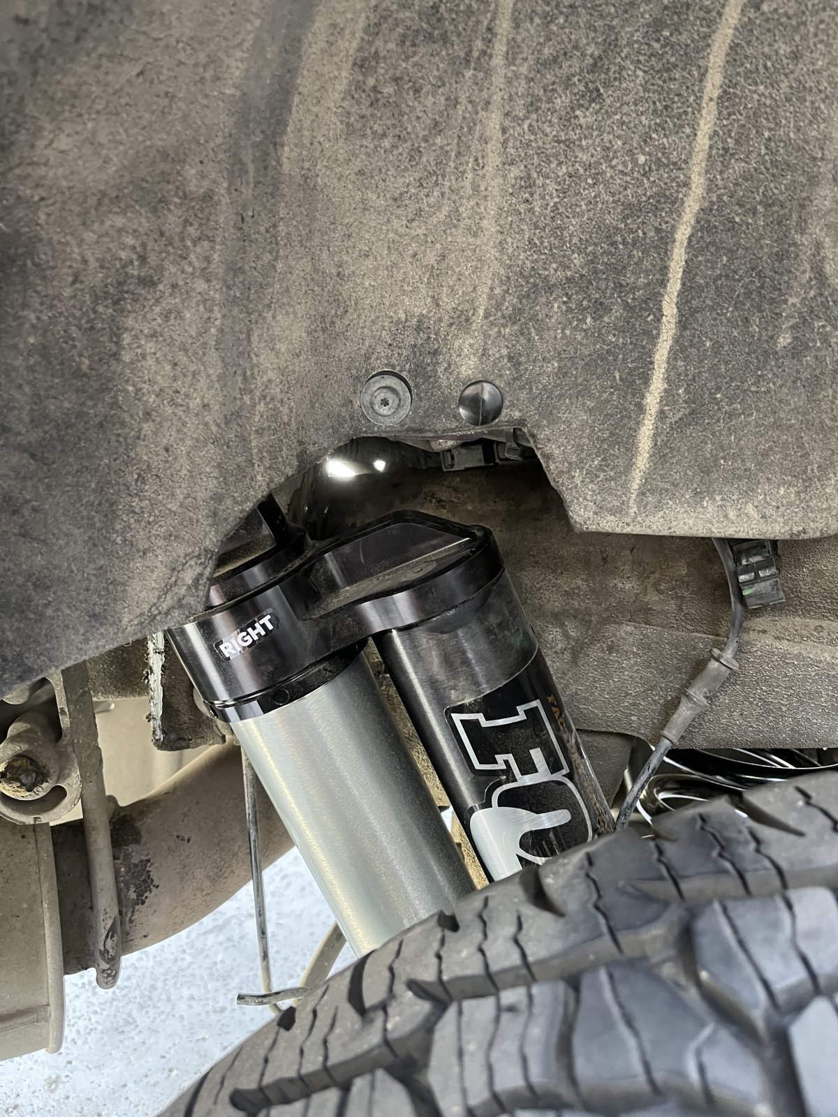

So my oem struts were completely shot out and the truck sat 34” to the wheel well. I installed the front Fox struts straight out of the box and it settled at 38” BUT remember that my old struts were sagging and probably 2” lower than when new. So 4” over the sagging struts but closer to 2” higher than new from factory. I installed the z71 coils in the rear and after settling my rear is also at 38”.
duke90
Jul 15, 2017
99
54
Corona, CA
I did like the auto level rear shocks because if I loaded up at Costco the air shocks would engage and level the truck but the new coils have double the spring load rating compared to the oem ones so I don’t even notice the truck lower after a grocery store run. The 2.5 piggybacks tuck in nicely, but I did have to trim the liner very slightly
