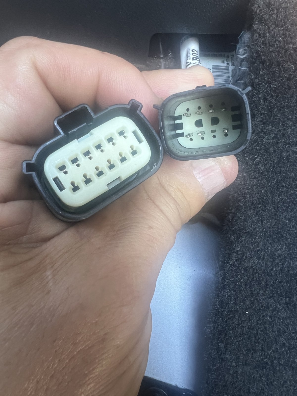

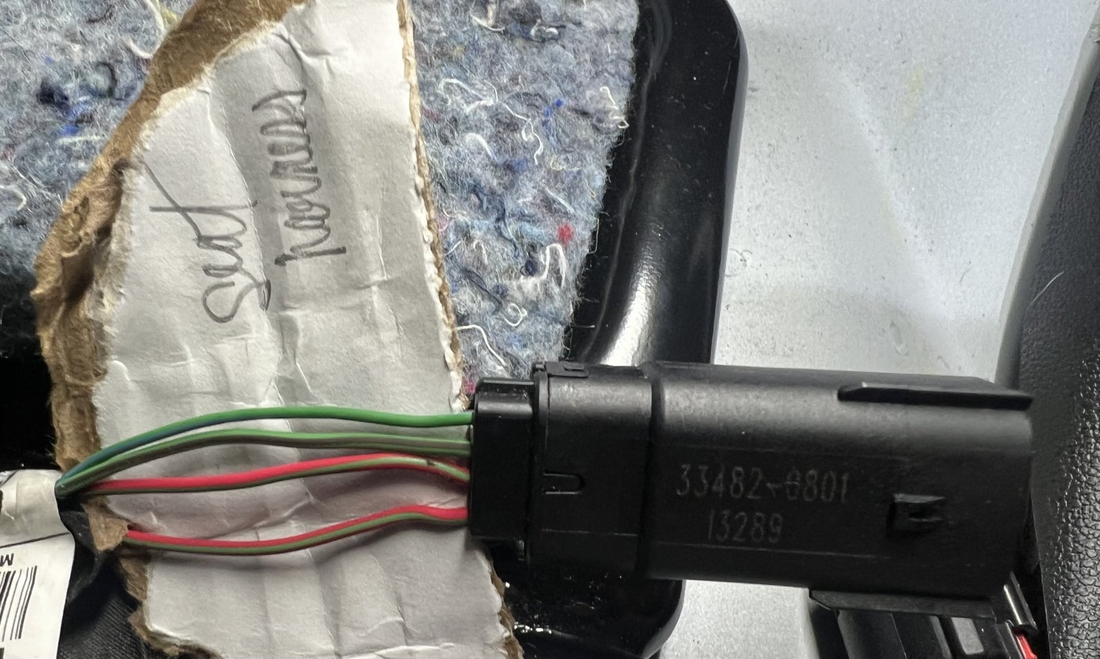

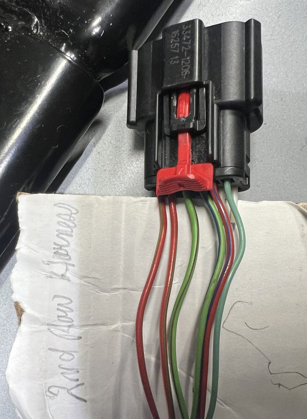

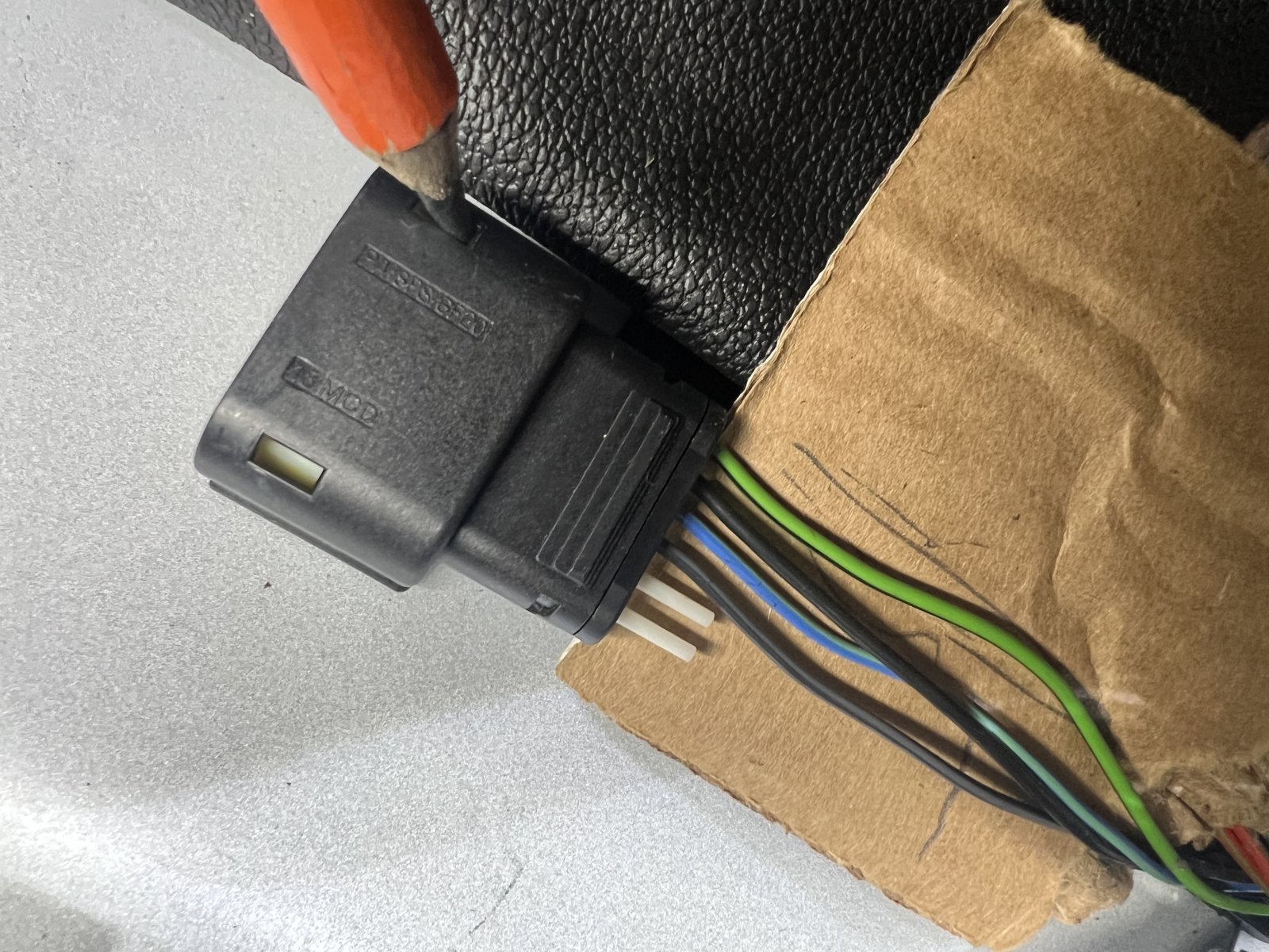

left is Tahoe harness. Right is bucket seat harness. Same with wiring pics.

See if the colors match up, and if the wires/pins are in the same spot on both plugs (with corresponding wire colors), even though the plugs may not mesh up correctly. That's good for starters, or find a wiring diagram to make the correct splice.

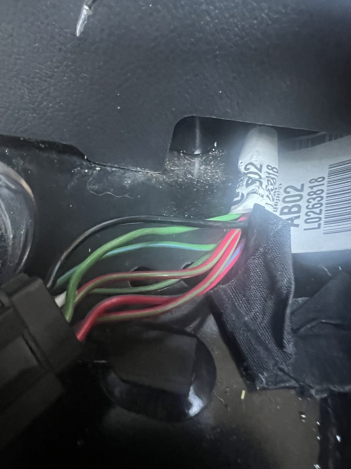

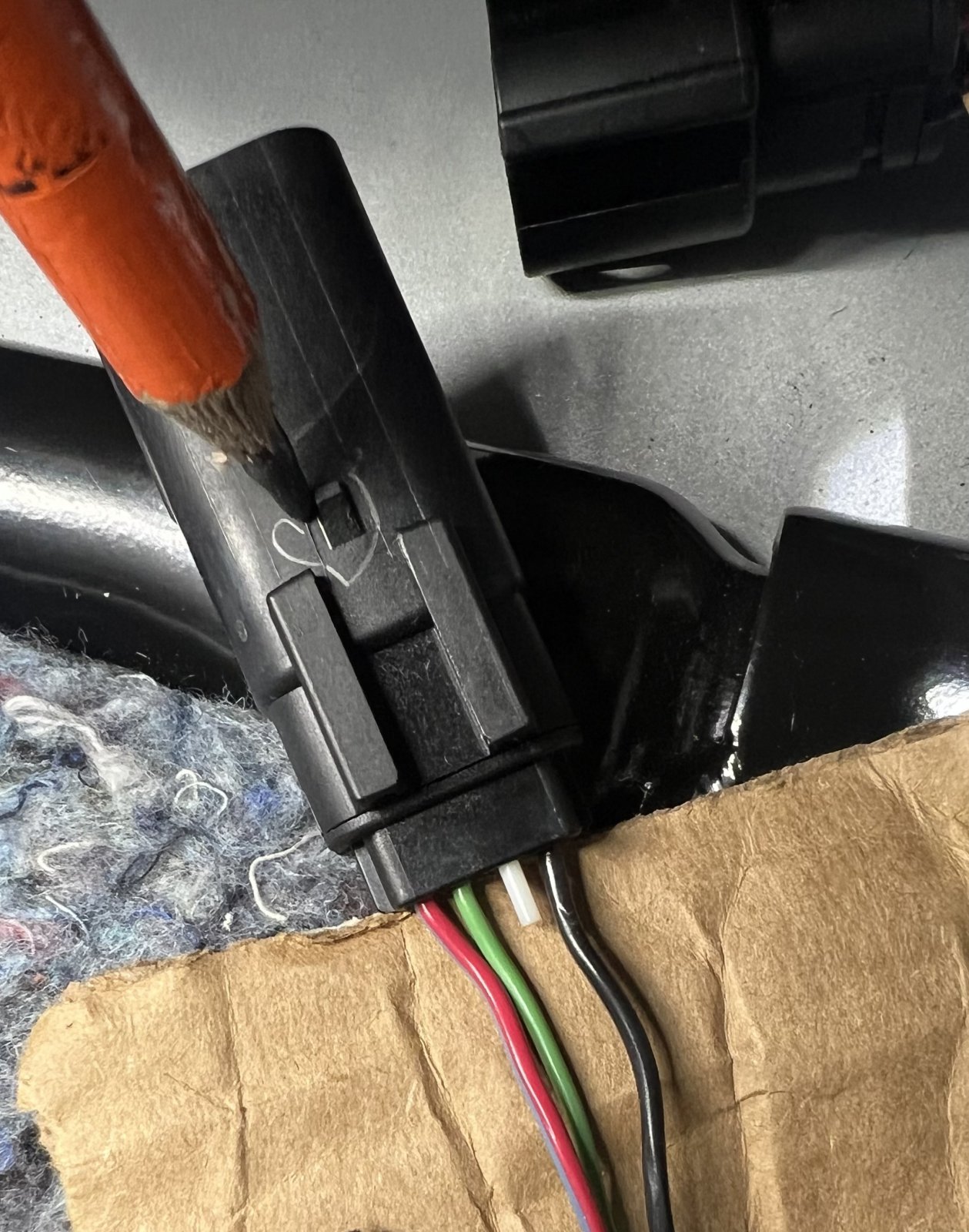

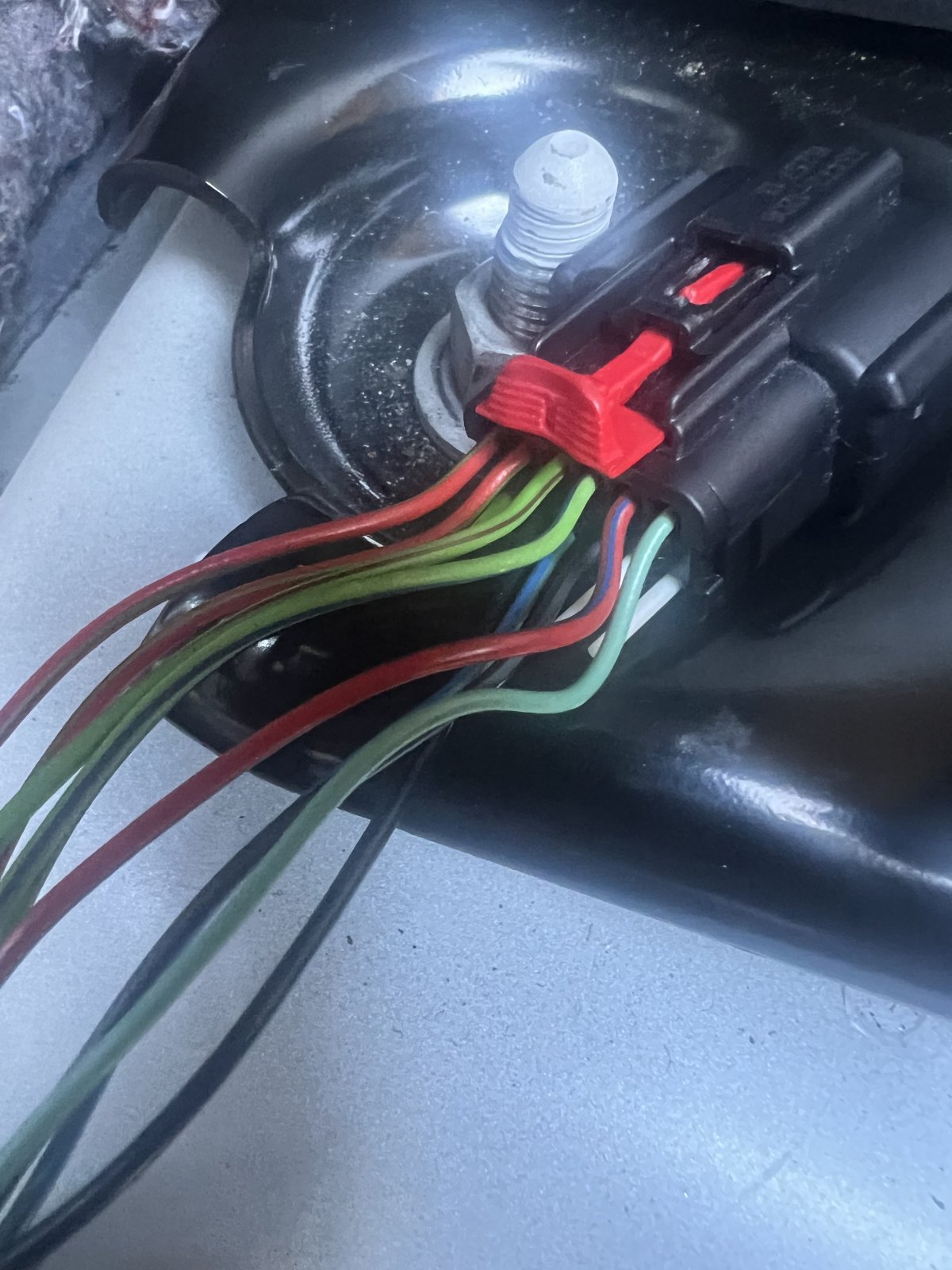

How many wires are used with that 12-pin connector on the left?? I see that the right connecter is only using 7 out of 8 pins very clearly.How many wires are used with that 12-pin connector on the left?? I see that the right connecter is only using 7 out of 8 pins very clearly.
10 of the 12 pins are being utilized.

So I am confused. The Tahoe uses 10 wires but the replacement rear seats only uses 7 wires? How many wires did the original seats use?
