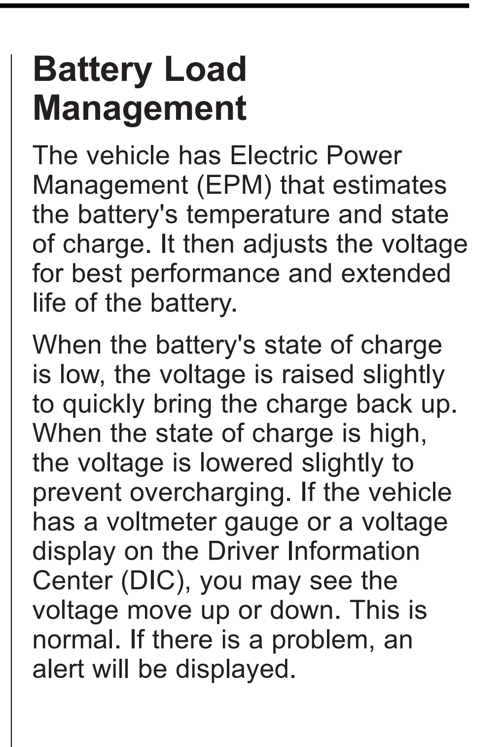

The alternator kicked the output up high because the new battery needed a chargin'. When your engine is running you are seeing alternator output on the dash gauge. When the engine is off and the key is on, you are seeing the battery's state of charge.
Look up EPM and RVC to learn how your charging system works.
