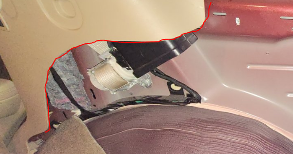

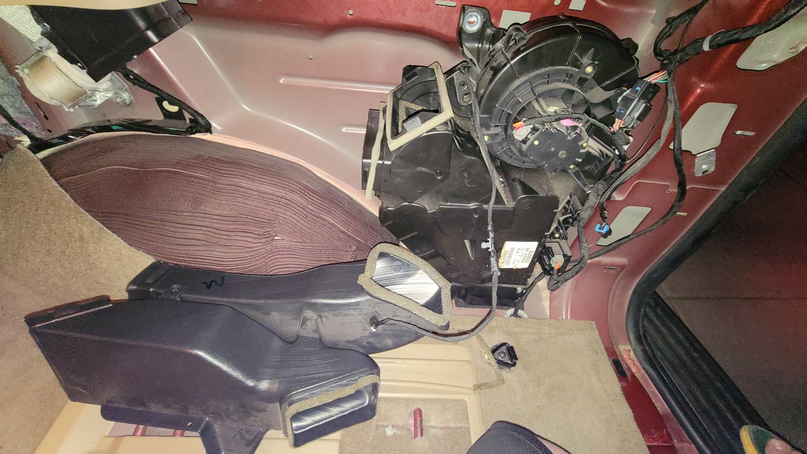

Through YouTube, i found a video on the location of the actuator (pn 15887322). This model uses two of these - one for hot/cold (not pictured), one for up/down (pictured). Same part number.
My rear ac unit is the one where the actuators are PITA to get to. These used to be easy to get to. Now - PITA.
Pro tip: take the tube off to get easier access
If you don't disconnect the battery before changing the part, you'll want to do so when you are done. Disconnect the negative terminal for a few minutes then reconnect. Turn on vehicle and let the ac calibrate for a few minutes. My actuator opened and air was routed to the top
Boom! $600 saved!!!
(I suck at documenting the actual work)
