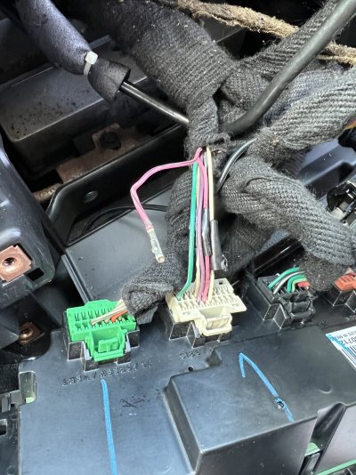

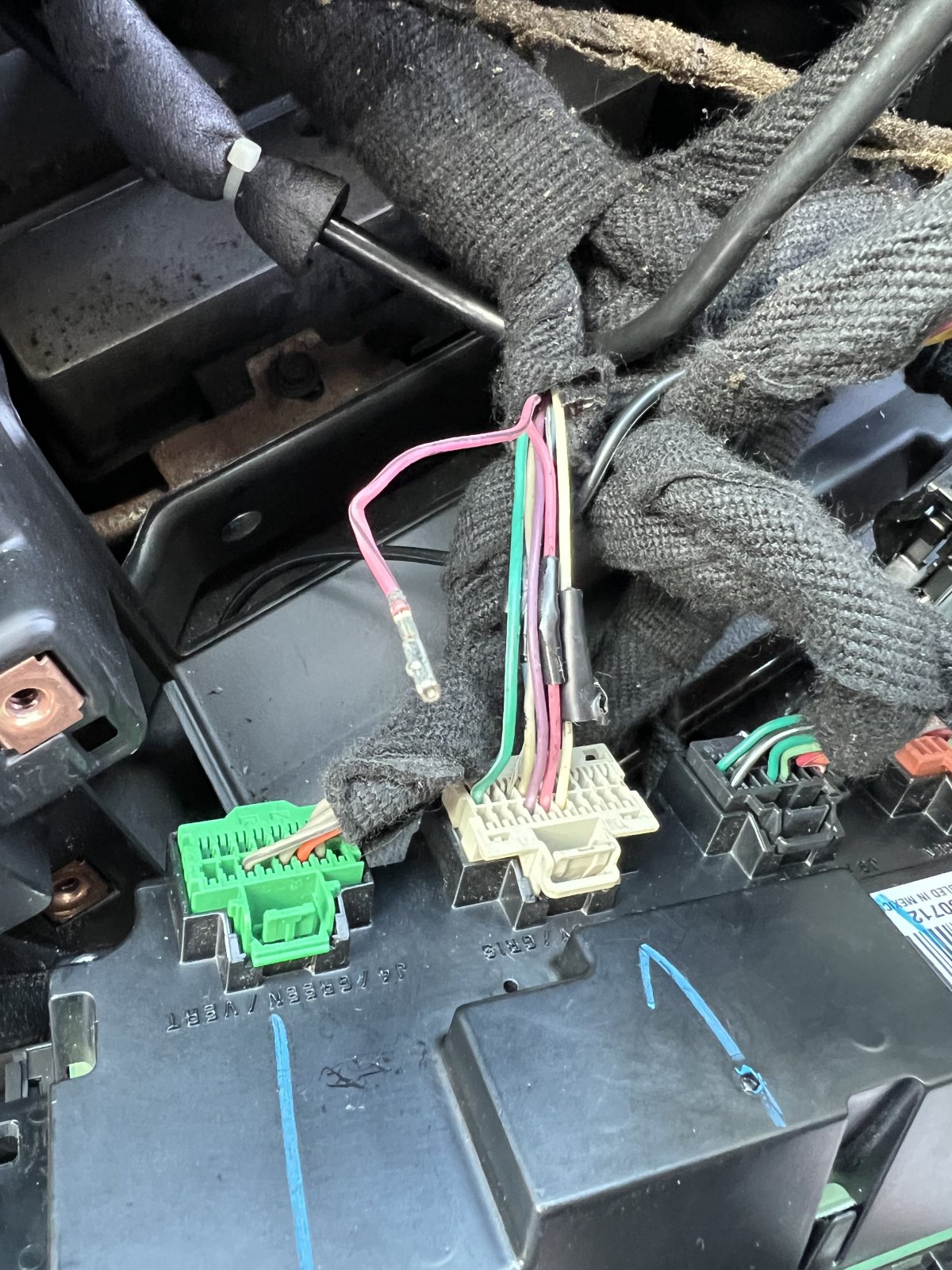

Recently put back the OEM Bose radio on my 2013 Yukon xl Denali. It had an aftermarket Phoenix android radio that blew out. On that radio the AC/ Heater control was physically moved to the Phoenix radio. When I took the radio out I noticed a Pink W/ Black stripe wire that may have come out of the connector. I am trying to see what the wire is and if it has to do with the AC blower motor as the ac is no longer working. AC resistor/ Module tested good. Does anyone have a picture of the wiring harness for the 4 connectors that go to the AC control panel?

Recently put back the OEM Bose radio on my 2013 Yukon xl Denali. It had an aftermarket Phoenix android radio that blew out. On that radio the AC/ Heater control was physically moved to the Phoenix radio. When I took the radio out I noticed a Pink W/ Black stripe wire that may have come out of the connector. I am trying to see what the wire is and if it has to do with the AC blower motor as the ac is no longer working. AC resistor/ Module tested good. Does anyone have a picture of the wiring harness for the 4 connectors that go to the AC control panel? View attachment 395560Wirri
I just went through 3 wiring diagrams and don't see a Pink/Black or Red/Black wire going to the HVAC control module.

New controllers must be programmed, they are not plug and play. Used ones might work if they have same options as yours.
Thanks for the update. It was actually the ac/ switch I replaced. I also tried the resistor under the passenger side dash. UI am going to bring it in to a local shop that I saw had great reviews.
