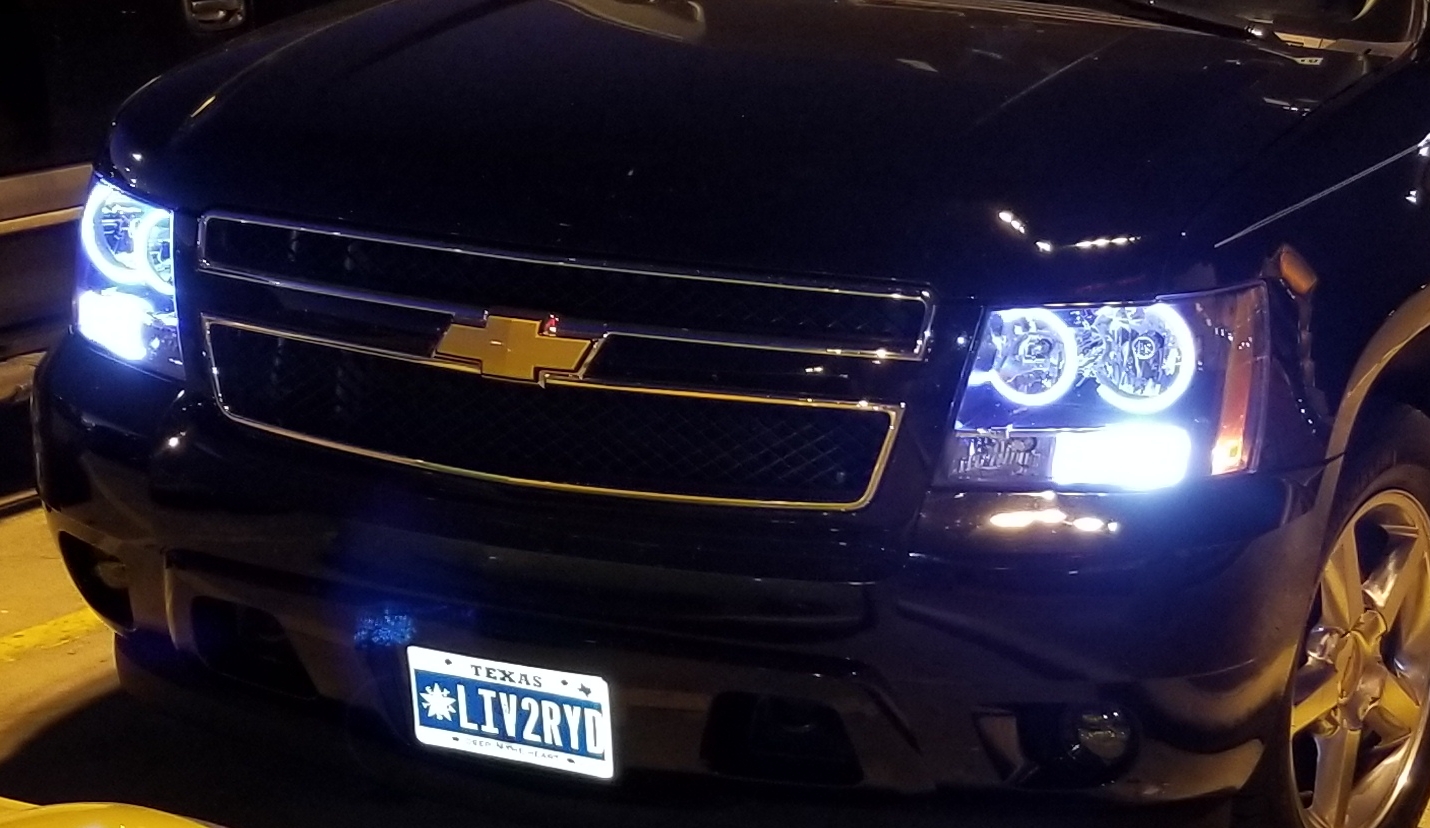

I know right, I have never experienced both of any Auto lights going out at the same time, I am kinda hiding and watching to see if there is something else causing this to happen. The only thing that I had done (lighting) was putting HID's and halo's on the head lights. I did not want to crack open the headlight housing to put the halos in, but that was done in 2014 so if that was an issue it should have surfaced way before now. So until then, I will keep a watch on the DRL's and let the forum know if anything else pops up.
Those are really, really cool looking headlights. Well done, and worth the effort in my opinion. I've always preferred the front end of the NNBS Tahoe/Suburban to that of the Yukon/XL. Later generations are the opposite for me though.
