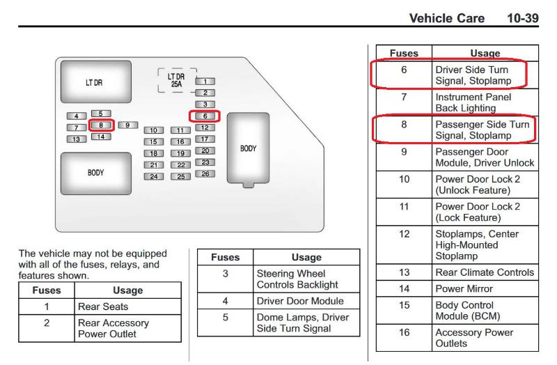

^^^ What @gooffeyguy said. If the bulbs are good, check the stoplamp fuses if you haven't already. (The high mount stoplamp has its own fuse in the underhood fusebox.)
The lower brake lights each have their own fuses in the instrument panel fuse block; the access door is located on the driverside edge of the instrument panel. Fuses #6 & #8.

I did that yesterday and the fuses didn't look blown so i didn't mess with them until today and replaced them anyways and .... they worked thank you
