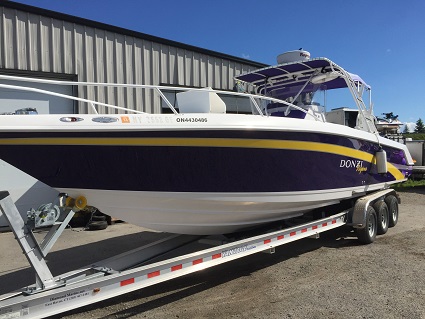

I have ordered the Timbrens kit to install. I recently replaced my air compressor for my auto ride. But I will be towing a 35 ft center console (9500 lbs incl trailer) about 35 miles to the storage yard.

Are you installing Timbrens on the front? I have a pair but have not installed them yet.
I can't recommend the Hellwig kit for the rear enough - so much better than the coils to maintain ride quality as you load it down. I also have Supersprings in my rear bump stops but they basically never touch since I can balance out anything with the Hellwig bags - I've never gone above 70 psi in them and you can go to 100 psi. Unloaded I keep them at about 45 psi.
