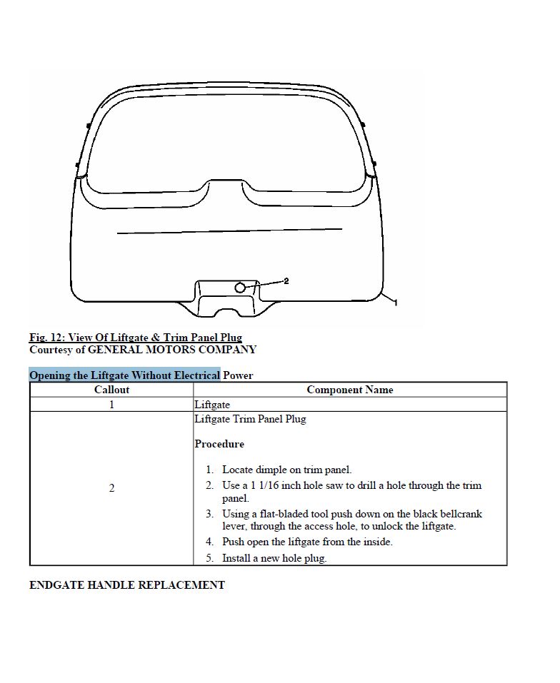

well I learned something new today..... ( see attached)
but at any rate when you press the pressure handle to open the gate do you hear a hum sound or clicking?

Up here to the right
I would do as wes said and drill the hole.
If your window pops then rear hatch is getting power so that isolates problem to actuator or outside switch.
