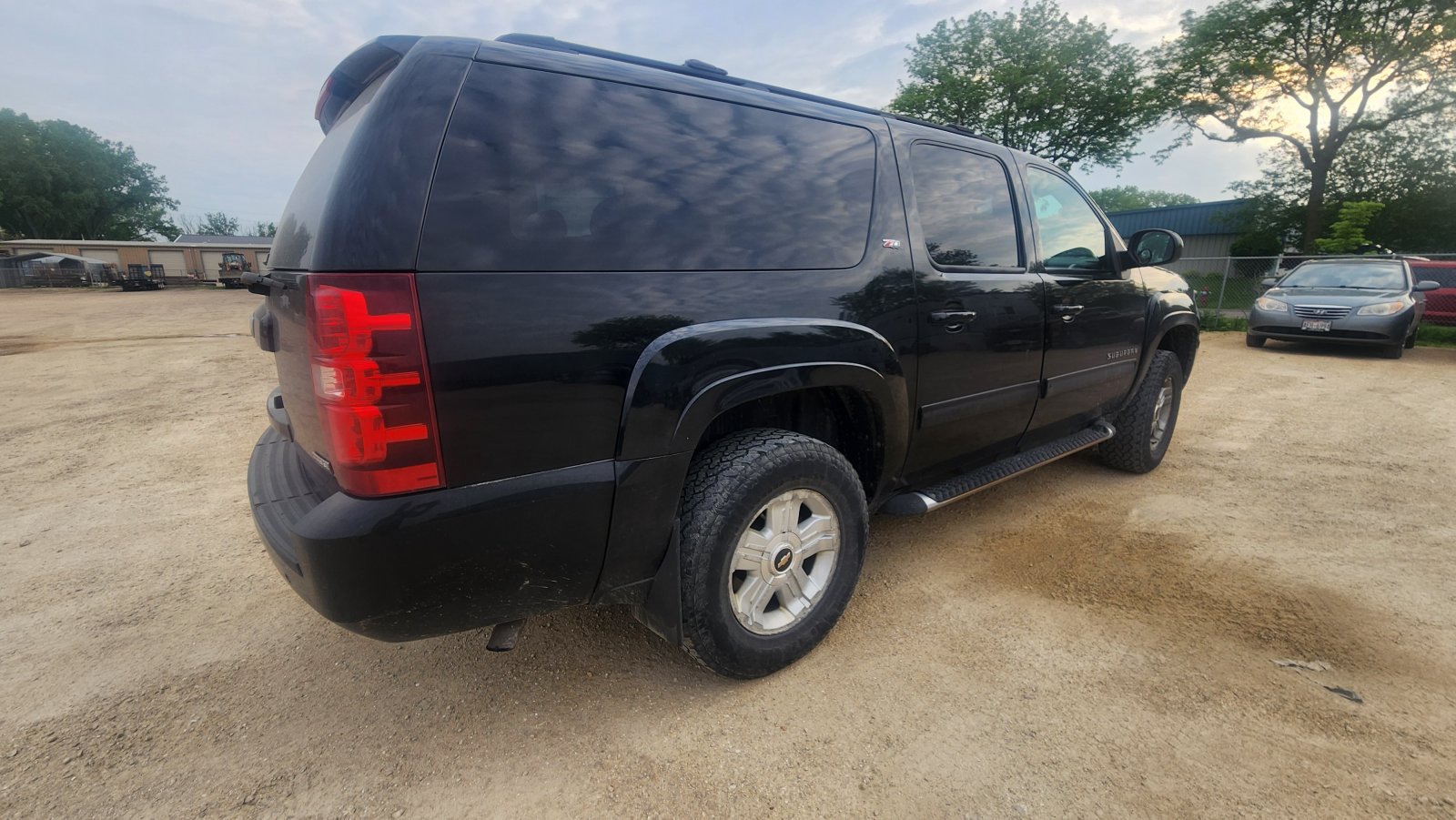

Pics of the truck, please.

Your tires are about 1-1/2 inches taller than mine and yet our back ends are about the same height. Since your front is nearly the same height as the back on your truck, I would say that she is leveled. She may have spacers above or below the struts or use a longer strut assembly if she has aftermarket units.

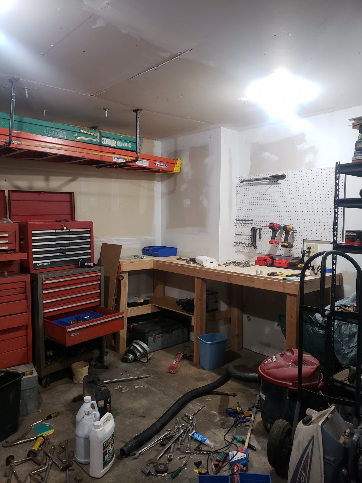

I removed the old struts and noticed a spacer bolted to the top of them. I am keeping the old struts because I saw somewhere they do not make the springs anymore. Next I bolted the after market spacer to the new struts. I noticed the studs on the Monroe strut needed to be cut lower or they would hit the strut mount. I am going through a separation and am not used having minimal tools around. I will post pics at the end of my old garage. Oh how I miss that garage (the wife stayed in the house). So after an Uber ride to Menards to pick up a cutting wheel and a tap and die set, the strut was ready to install. The after market spacers make the bottom strut mount too low to just pry it up onto the lower control arm. So I removed the sway bar and the lower control arm bolts on the frame. I held the lower control arm up with a jack and pieces of wood. Lowered the lower control arm down and bolted the strut to it. Then jacked the lower control arm back into place and replaced everything. I see now why replacing everything at the same time would have been the way to go. I will do that next time. After lowering the truck back down and torqueing everything back up, I took it for a test drive and the squeaking was fixed.

Love the Z71 Suburbans and their fender flares!
