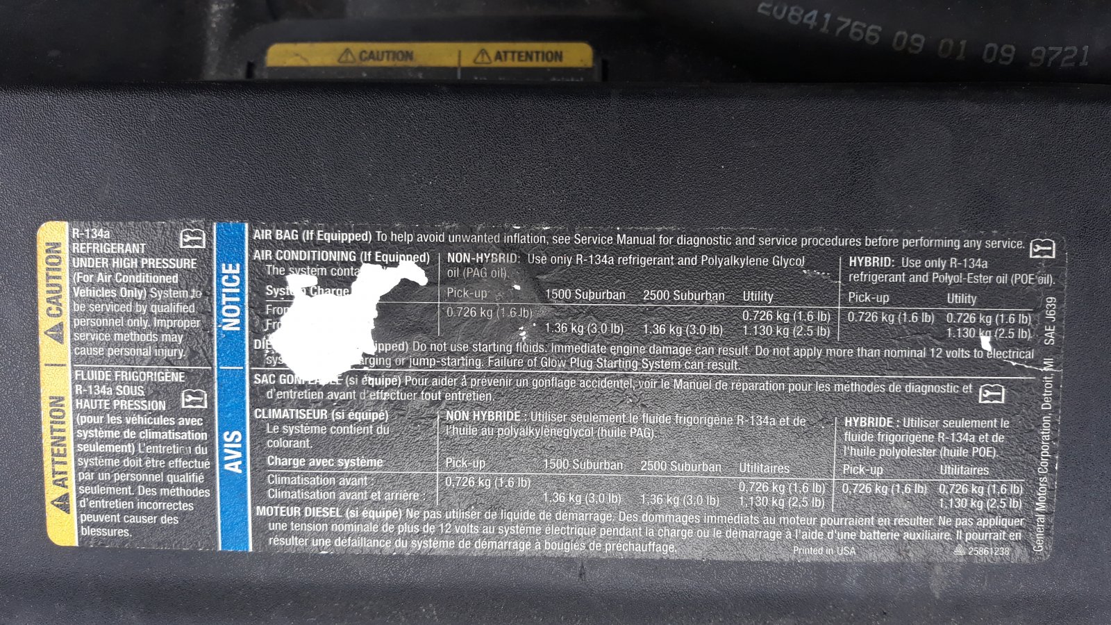

It ought to say on the sticker under your hood, if it is still there and legible. The short Denali holds 2.5 pounds of refrigerant and if long, 3 pounds. 20190807_165540.jpg
