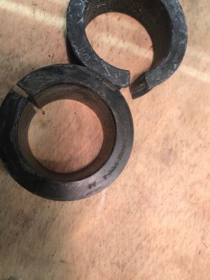

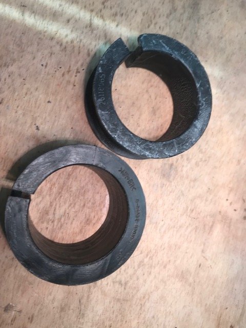

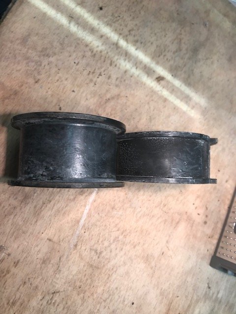

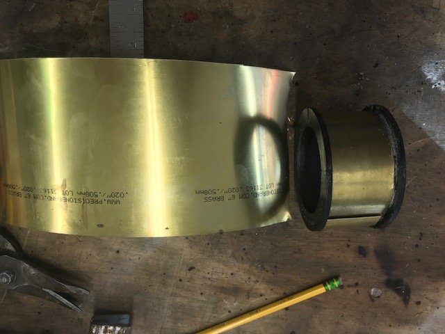

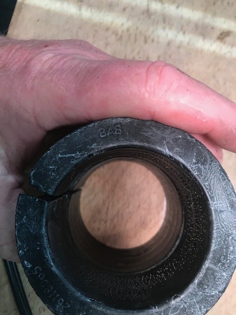

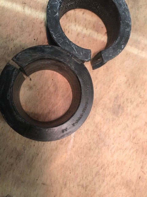

2009 Hybrid with Electric steering that has a bad big bushing on the passenger side and I cannot find a replacement. Actually ordered one for a NonHybrid hydraulic rack GM part #22960484 The rack body Od dimensuons are the same but the Hybrid rack uses a support bracket and bushing that is approx 1/2" wider. The Hybrid OEM bushing had a part number moulded into it NR+BR-0-S4532-B7010-A After an extensive internet search no results. That FEBEST site is WRONG in listing the kit to fit a hybrid with electric steering theie bushing in the kit DOES NOT FIT a Hybrid with electric steering rack. I have contaced a steering rack remnaufacture company to see if they would sell me a bushing only. This is BS lol.
I reasssembled and used some .020 brass shim stock between the old bushing and the support block to tighten it up a bit. Should be good for several thousand miles maybe or until i can find a replacement bushing that fits.
