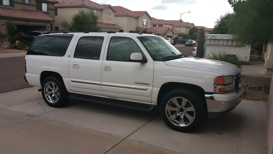

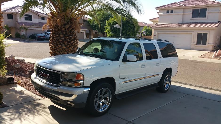

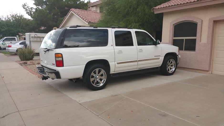

2004 Yukon XL, let me know what you think
RLAMBERT02
Aug 13, 2015
Phoenix, Az
I bought this 2004 Yukon XL slt one week ago. It’s a clean title with 167k miles on it, I’m the 3rd owner. Always been owned here in AZ. Fully loaded (I believe) leather seats, moon roof, Bose Audio, heated and electric driver/passenger seat, rear a/c. It’s completely stock, no mods, besides some cheap 20s. Transmission replaced with GM certified rebuilt trans. Also done within the last year: alternator, radiator, major break components, shocks and other misc things. (Have receipts for Trans and brakes).
I bought it for only $5500, KBB listed 7500-8000. I bought it because I also have a 2013 limited edition WRX, which has a decent amount of work done to it, and I just wanted something else cheap for my daily driver. And I have a 2 year old and one more on the way, so i wanted something safer and more comfortable for them. I bought the Yukon from an older gentleman whos reason for selling seemed legit. So far its been great with no issues, suspension seems lose/wobbly, but im used to driving imports with a more stiff suspension. Took it to my suspension/alignment shop just yesterday and they said all the suspension looks just fine.
Things I am looking to do it:
Tune up – Spark plugs, looks like everyone likes the AC delcos? Oil change, probably mobile one synthetic, or some other quality syn. What does everyone recommend for oil filter? Any other inexpensive, relatively easy tune up things you guys recommend I should do?
Lowering kit – Want to do a 3/5 drop. My suspension guy recommended I should to the Mcgaughys kit. He said he’s had a lot of problems with the belltech ones not lining up correctly for installation ( he’s not a dealer for either company). If I do this kit is there anything else I should do suspension wise to make it ride better or just hold up better? (planning on 22” rims eventually)
CAI – Looking at buying the K&N 57 series, Ill probably order today I can get it from AutoAnything for $225 shipped
Headlights/Tail lights – Kit comes with all four headlights and both tail lights only 275 shipped, ebay: http://www.ebay.com/itm/231644928762?_trksid=p2055119.m1438.l2649&ssPageName=STRK:MEBIDX:IT
Grill- Chrome denali style (yukon fitment) $150 shipped ebay: http://www.ebay.com/itm/301316233651?_trksid=p2055119.m1438.l2649&ssPageName=STRK:MEBIDX:IT
Muffler/exhaust – Just want do an inexpensive setup, looking at the FM delta 50. I want something that’s throaty but not droney on the highway. What do you guys recommend?
Please let me know any tips, hints or feedback on my plans. Thanks everyone

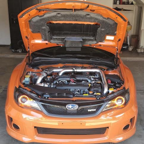

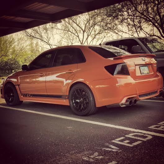

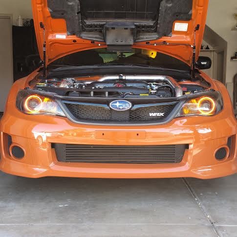

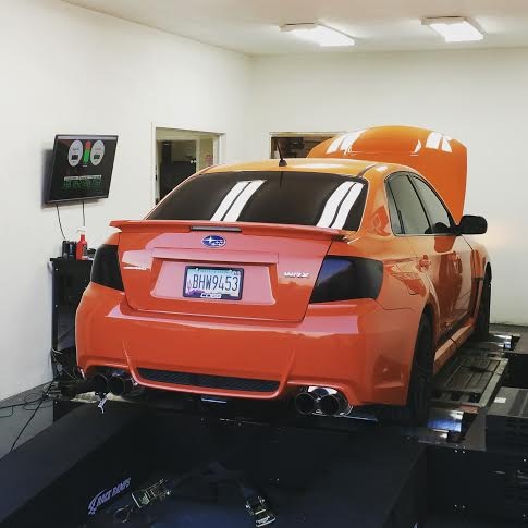

For anyone who appreciates AWD Turbo'd beauties heres my baby
2013 WRX in limited edition (1 of 200 in the world) tangerine orange. I bought it almost exactly one year ago and car only had 3,000 miles on it and looked brand new. Now has about 12,000 on it. Decent amount of tasteful mods, if anyone is interested let me know and ill put a list of mods.

I know it's an old thread and would like to know the mods on your WRX. My son
picked up a 2010 WRX and has added a few things, like exhaust, down pipe, header going on soon.
