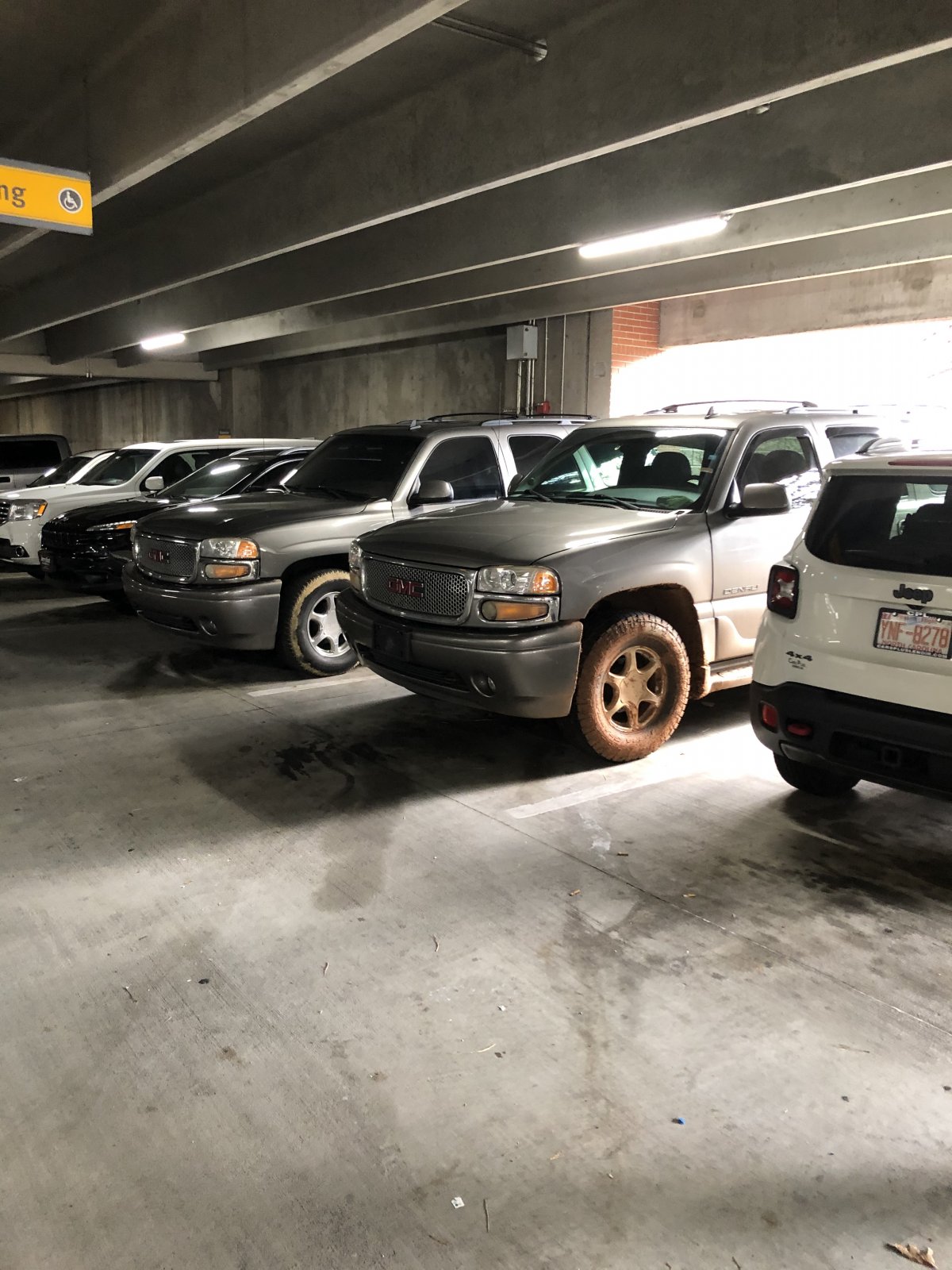

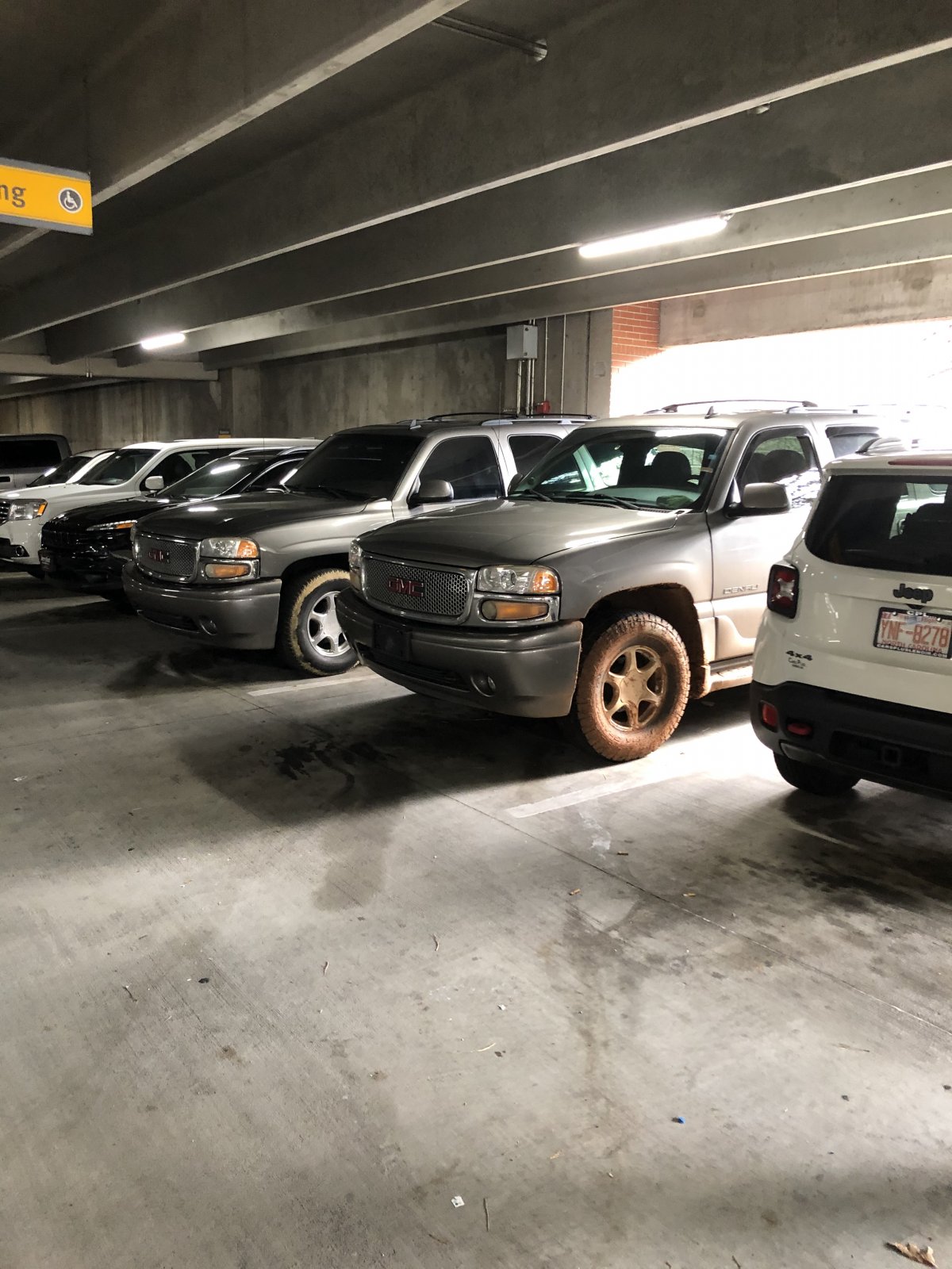

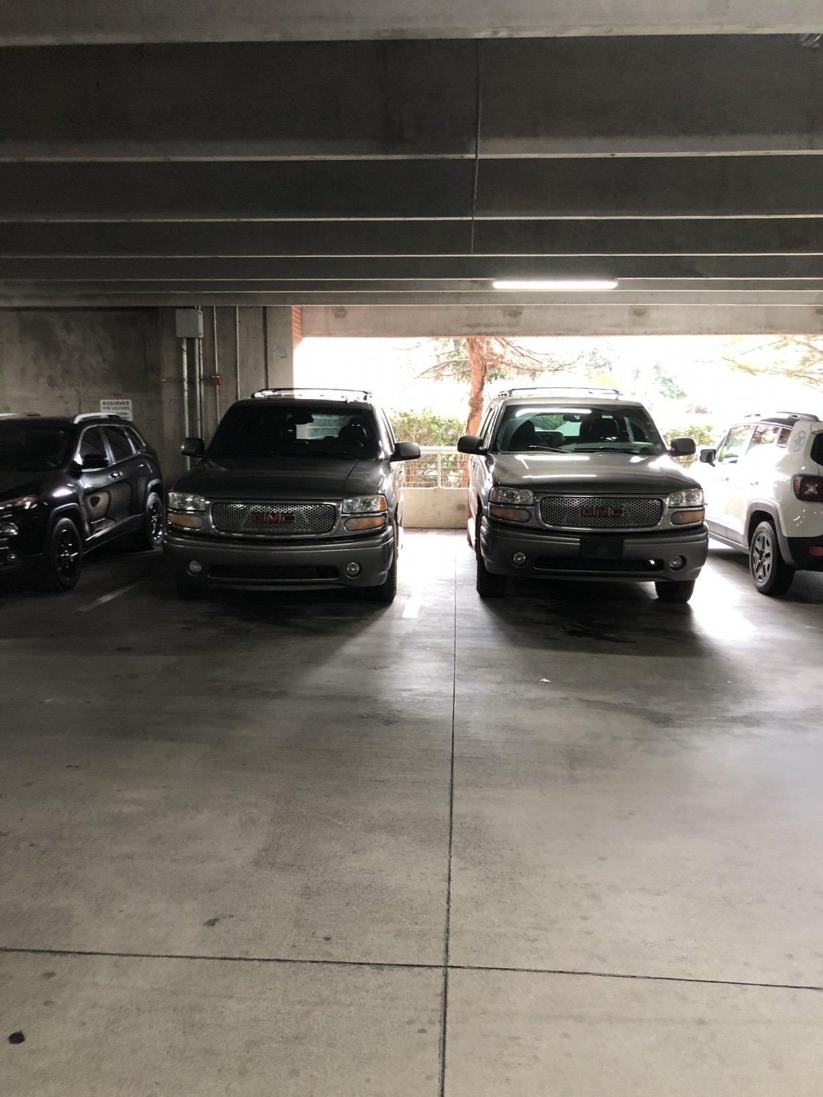

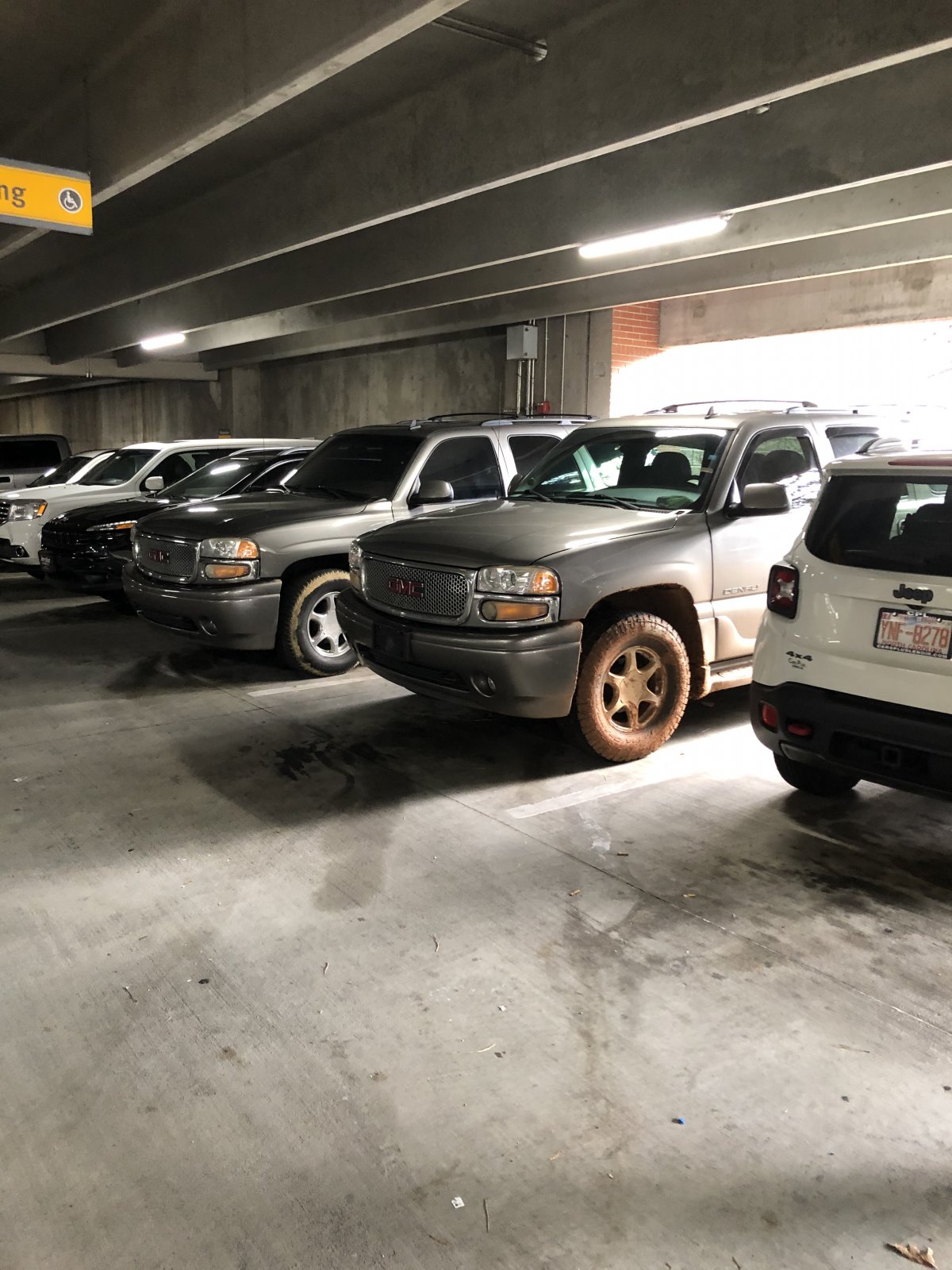

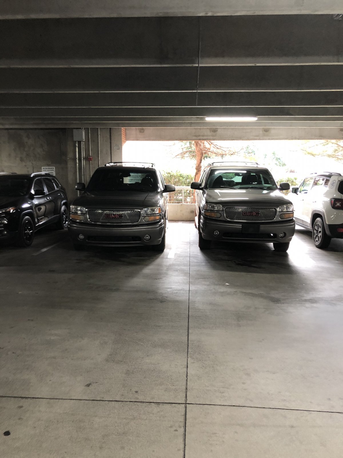

You may want to check front end well before alignment for any worn parts. My torsion bars are turned up pretty good and 285/70/17 and drives awesome ride is not bad but not stock Denali ether. With the trailer it rides pretty good.some pics I took today.
