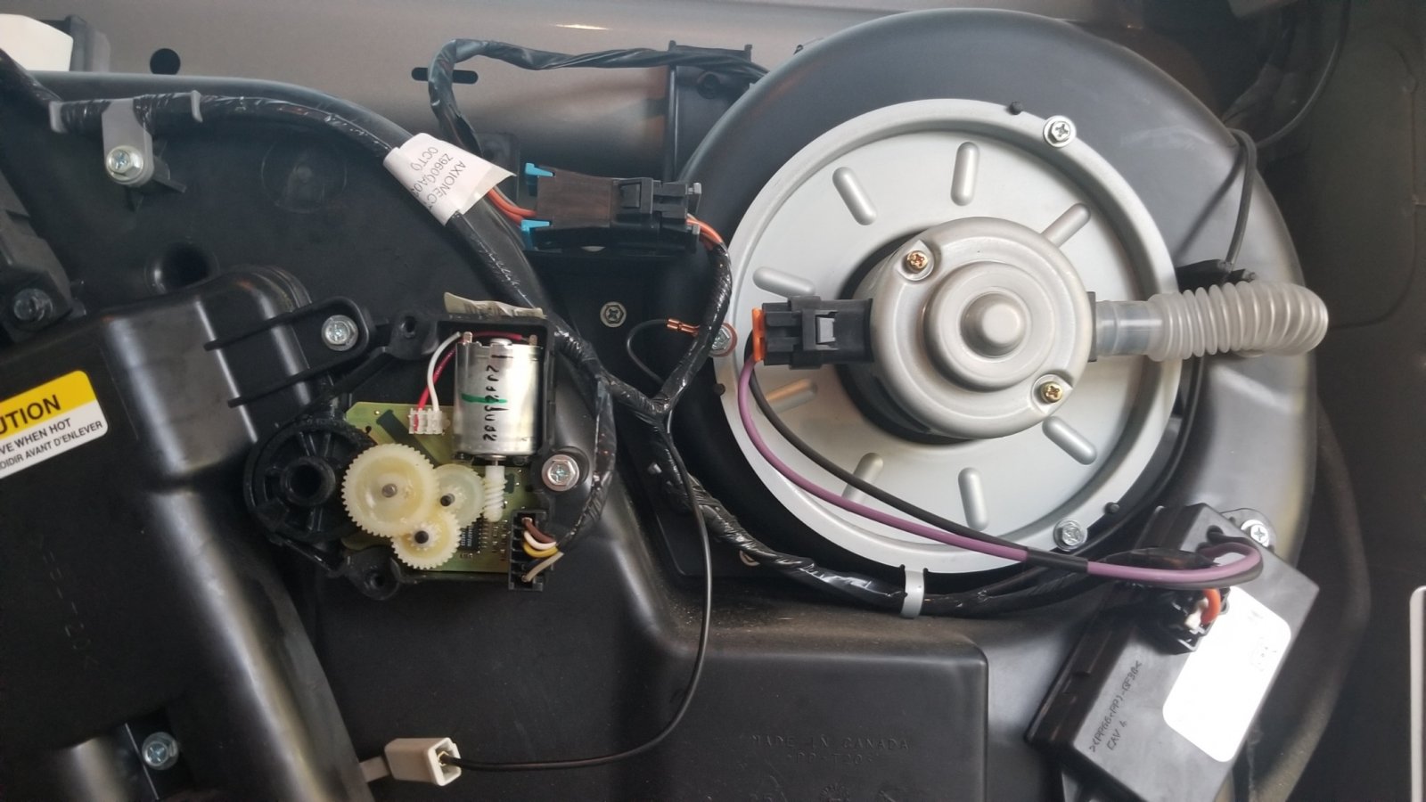

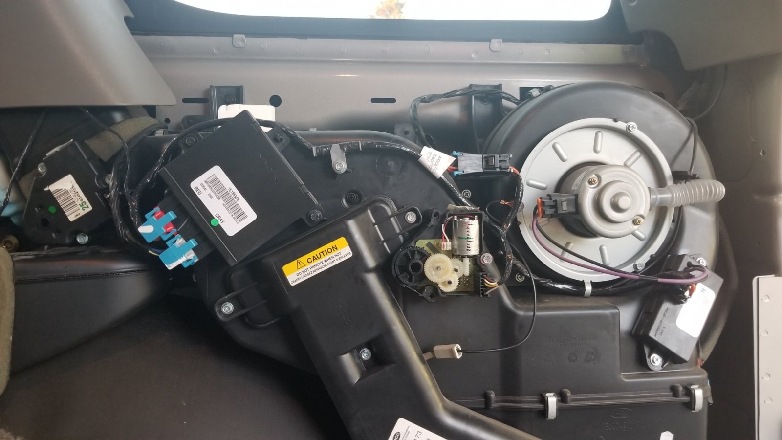

The front actuator seems to work fine, however, the rear actuator seems to go to the A/C side no matter what. I removed the cover to see if I could trick it to resetting and it seems no matter what it opens the door to the A/C.
Thoughts?

watch the actuator gear on the actuator that is closest to the blower motor, when you adjust hot to cold or vica-versa you should see it rotate, if it does not rotate then replace it.
as you turn the heat adjust you should see the actuator move usually about 1/4 turn if set to a middle temp and it should stay there unless you adjust the temp more, if it rotates fine and appears to be adjusting on it's own (like to cold when you have it set to hot) then you may have a bad ambient air sensor in the headliner.

I previously swapped the actuators and when the blend actuator that controls the hot and cold was moved into the outlet control in the front it operated as expected and the one from the front now in the rear position controlling the blend door went right to the cold position.
By substitution both actuators are working as expected and correct. So an ambient temp sensor could do that, what about the control module or whatever the component is that tells the actuator what to do?
