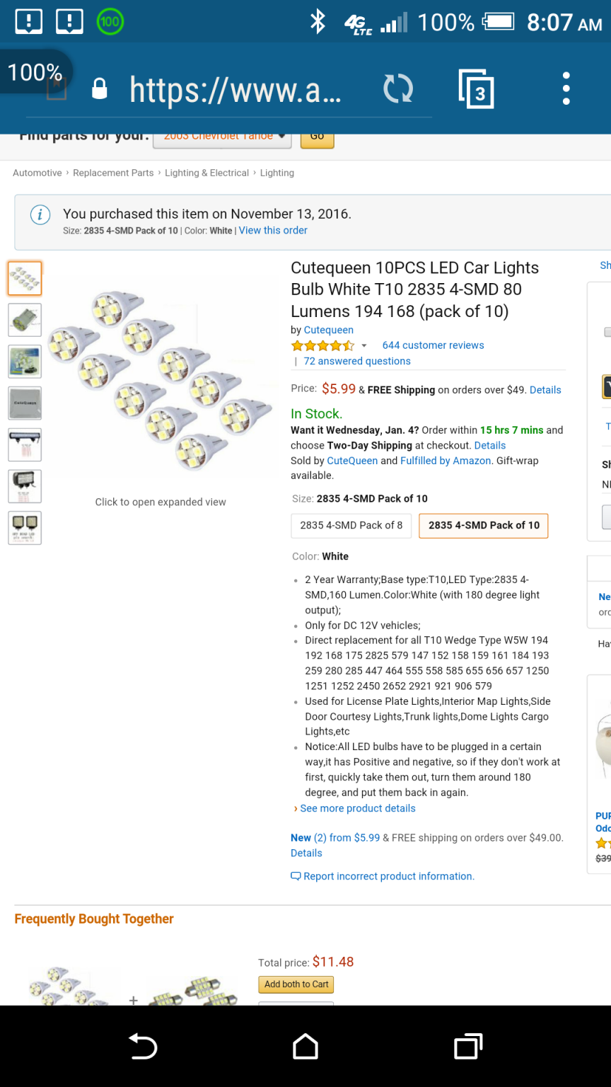

One problem I have found with converting the lights over to LEDs is finding 194 led bulbs that aren't too long to fit in the license plate light fixtures. The ones I got fit in all the locations that fit wedge base/194 except for the license plate.

@W8TVI , unfortunately in myn2006 that's the case. Stinkin electrical,stuff haha. The pack I ordered came with like 3 different sizes for all the different size sockets. Including license plate lights.
I haven't bothered to find new lights for it yet, so they are just using the stock incandescents.
I bought these and they fit perfect in the license plate housings.
