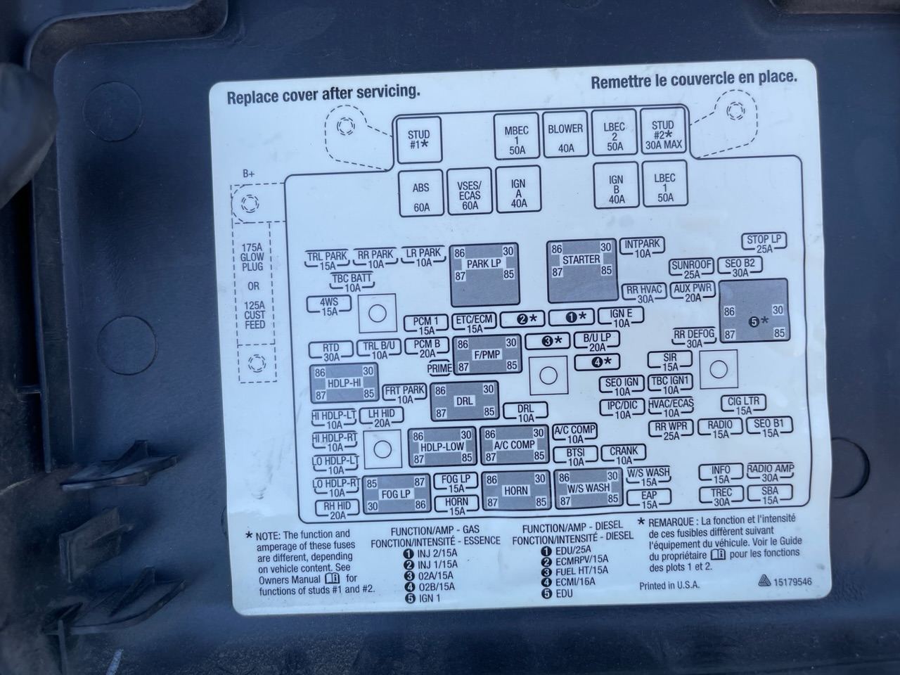

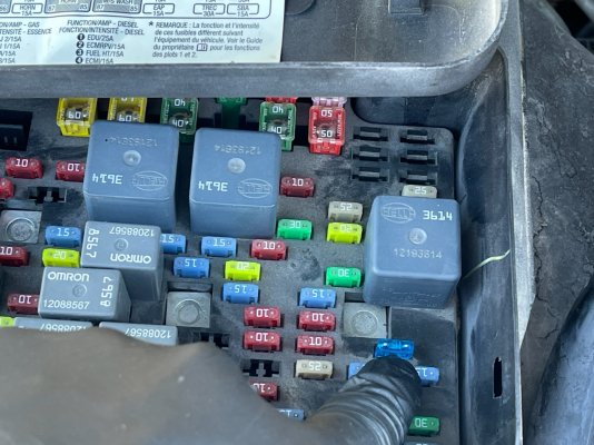

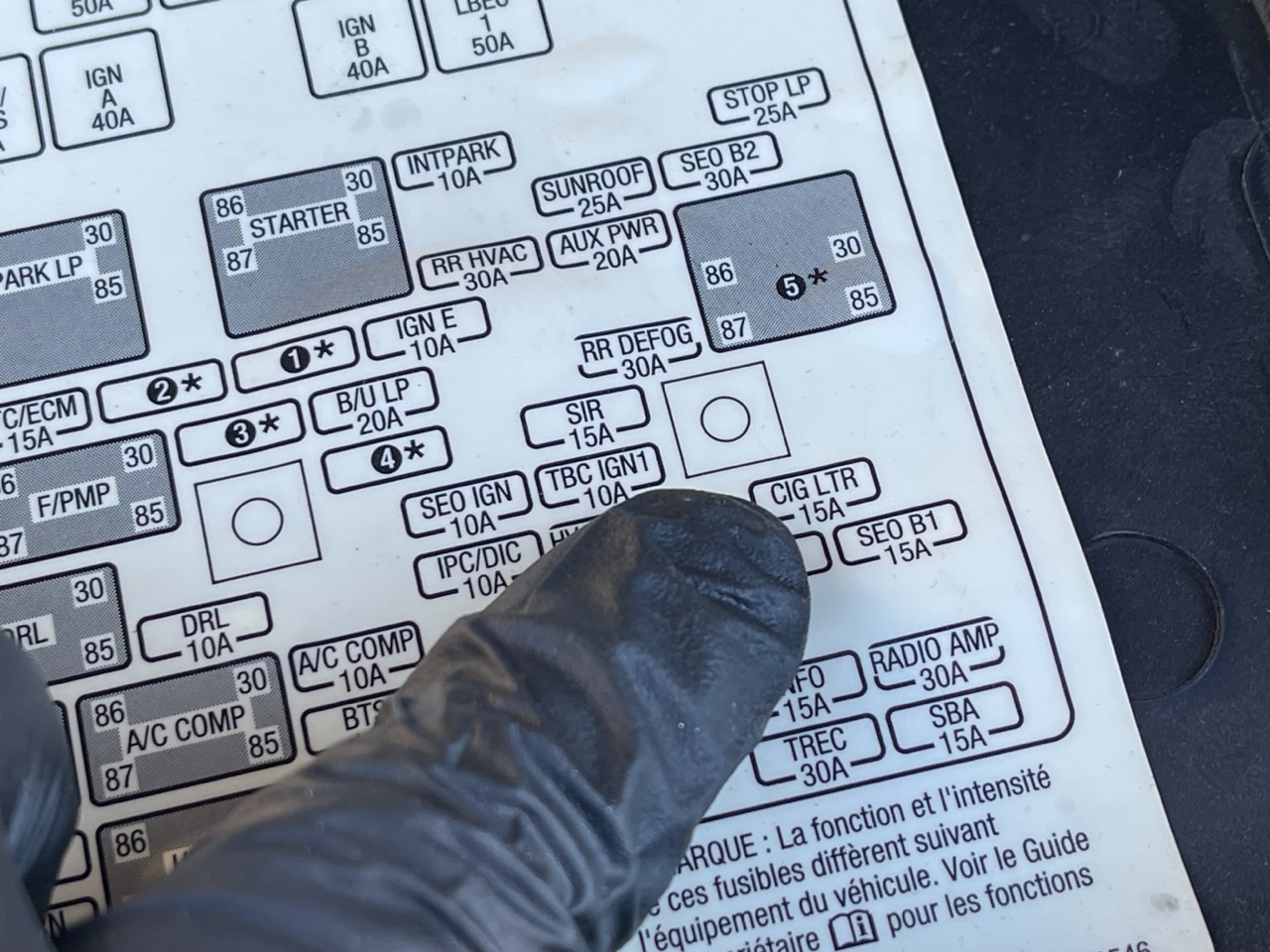

Also, for the OBD not reading - it's a shared fuse with one of the interior 12v outlets. Don't remember which one.... But sanity check those are good
@smoore
Replace the 15amp fuse for the driver side cigarette lighter. Fuse is in with the others in the engine bay.
