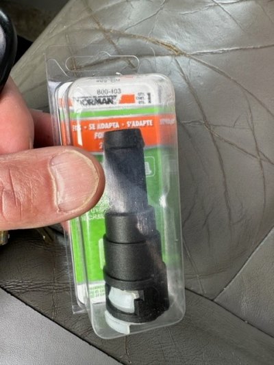

Last weekend, the connection piece that attaches the hose to the heater core broke. I picked up a new connecter but it was difficult to remove, and now the new one will not seem to attach to the heater core any suggestions from prior experience
here is the amazon link that shows a photo of the connector that I cant get to snap in. The hose goes in fine, its the other end I cant get to snap in..

The connector that I bought matches the connector that broke exactly...

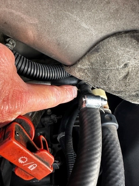

might help to post up some photos of the passenger side engine bay

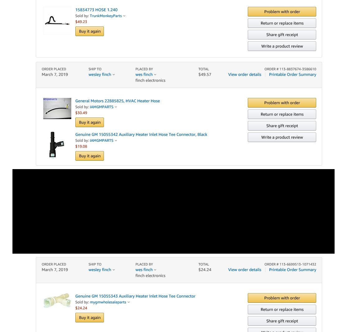

see photos below. The T part that some above are referring to attaches to the part I have
at minimum you need the black colored T (15055342) I already pictured with the part number. It's best to replace both T's and both hoses, because if that one broke the other won't be far behind and it could happen at a inconvenient time leaving you stranded. it only takes a minute or two for that broken line to spit out all the coolant
ok that makes sense thanks for the advice

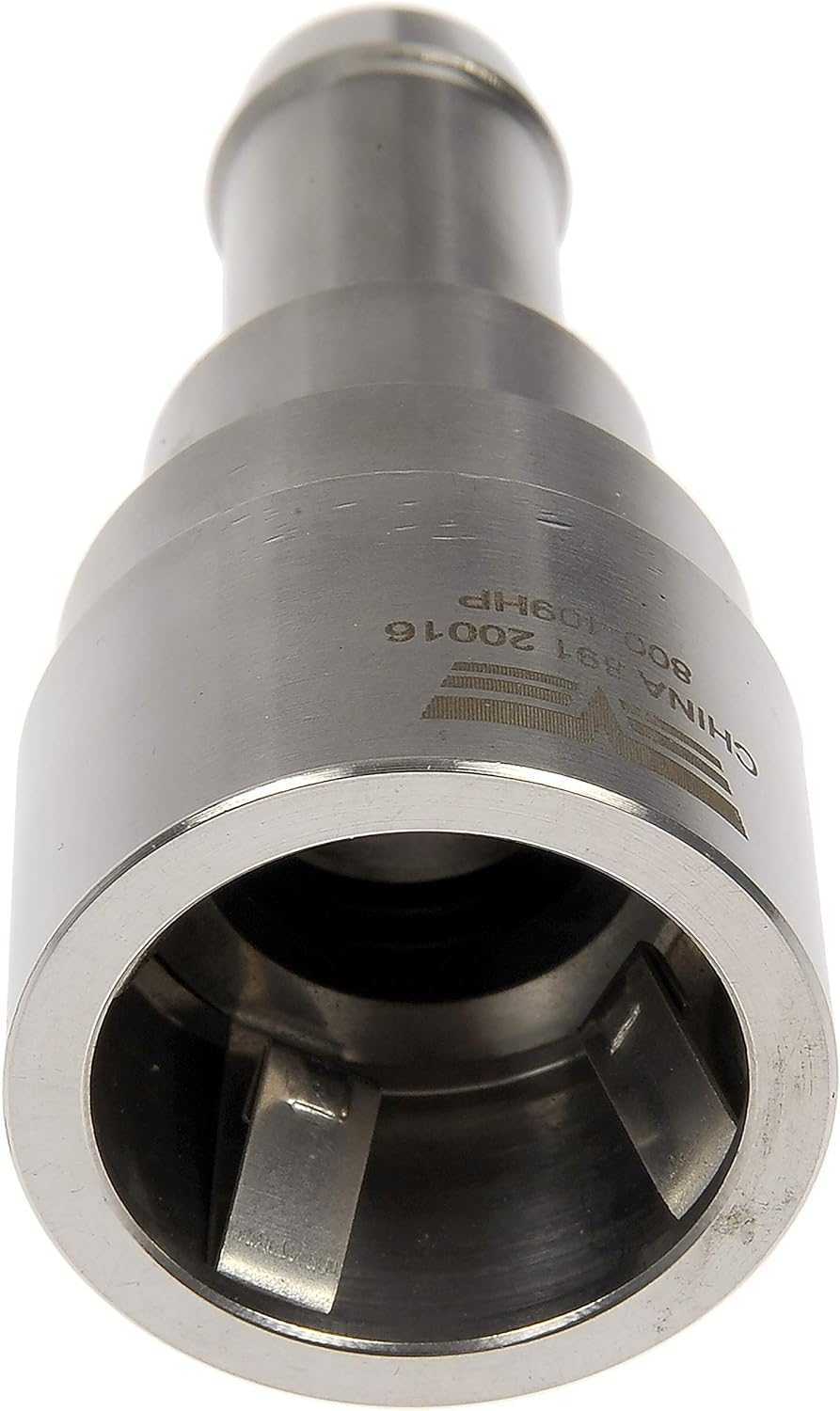

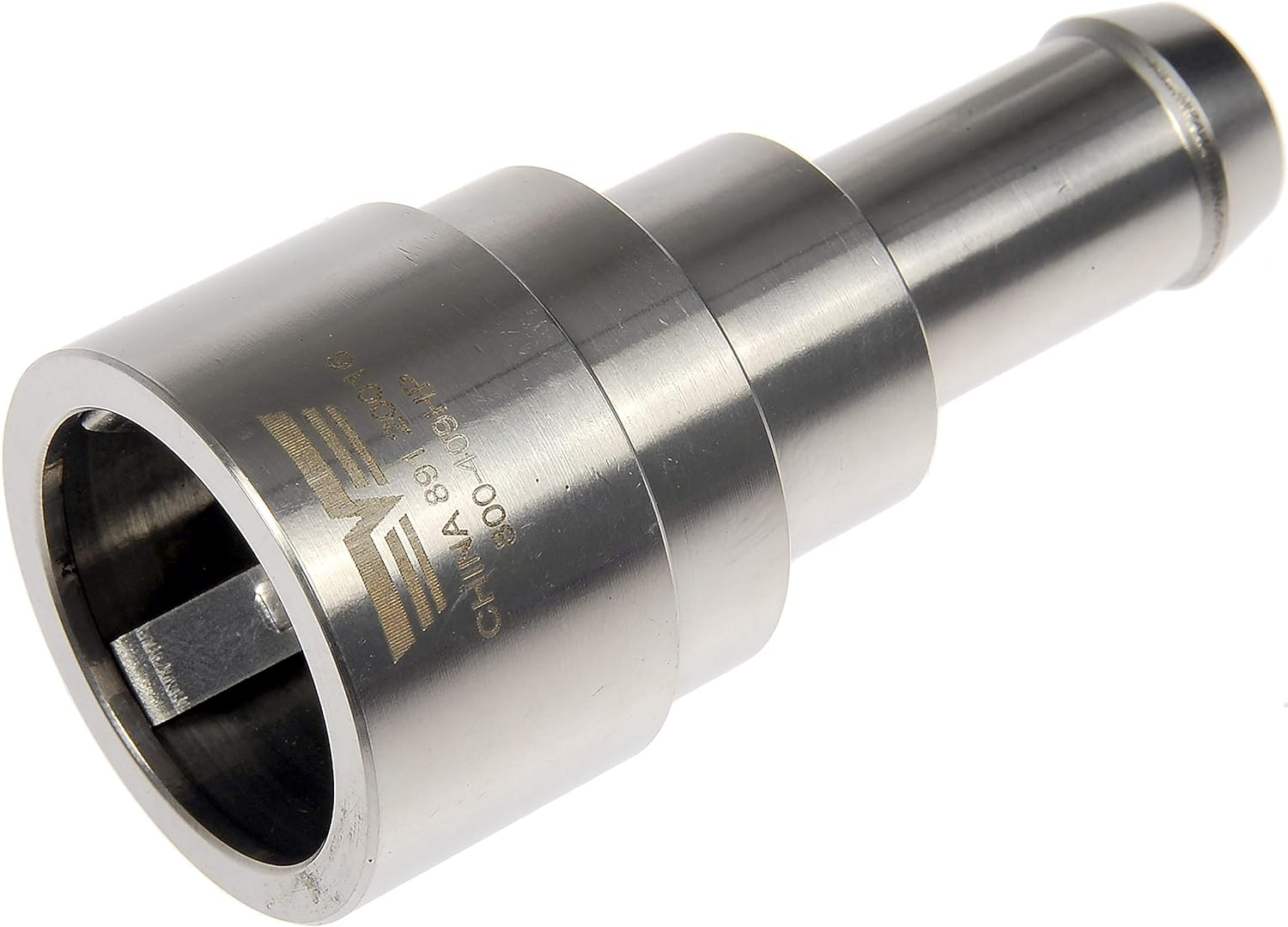

It already broke once. Here's the upgraded metal version that will save you a few bucks. This is what I bought for my 02 pickup. it SHOULD BE the same one. Dorman 800-409HP
I bought a fuel line disconnect kit off amazon. This thing was $8. I don't recall the size off hand, but it was in there.
Here's the amazon link for cheaper:
