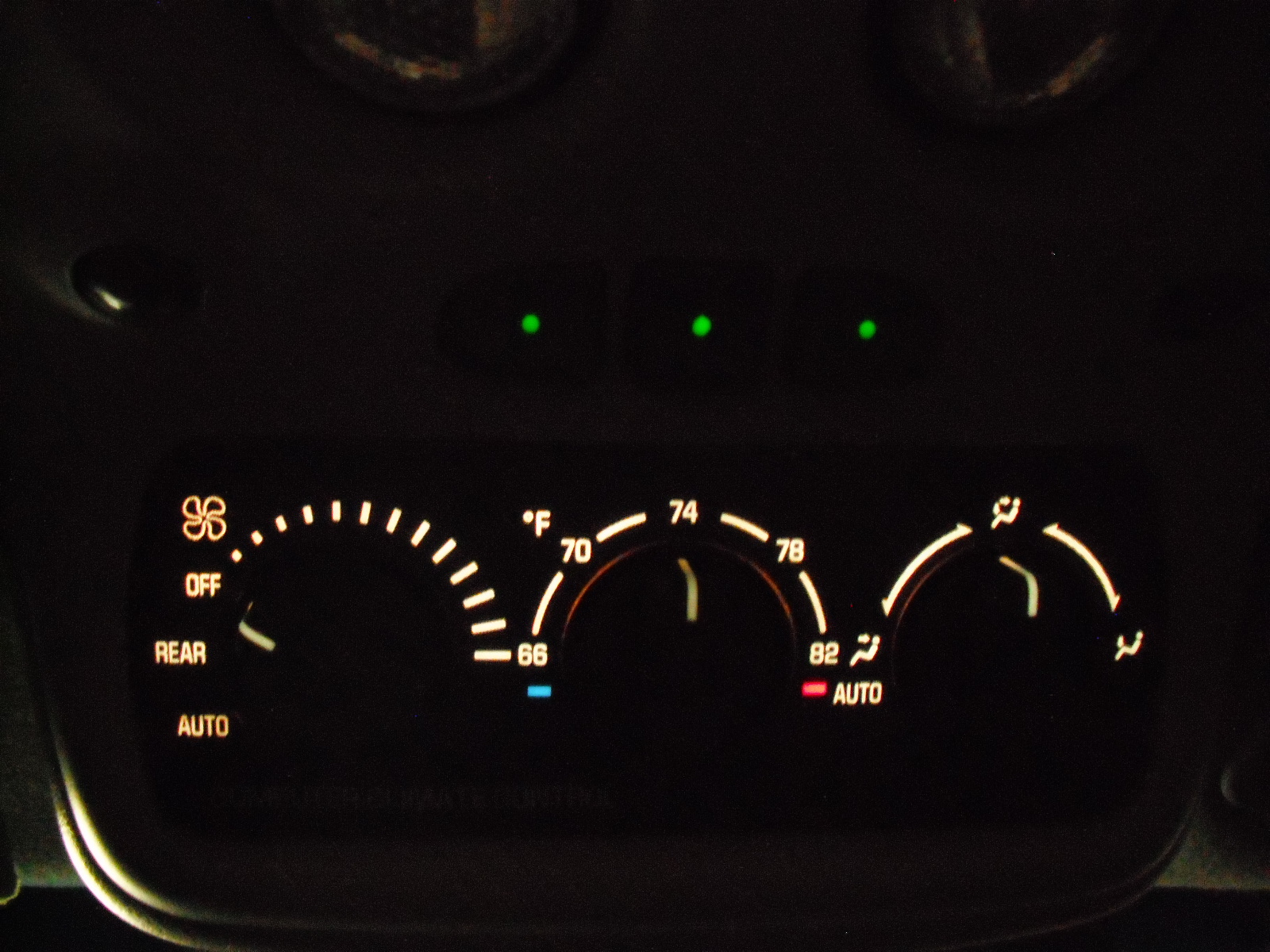

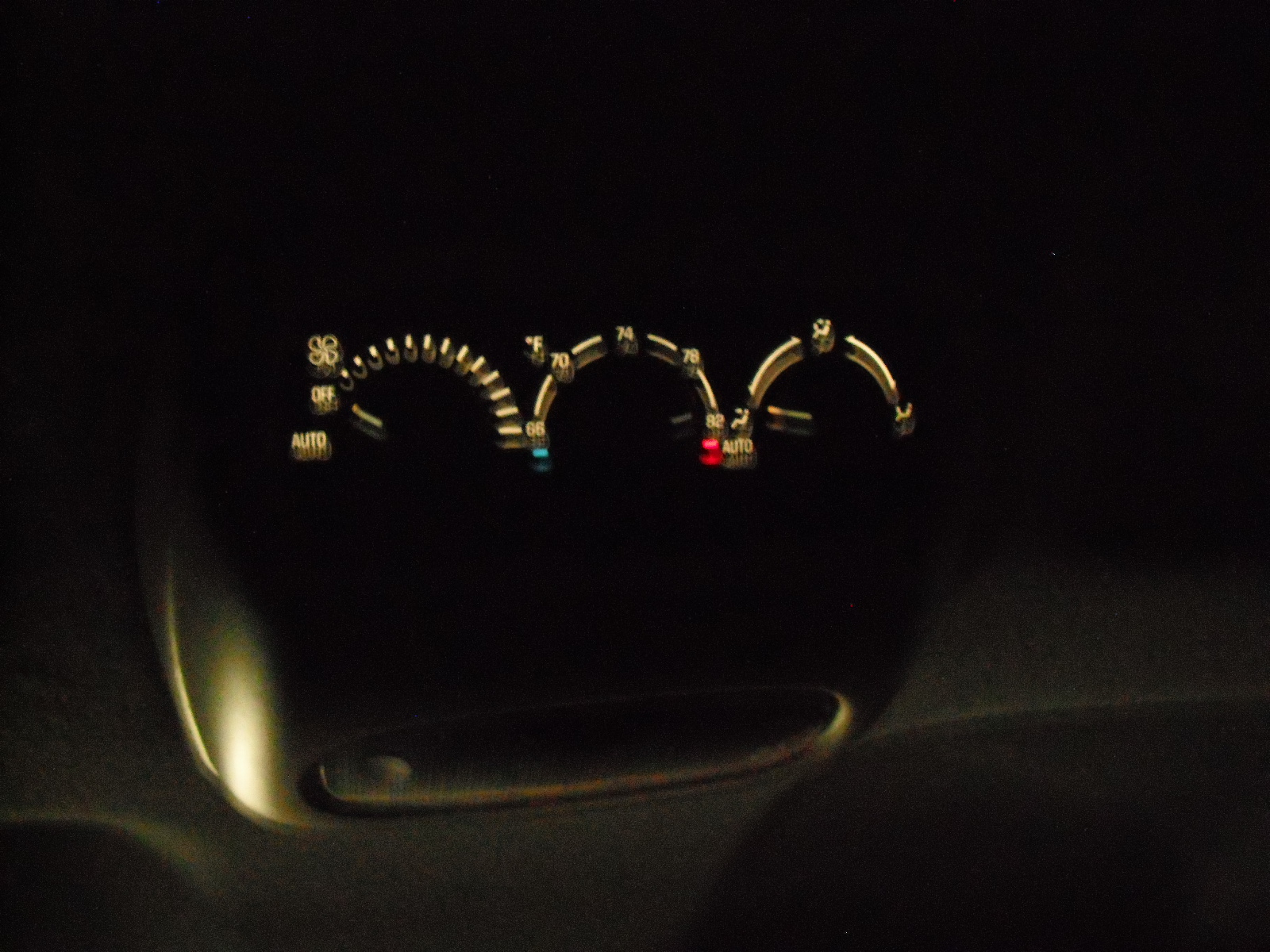

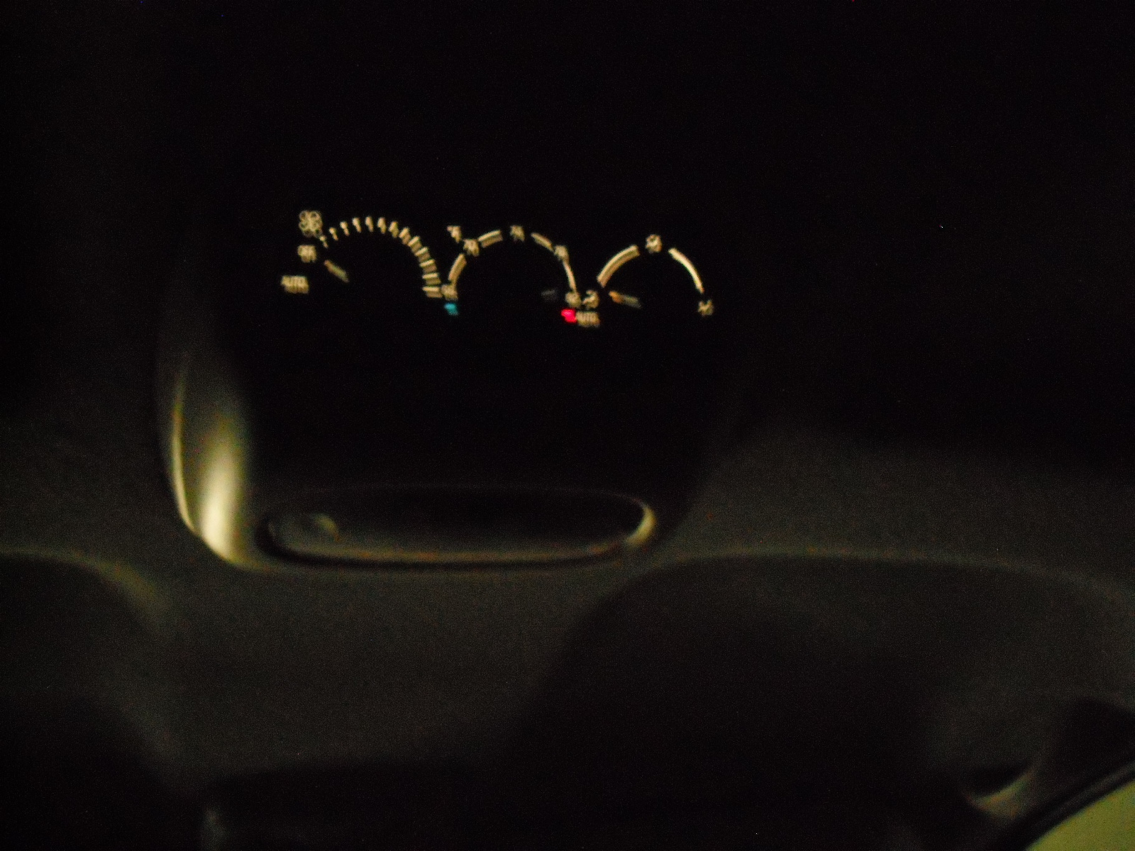

JonnyTahoe
Apr 14, 2011
1,249
779
Minneapolis
Mine are, it's the rear overhead that's not lite on mine wonder if that is supposed to be lite also ?
Those are my pics of all the overhead Controls front and back. When your truck was new they were all illuminated.
DougAMiller
Mar 10, 2016
494
808
Colorado
There are 4 bulbs. They are soldered to the circuit board, so you need soldering skills to replace them. It's not too hard. White 12V LEDs can be soldered in place of the incandescent bulbs and should last forever. The problem with the original bulbs is that after a few years the filament becomes pretty delicate and just the jostling of removing the housing can break them on several other bulbs. So if just replacing burned out bulbs have a few spares because by the time you get it put back to together with the new bulb, you'll likely have another one or two out and have take it apart again (speaking from experience).
