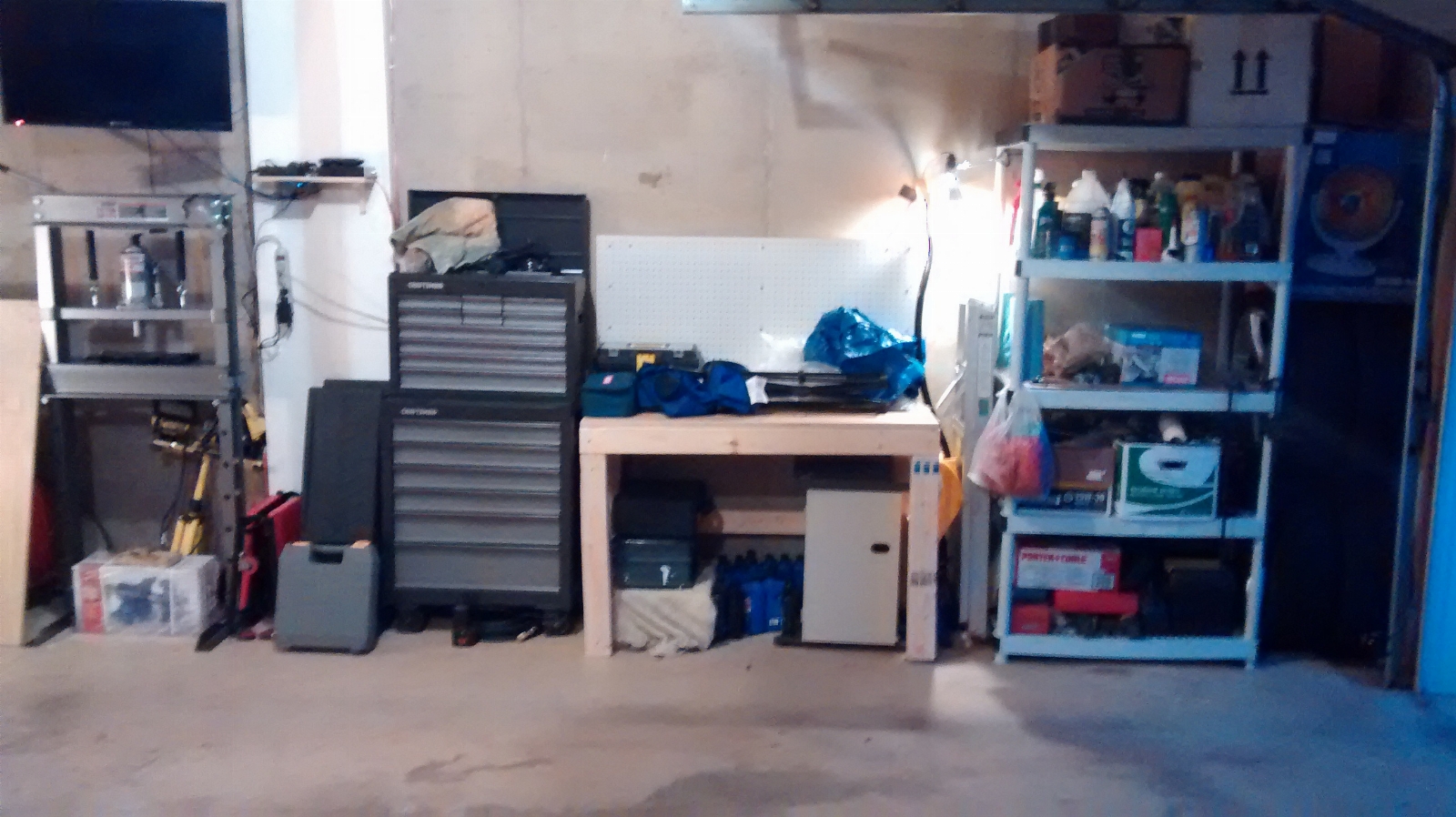

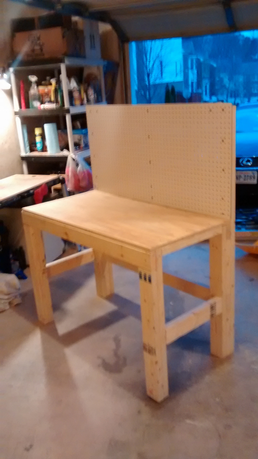

First, I needed a decent workbench in the garage so I build the first of two. 4ftx2ft and 32 inches high with a backboard to hold tools. This is my first wood working experience.
Side view:
In place:

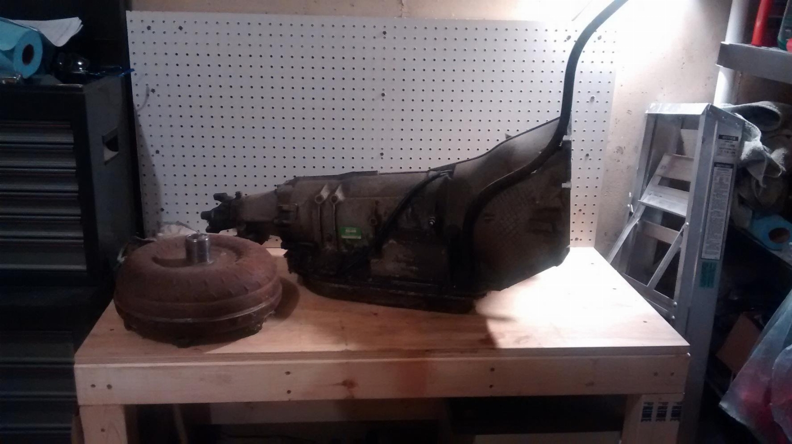

Soooo what should I test the stength of the bench with. 200+lbs should do. What about this?!

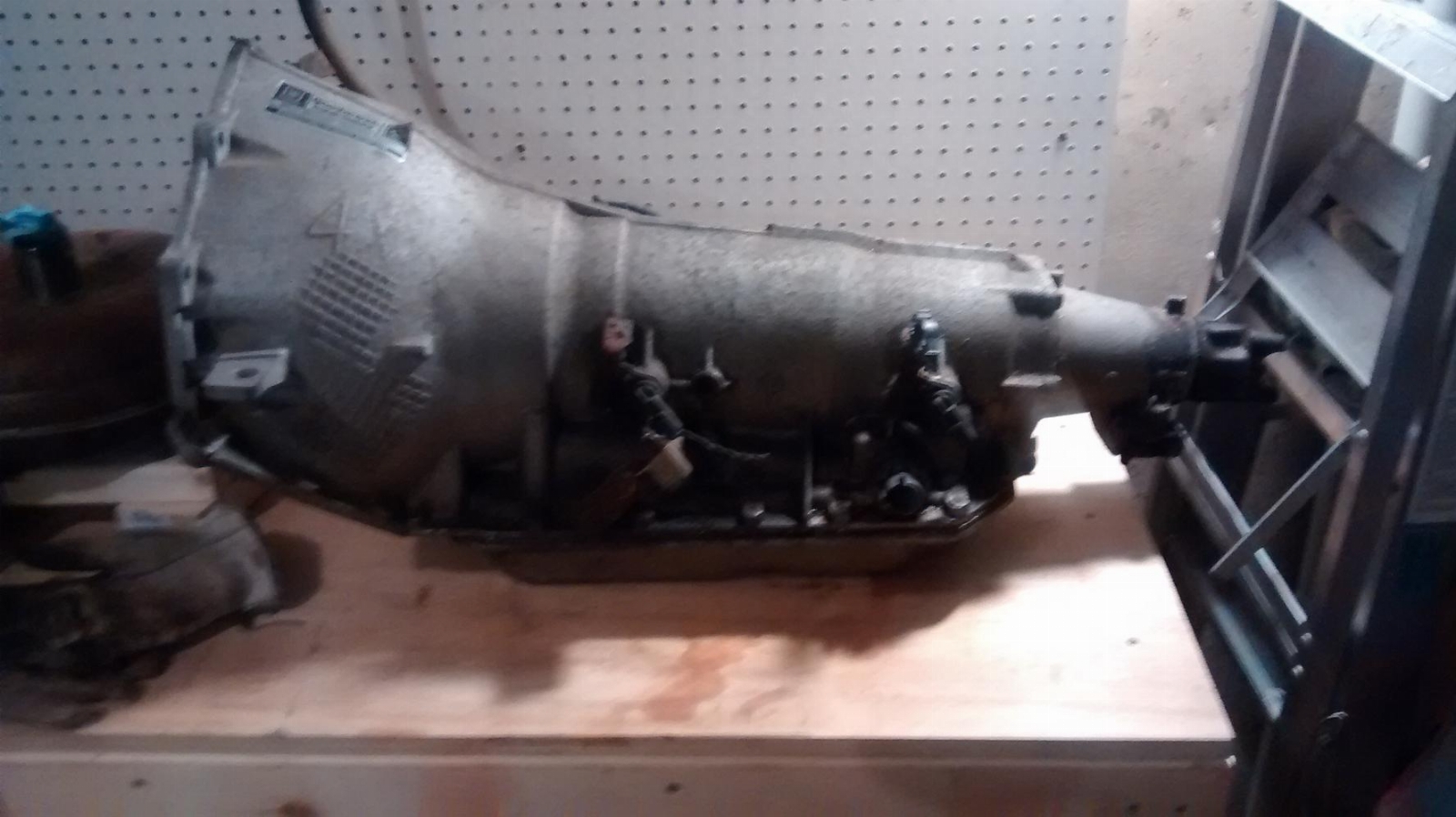

Oh gosh, whats that?!
4l80e baby!
Its pre-1997 2WD 4l80e GM Goodwrench reman with approx 20k miles, 30k miles in the very worst case. I got it from a cool dude named Jay 2 hrs north of me, north of Baltimore. He had some serious toys and got this trans with a 454. All he wanted was the engine since the trans was too big for his hotrod truck. He was out $400 on the deal with a friend and thats all he asked of me. How cool. He even left the original fluid in for me to verify its health with. Even if everything is toast I'm OK with a full rebuild since I need to tear it apart to replace the output shaft with a 4x4 one.
Jay if you read this thanks so much for making my XMAS!

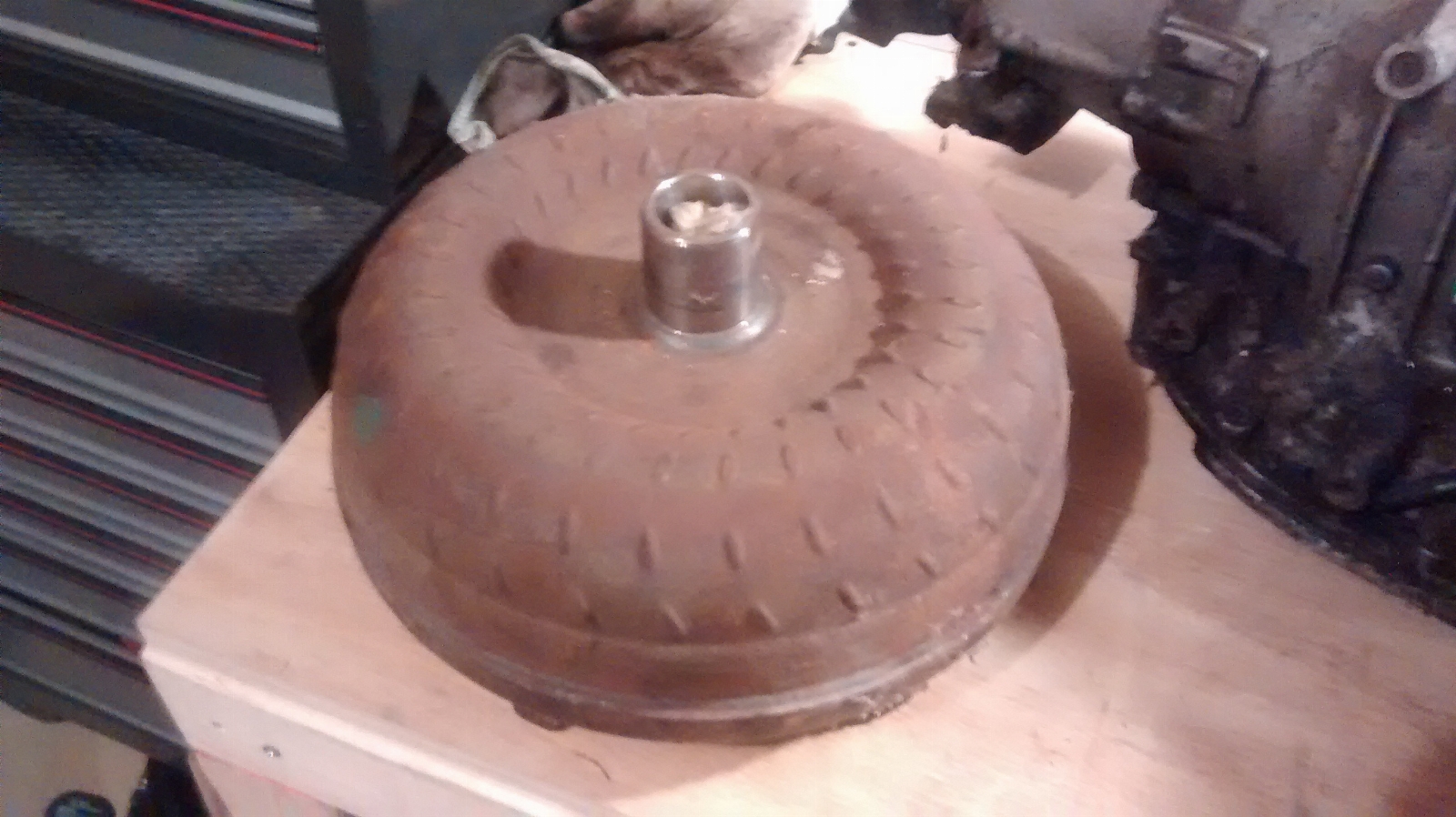

I also need to find a new torque converter since I think the one that came with the 454 stalls too low of RPM for my 5.3. No biggie I have all winter :)

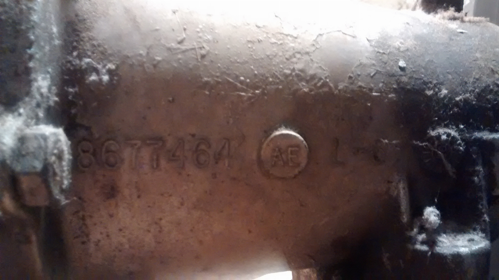

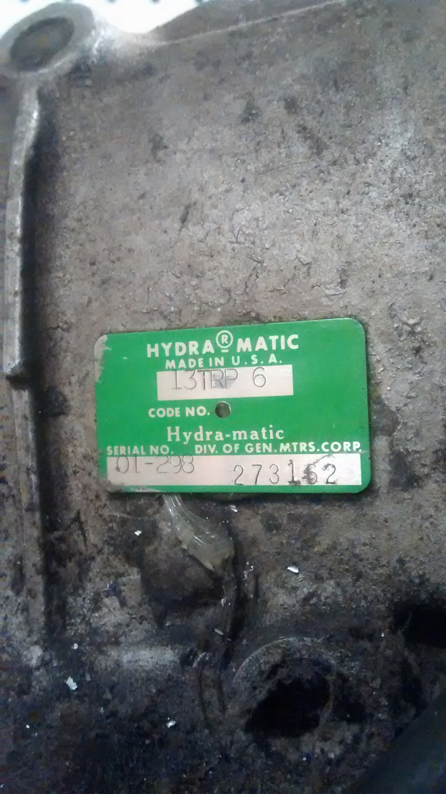

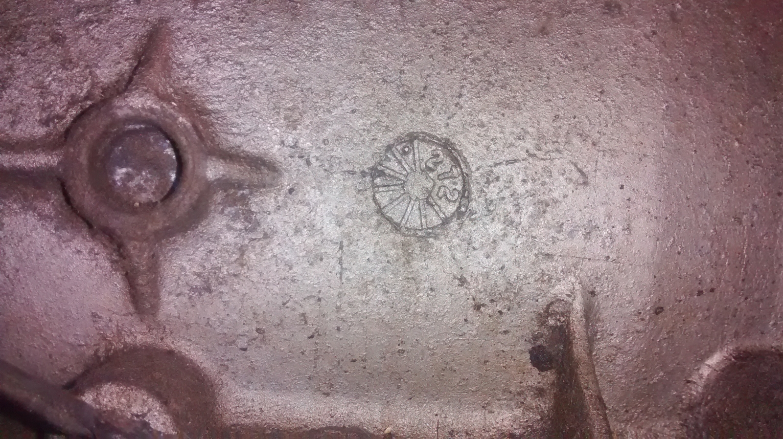

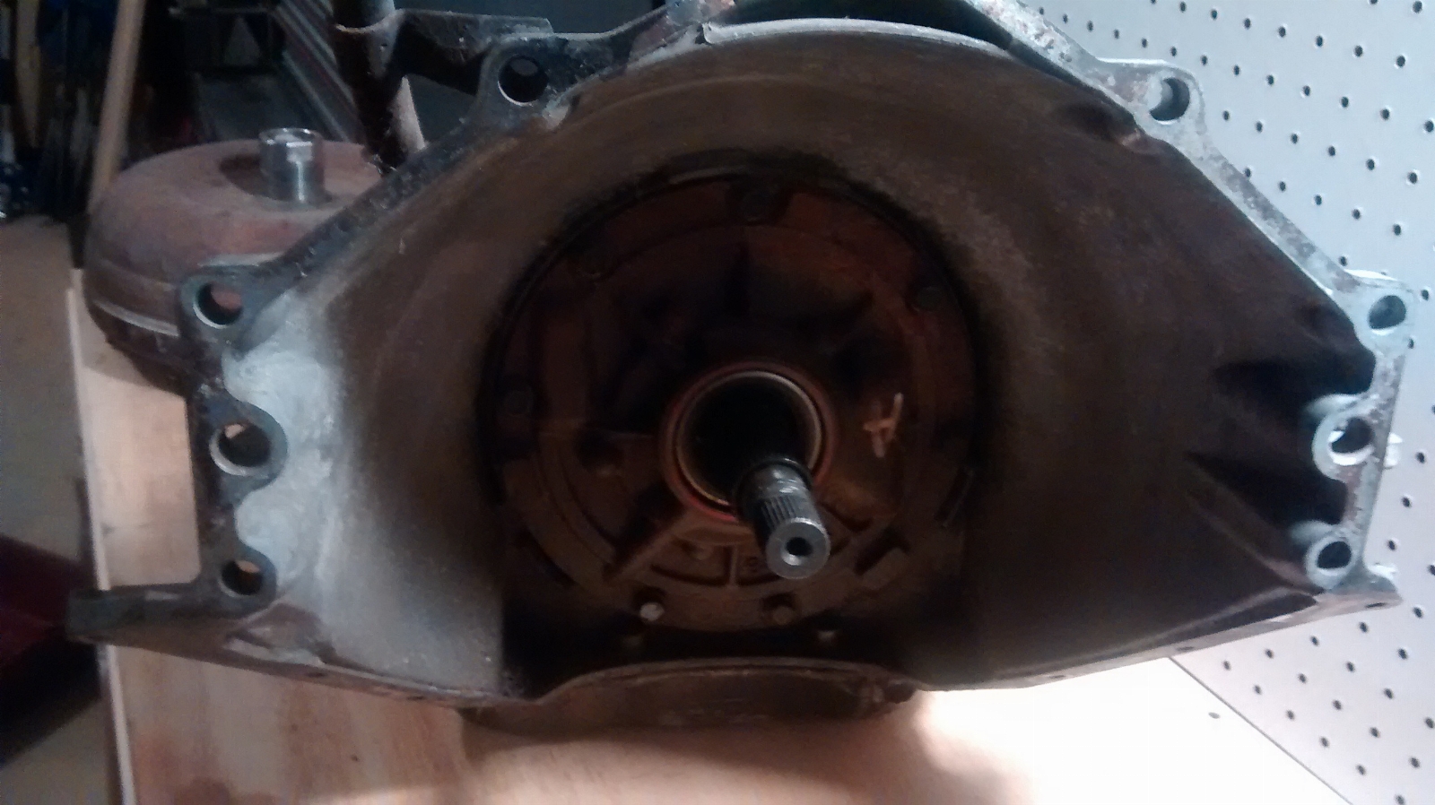

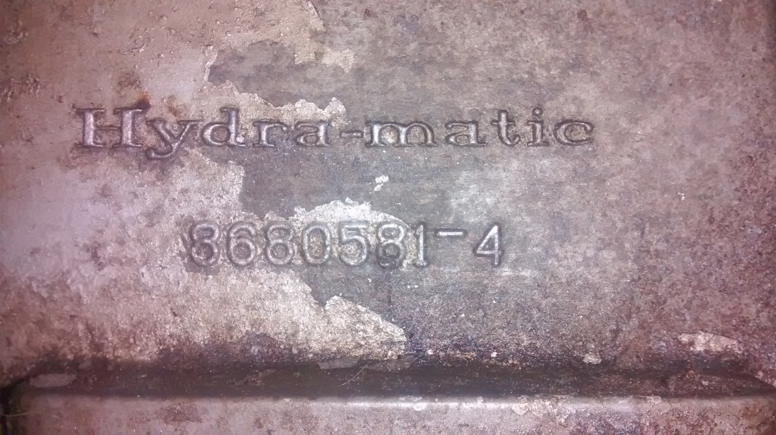

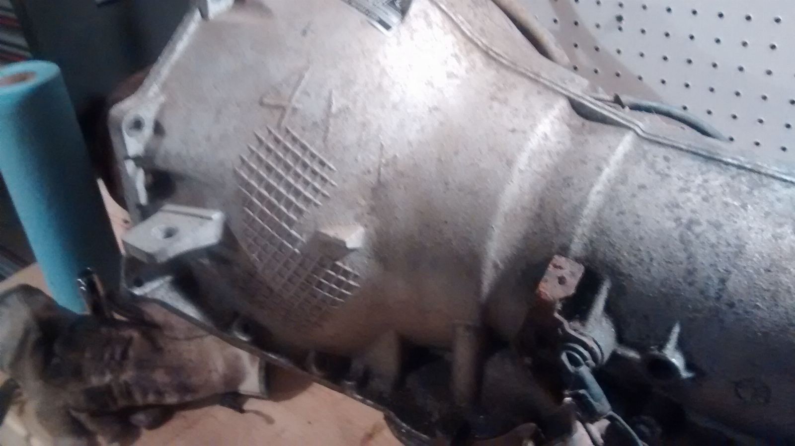

Now I need to identify exactly the year for potential rebuild kits. I see the coolant lines are next to eachother which means pre-1997. Tons of pics now. If anyone has any input let me know.
This has to be 60lbs:
Other side:
Pump:
Casting:
Reman Sticker, at least reman by a know company ;) :
Serial:
Housing:
Casting #s:
More casting #s:

Our stock flash stall is at about 2000 rpm I think. I'm not doing a large turbo so I'll be getting peak torque early on. I figure a 2500 rpm stall would match peak torque. Yeah more heat is created but from what I read our torque converters lock up at cruise past 45mph, so no hear issues with slipping. I'd be more worried if I had a high 3.5k ish rpm stall.
4l80e comes with 2 torque converters. 1800rpm ish and 2200 rof models b81 and b82 respectively. I can only find dodgy rebuilds with bad reviews for the b82.
Soooo for $400 I found this promising converter with a perfect stall. Low enough to allow for towing.

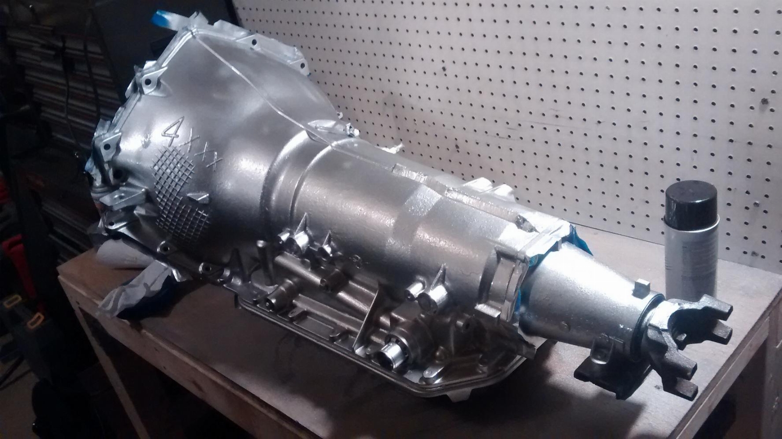

Many hours of cleaning and painting later.
