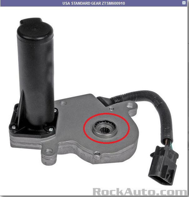

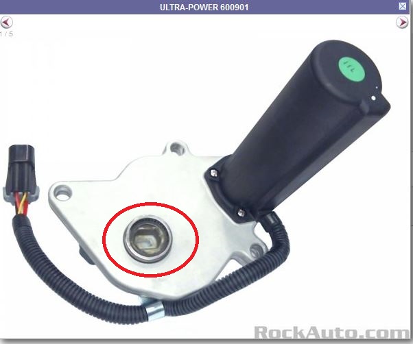

If you do get to the point of changing the encoder motor on the transfer case, be sure to check which motor you need by removing the old one before ordering. Some mate with a splined shaft and others mate with a shaft with two flats. Yours is about the year that the transition was made.
Thanks i was confused why the same year had different parts
