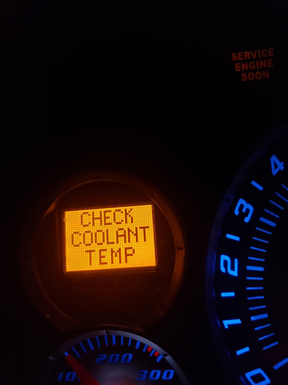

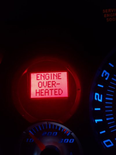

I got a 01 5.3 suburban 2wd that has no cats. In the message center I continue the get a messege of check coolant temperature/engine overheating. The temp gauge will bounce back and forth but the engine isn't hot nor the coolant. When this happens it runs horrible, no power, no speed and misfires. This started happening after I recieved a low engine power in the message center and determined it was the cats. So i went cat-less. I have no 02 sensors. Somedays I can drive it and its fine. No error codes. Then others when it runs bad I will get code P0117, P0157, P0300, P0420 and P0332. Even when I get the codes it's still not overheating. Just runs bad. Any help appreciated.

Thanks for the reply. I appreciate the help. I replaced the temp sensor and thermostat. I was also able to remove the coolant reservoir cap coolant wasn't bubbling. Engine was quiet and not knocking
