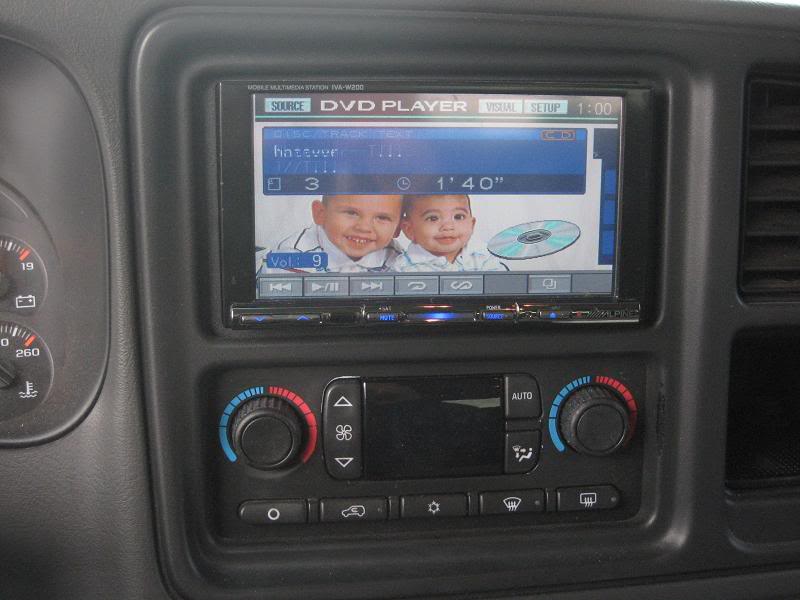

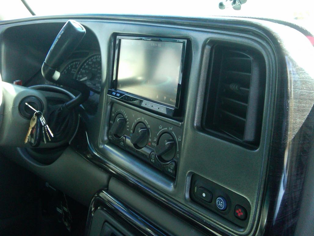

Finished this up a couple weeks ago, Finally got around to taking pics. Lemme know what you think.

Haha thanks guys. I actually think my camera just sucks, hence the blurriness. But I got the bezel and cage out of an '03 yukon. Made my own bracket for the HVAC controls, then used shipping foam to build up behind there so they would sit flush. I didnt trim the bezel, I took off the little flip open door that covers the cigarette lighters. I always have my phone charger plugged in, so it was always flipped up anyways, figured i might as well just take it off.
Im starting to think that they didnt make a light gray dash bezel in the 03+ years....

wow good to see a double din will fit in a 2000 yukon. looks good man. real clean and flush.

Yeah man Avic D3 is where it's at. I have definitely noticed that the Navigation part of it takes some getting used to, but it really does work well once you get the hang out it. Very nice work on the install though, I thought it was bad enough fitting all the wires in behind on my 04. Can't imagine with the smaller room to work with that the 02 and older has. I'm slightly confused as to the point of Anthony's post? But it does look good...

Haha I think Anthony and Daking are missing the point, Of course your double dins look clean in your 03+ trucks considering they come stock with a double din radio set-up. 00-02 take a lot of time, work, and effort to get it in there. You dont need a dash kit to put a double din in though, I didnt use one. It will end up just being a trim piece if there is extra room on any side of the radio. But yeah thanks for the compliments, took a while to get the parts and have it come together, very happy with it now. Next step is trimming the bottom of the bezel to not cover the cig lighter cover and ash tray

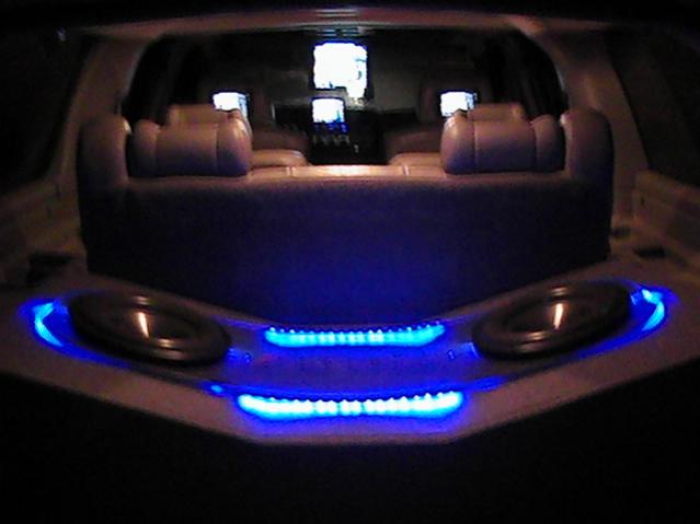

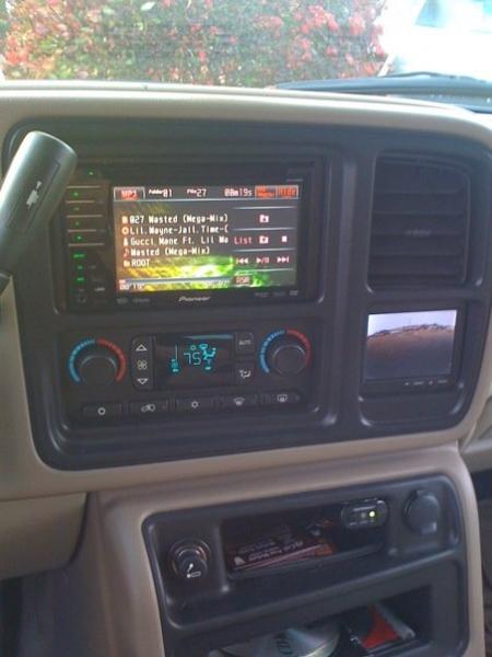

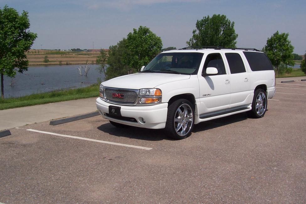

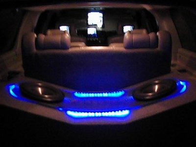

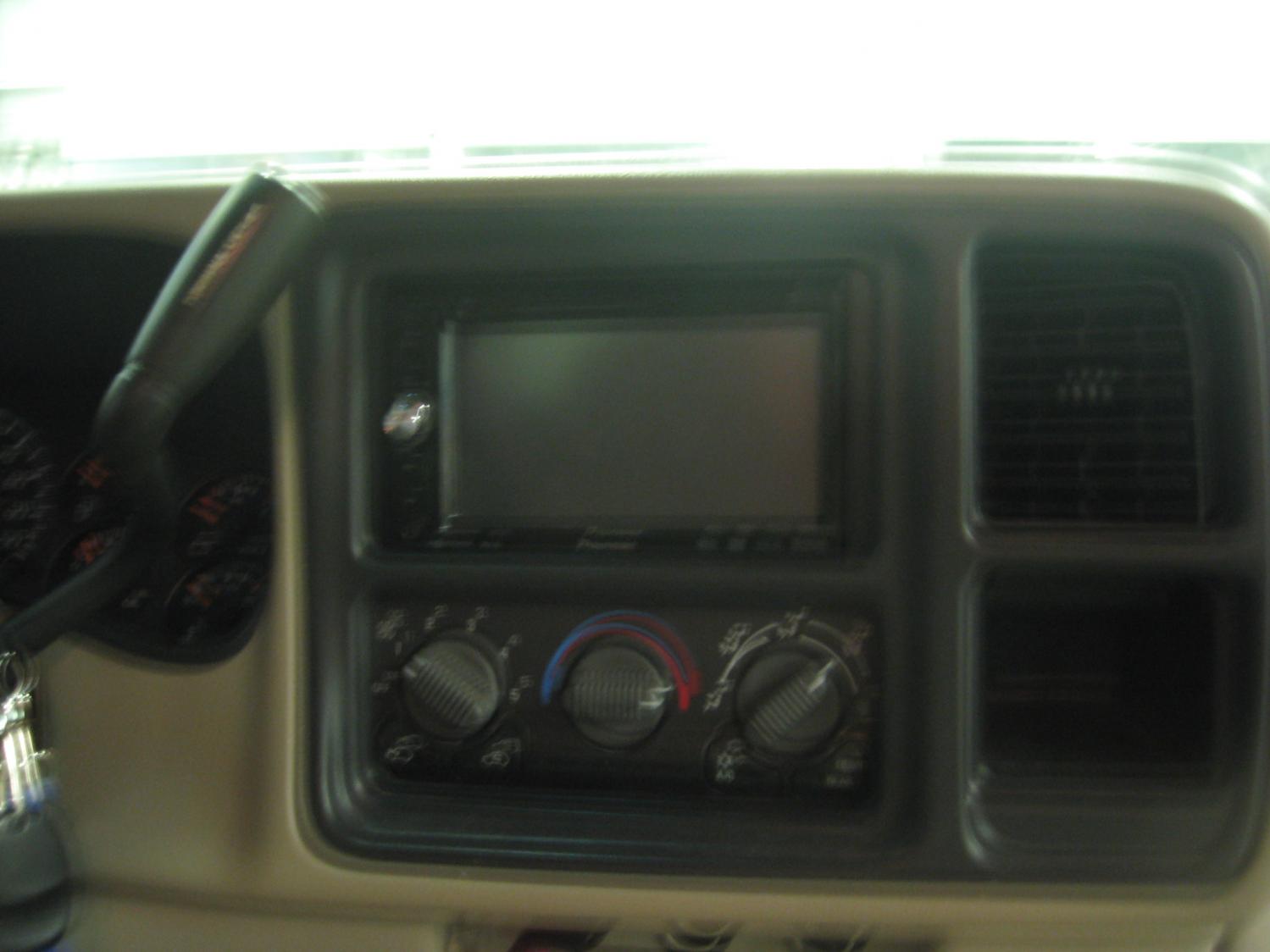

Mine is a 2002 yukon denali and the dash is a little differant. It came with a din 1/2. thats what this is all about. I put a double Din In mine too. after doing a lot of cutting and triming the bezel was not too bad but I did a little fit, trim and a lil bondo and paint. I think turned out pretty nice.
