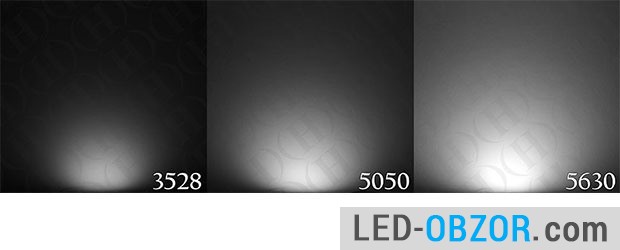

It depends on the diode. Some have 5630, some 5050 chipsets, also there's smd, cob, cree. On course the circuits support each designated chip style. Most common you'll see are 5050 smd

It depends on the diode. Some have 5630, some 5050 chipsets, also there's smd, cob, cree. On course the circuits support each designated chip style. Most common you'll see are 5050 smdView attachment 199532

A 5050 is about 3 times brighter than a 3528. A 2835 is about 4.6 times brighter than a 3528. Just for lumen output comparisons.

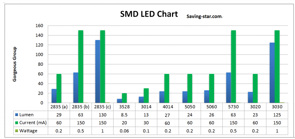

Back to research, found this chart and a website that explains what the numbers mean. Cool to know that those numbers are the physical size of the LED in mm. I have 3030s in the front and they are super bright. The new ones in the back are 2835s but I’d guess they are the (b) version cause they aren’t as bright as the 3030s.
Don't forget there's the number of each LED in the light, so the lumen output is the total of all of them as well as wattage. The Endpage show 4.4 watts on bright output so if you take the (21) 2835 LED's and look at the chart, the 2835a shows .2 watts which works out. 21 x .2 = 4.4. So in that case the lumens would be 21 x 29 = 609. I want to see what 21 of the 2835c's would look like at 2,730 lumens. Too bad it would melt fuses at 27 watts per bulb.
Sounds like the Endpage ones will not as bright as what I have now, but I feel like I am missing something. The ones I have installed right now claim to be 33 SMD pieces 0.5W AX-2835. So that’s 2,079 lumens, 16.5 watts, at 12v that’s just a little over 1.375A. Even the configuration you mentioned at 27watts would not melt wiring or fuses based off current draw, 27w/12v=2.25A. But like I said maybe I am missing something?
