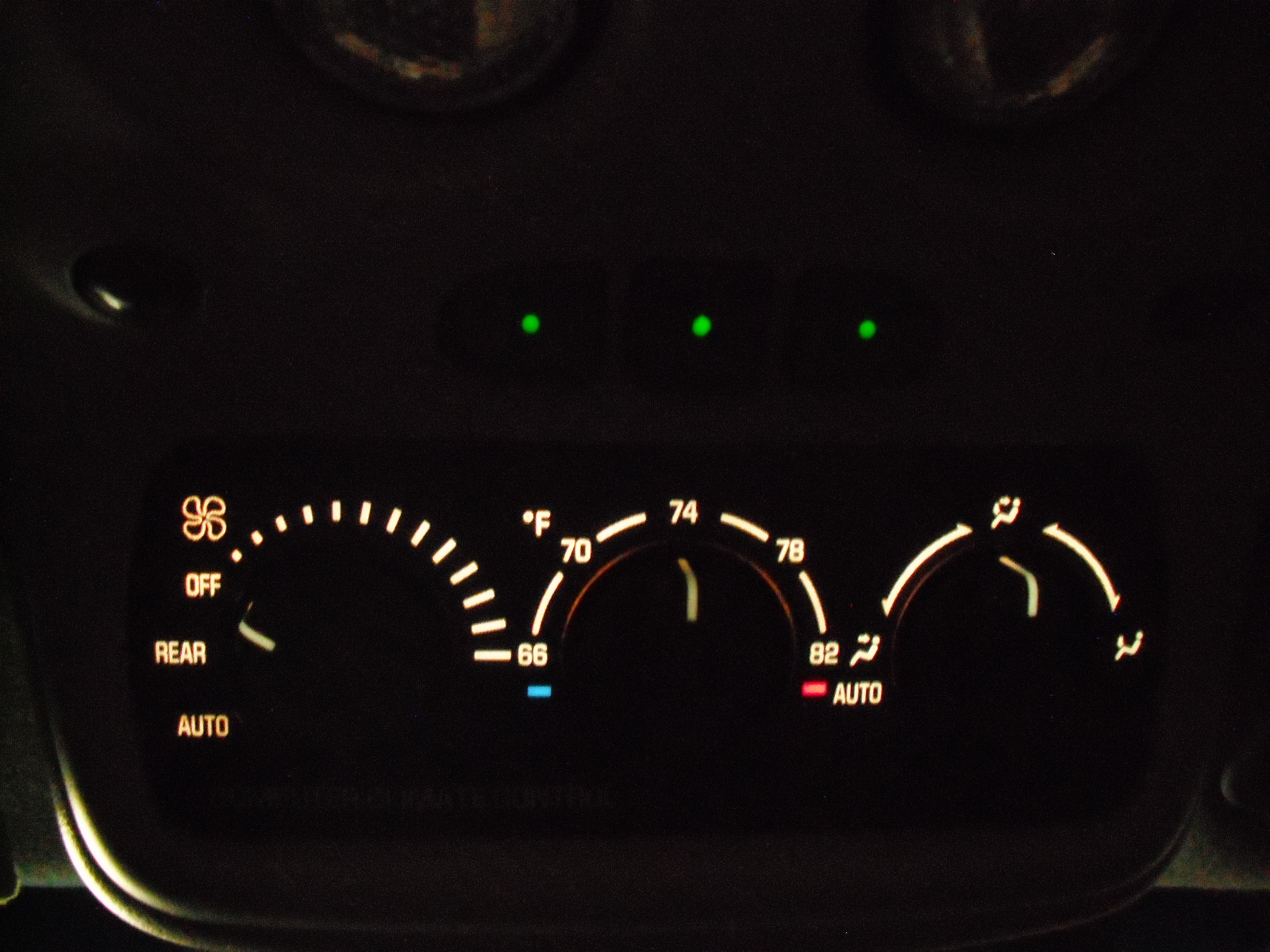

This is my 2000 Yukon Auto Climate Control Panel.

This is my 2000 Yukon Auto Climate Control Panel. View attachment 238460
Digital not available on early production 2000's. maybe not till 02. I have a Early production '00 Yukon with the Computer Climate Control also known as Auto Climate Control. This would of been an option in 2000 as my '00 Tahoe does not have it.
Yukon’s and Denali’s had the Computer Climate Control which isn’t digital.
