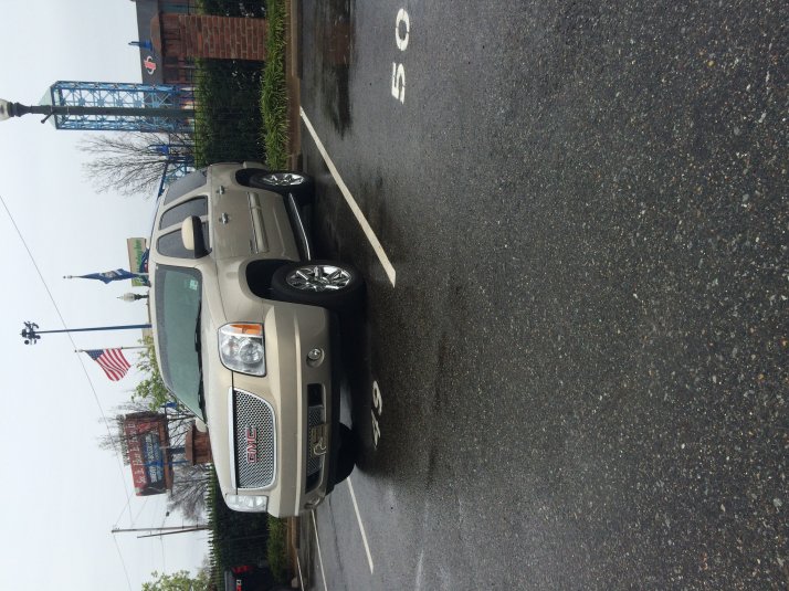

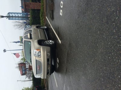

Here is a picture. Kind of a weird angle but I snapped it on the way into work. Picture doesn't do much justice to how it looks in person.
here is a picture..

Based on your comment "like a 250" sounds like it rides like a truck not the softly dampened Denali. So I am interpreting that on the road the small irregularities cause small up and down movements kind of like it is bucking (very small scale though).
Did you try the adjusting knob on the softest setting? Also check if it is the right part number? If those do not help, IMO the Rancho quicklift is too stiffly sprung and/or dampened to your liking. I would contact Rancho and see what the spring rate is and compare to stock.
