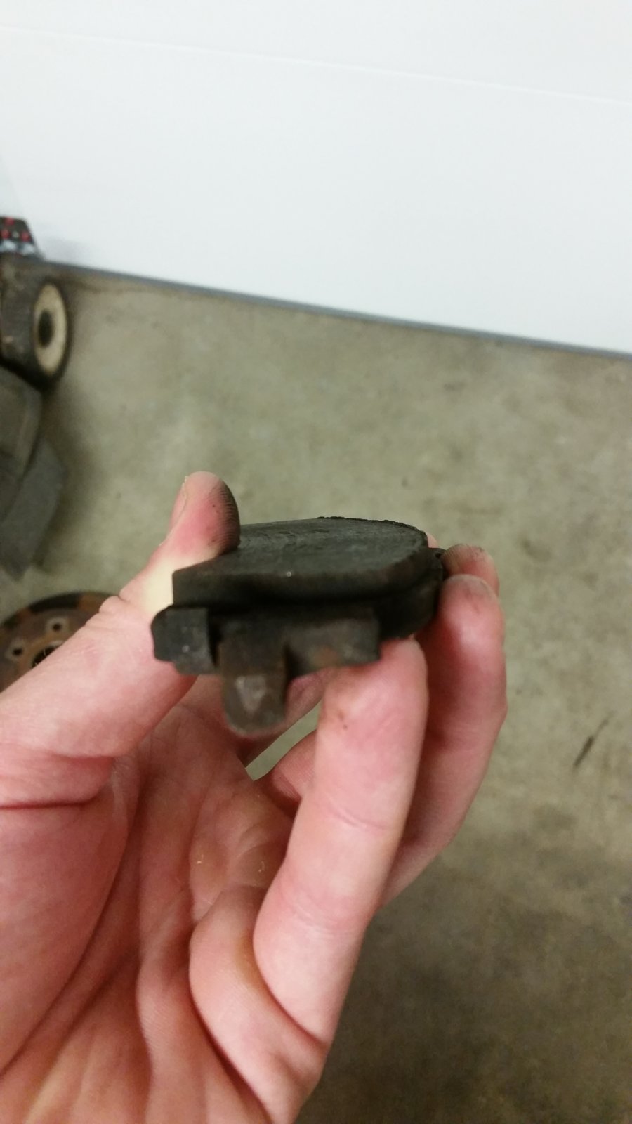

Notice the slight ridge on the top of the pad...that was because the pad wasn't making full contact with the smaller rotor.

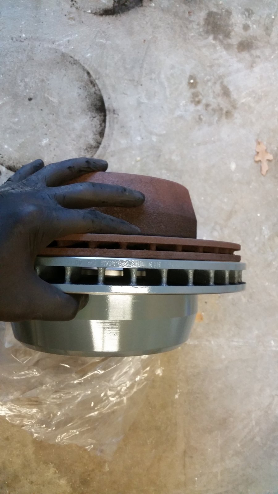

Big difference in width.
