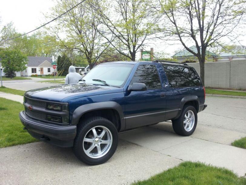

I am looking to do a 2-3 inch body lift. Just want a more aggressive stance nothing to crazy. My truck is on 20 inch rims now with low profile tires, i would like to keep the rims and get bigger tires. What will work best?? Do i go with a leveling kit? If so where from and what else would i need to do to the truck? Or please let me know the best way to go about it. Would appreciate any help thanks guys.

What size tires are you wanting? What is the offset and width of you wheels?

Avoid the leveling kits, it's not worth it. You can crank up the torsion bars a little and put a small block out back, that can get 1-2" right there. There is a great sticky in the tech section about cranking up torsion bars. Do you have a budget for this? That will help give us something to work around.

im looking to get 33" tires i think that is reasonable, my budget is going to be around $1000. tire size is 305/50/r20

Rough country 4" seems to be just a bit over your budget and would allow for 33's

yes
---------- Post added at 09:39 AM ---------- Previous post was at 09:30 AM ----------
4" lift kit (4-Door Tahoe, Yukon require crossmember drop kit part no 89501)
274S
$970.95
274N
$995.95
274P
$1,095.95
would that work on my truck even thoug it says 4 door??
