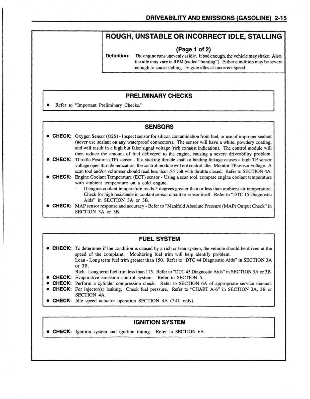

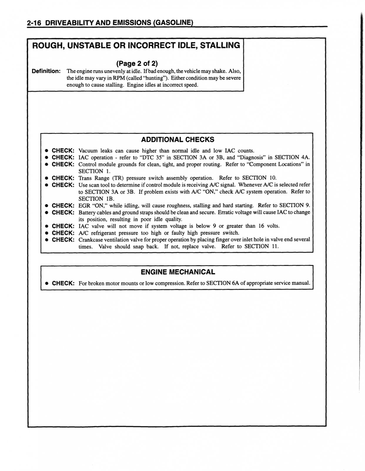

GM published diagnostic procedures in the manual. The link is in post #6, but here is an example from the 95 manual:
