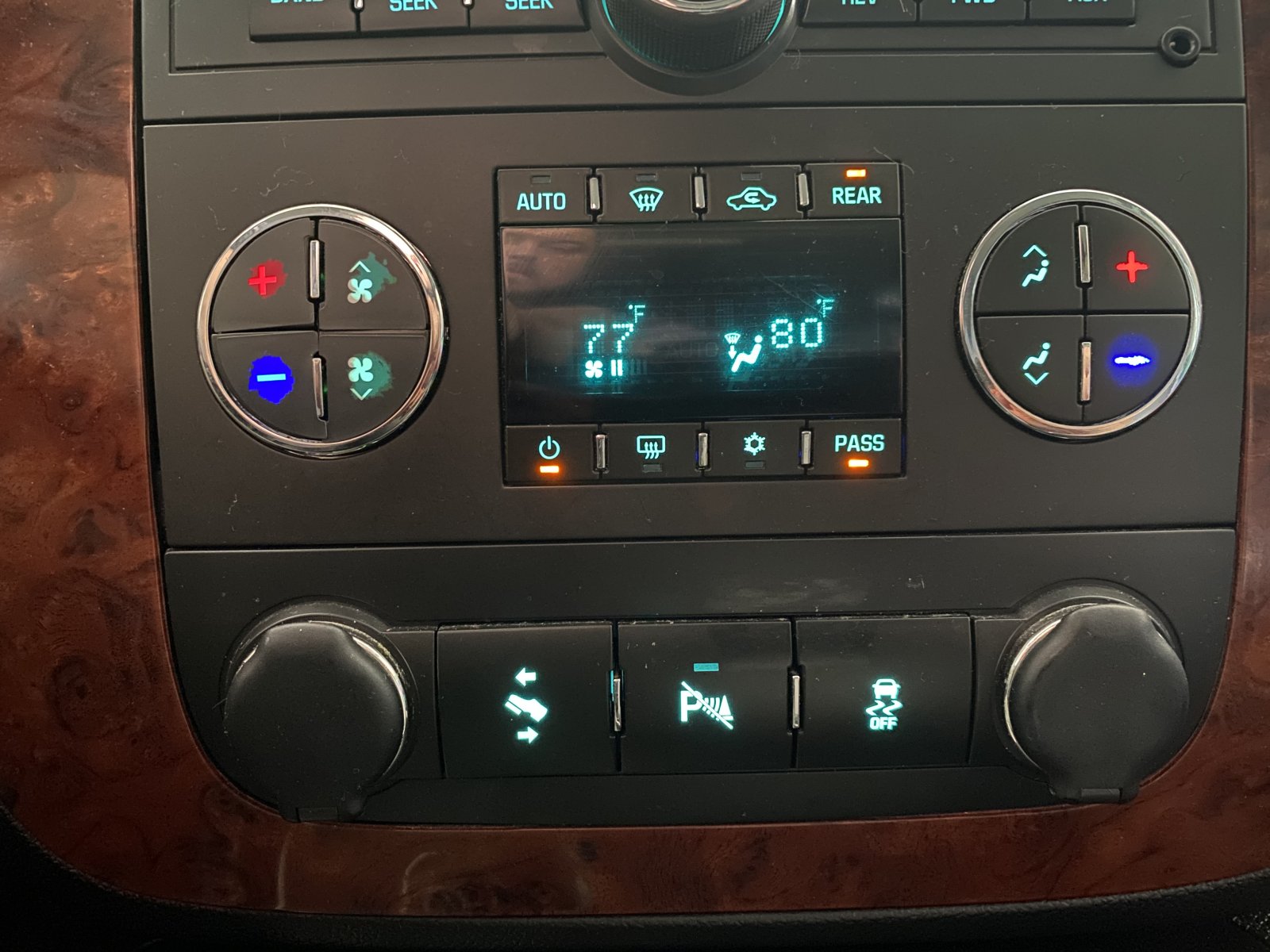

Hey all!! I just bought a 13 Tahoe from a dealer. Just come to find out the rear climate control is not working. No air from the vents. Front works fine, both AC and heat. Trying to figure out where to start looking or take back to dealer to fix. Wanted to see if it was something easy, like a button I didn’t push or something since I’m still getting used to the vehicle.
Appreciate any help.

You have the aux button on your climate control pressed?
pretty sure I do. When I turn it off and mess with the controls in the back nothing happens. The rear seats are heated and those buttons work. Just not hearing anything engaging for air or even trying too.
